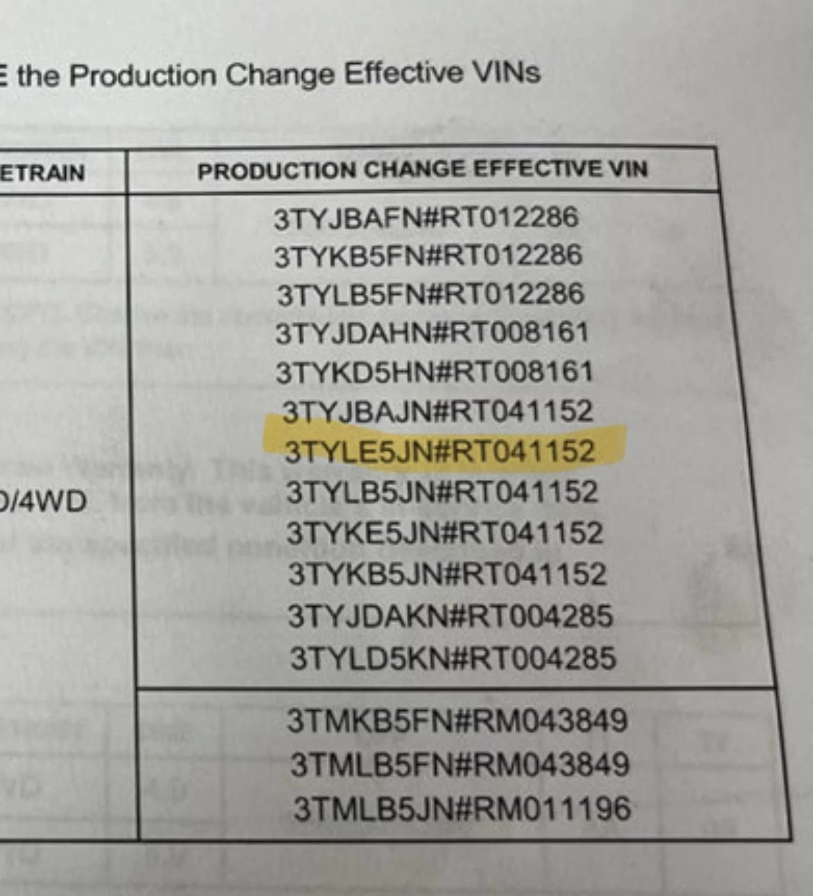

Hi. Brand new here, and I just purchased yesterday a 2024 Tacoma 4x4 Sport , and I am indeed in the VIN range (3TYLB5JN ... ... 34815). Mine has a 6 foot bed, which I think is a little more rare.
So, I'm trying to enjoy my new purchase with the new-truck smell, but then I see this transmission TSB. Ugg. I'm trying to not overreact. Could anyone put a reasonable probability that any one Tacoma (in this VIN range) will have the problem?
Are we talking about a very low probability?

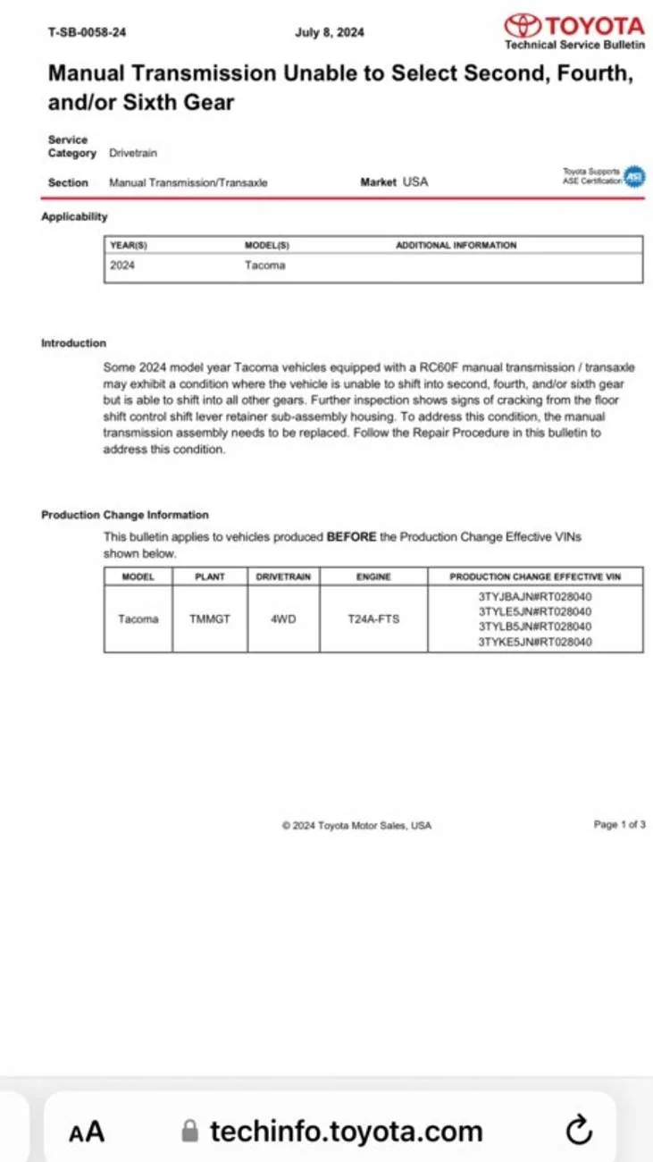

Bro how does posting a picture of the other TSB have anything to do with the one in this thread? There are clearly manual transmission VINs on it and either that’s wrong (unlikely) or the description is a typo (likely). We’ve seen a few MTs on here fail and they’re definitely related to this TSB. You’re not out of the woods but keep thinking that…

Don’t be that dramatic dude, it’s still highly unlikely to have a bad trans. On top of that the Manuel transmissions has their own tsb from Toyota which requires replacing the entire trans
What's messing up within the transmission that both a manual transmission and automatic transmission is causing failure? Either way I've pounded the hell out of my MT with 23,000kms on her, I have a feeling im in the safe. I was never worried and wasn't being "dramatic" ? I was just rilling all ya'll up.
