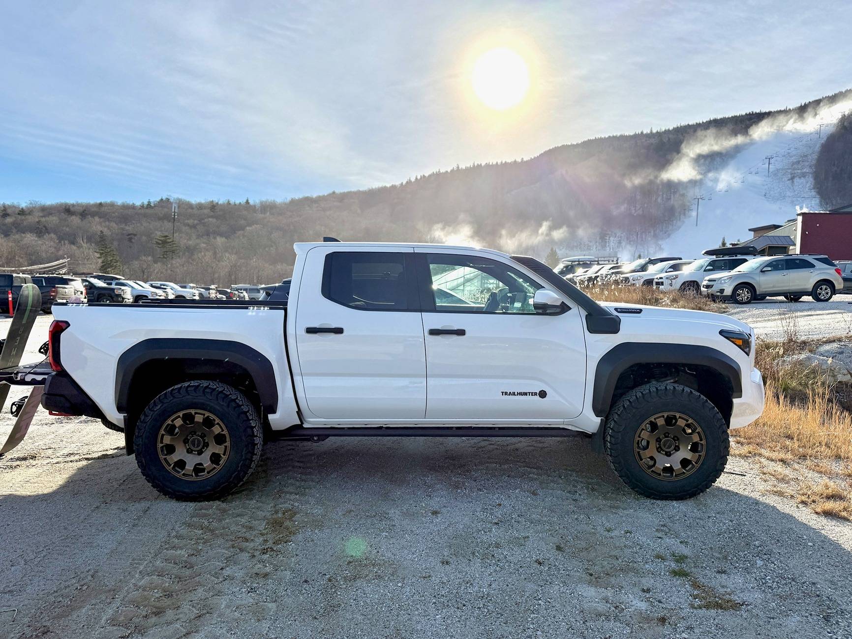

First day on the KO3's (275/70/18). Will post more pics and a better review later. So far, so good. Much different look from stock now.
I think I need to air down a bit, the shop set them at 43 psi... Ride might be a bit smoother at 39 or so.
Do you notice any significant changes with the handling going from 40 pound tires to 60? Any regrets? This is my preferred tires as well but worried bout MPG
No significant changes in handling that I've noticed yet, though I haven't driven that much on them. The ride is slightly bumpier at certain speeds, but I think the PSI is too high. Gonna drop it to 39 and see if that makes a difference. It is a big jump in weight from the stock wranglers, but so far surprised at how good they ride.
I went to E load 275/70/18 Falkens. I was shocked at how little it impacted performance and noise, but also shocked as to how bumpy they are. Small bumps are felt and big hits hit way harder. I went from 38 at the shop down to 31. 31 is super comfy but I’m not sure it’s a safe pressure for an E load—and it may wear unevenly that low. Will find something in between. Curious to hear folks’ PSI on Load Range E.
E Load totally unnecessary but options are sparse for lower loads in this size. Will say they ā€œfeelā€ bulletproof and the truck feels more like a truck and more sturdy / planted.
43 is way too high. The technical load equivalent is 38 for our trucks from OEM to LT275/70/18. I would not go up a single PSI over 38.
That tire size looks perfect! It’s the Goldilocks tire for the Trailhunter IMO. Not too big, not too small.
Can I assume zero rubbing with this size?

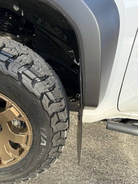

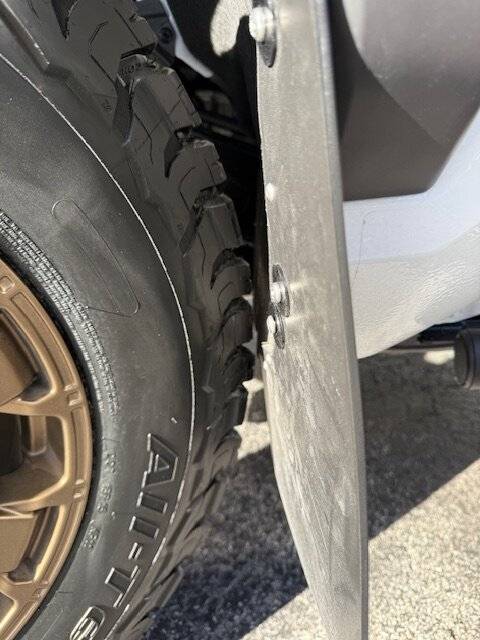

So far, zero rubbing. Full lock it's REAL close but there is some space. More than the image below illustrates, bad camera angle I think. Plus I have Rokblokz rally flaps which do take up a bit more space. I think a leveling lift for the front would buy even more space, if I can find one for a TH that is..
is...
