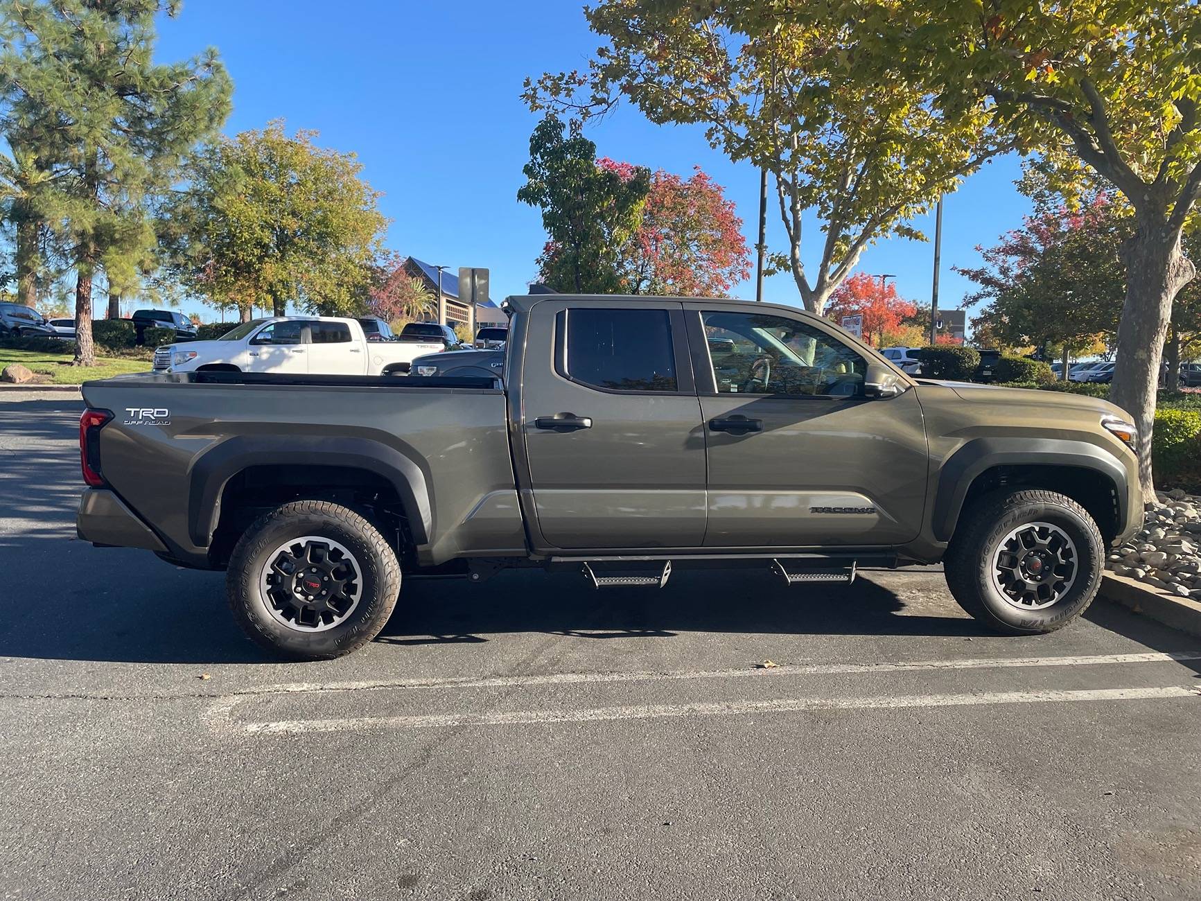

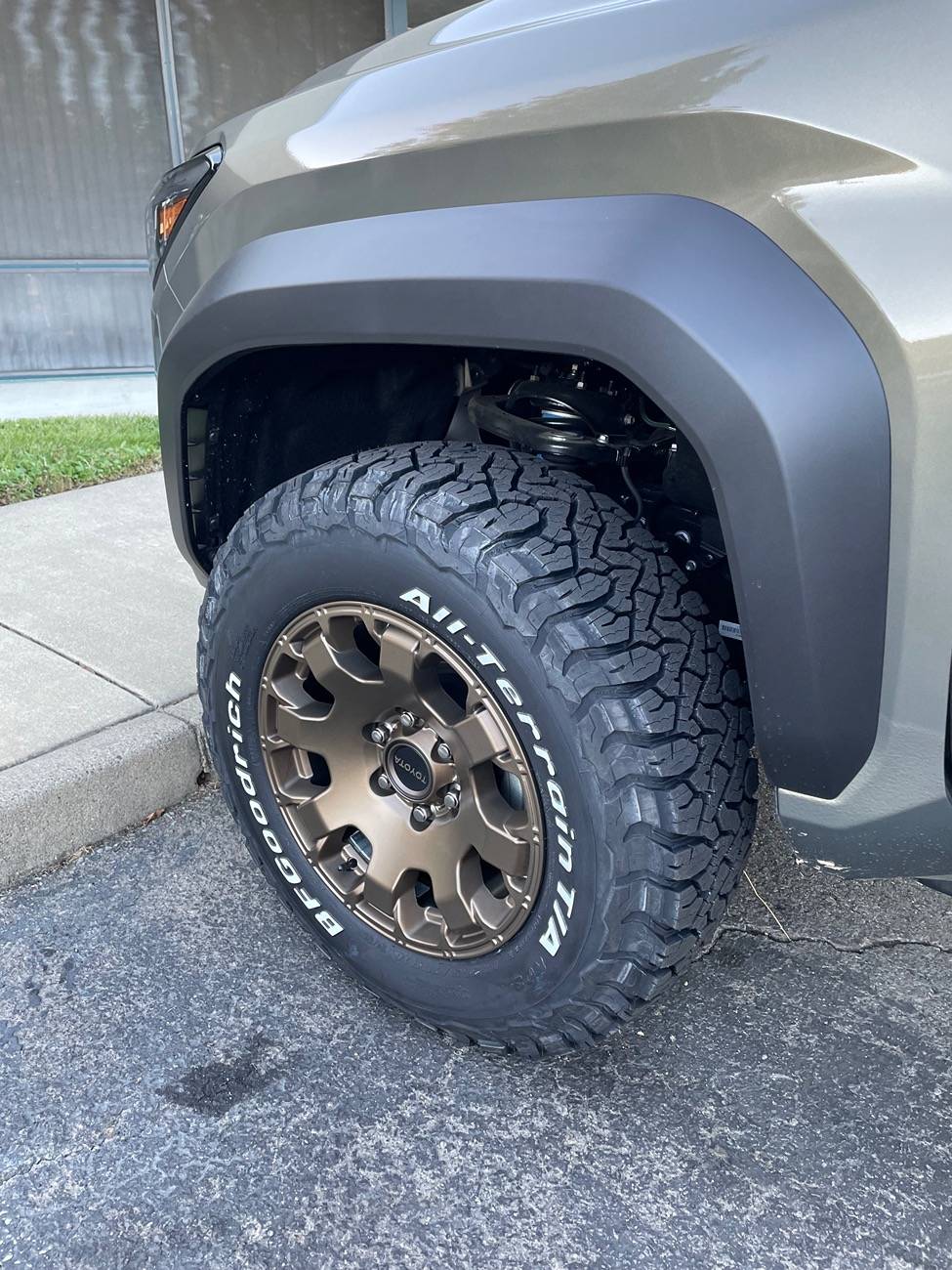

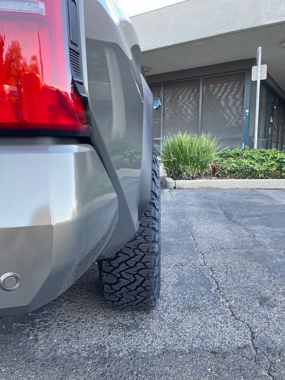

Figured I'd update ya'll on fitting 285's on stock Trailhunter wheels. Chris and TJ @Discount Tire in Seattle really took care of this install. No rubbing so far, might remove the crash pad after I take it out on some rough terrain to test any contact. I forsee having to get some aftermarket mud flaps....the OEM ones don't offer much coverage.
BFGoodrich
All Terrain T/A KO3
LT285 /70 R18 127S E1 RWL
BEFORE:
AFTER:

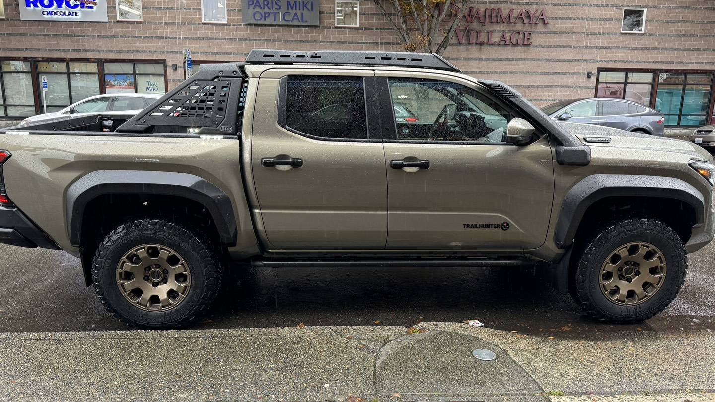

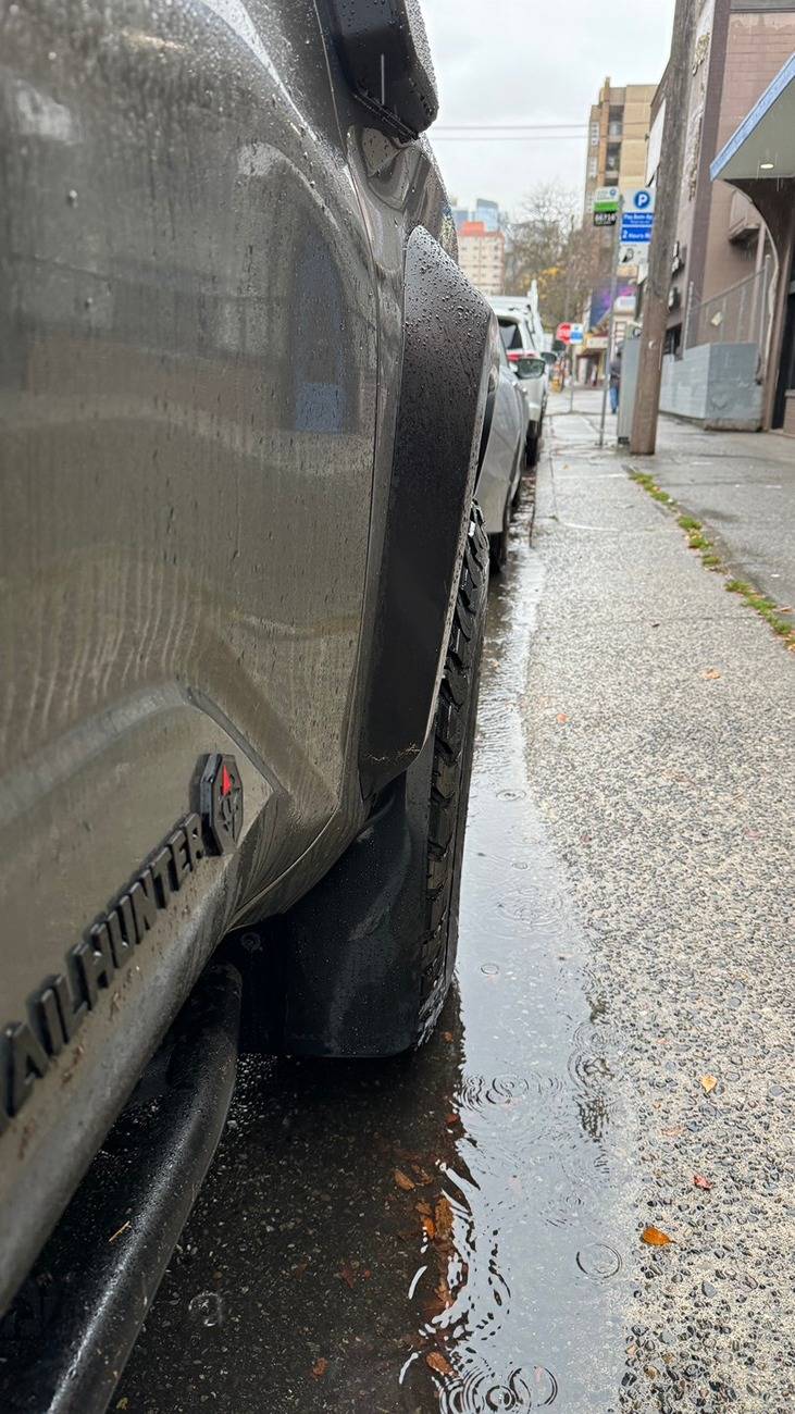

10/31- UPDATE:
Went back to @Discount Tire and TJ was able to swap out the 285 KO3's for 275 KO3's, and the difference is HUGE. Not only am I able to get an additional 2 mpg, but I can now coast on the freeway without loosing speed immediately. With each tire being 6 lbs less, I'm happy that I was able to downsize. Not only do I still have the aggressive look of the KO3's, but I also didn't lose the off-road capability of the tires. The ride is MUCH smoother and vibration is very minimal. 10/10 would recommend.
Now that I have enough clearance at full lock, I was able to install the Rally Armor Mudflaps and they look GREAT! Plenty of coverage but low profile enough to not be super distracting. Will keep this thread updated as I put more miles on these tires, but so far, I think I've found my style. Pics Below!

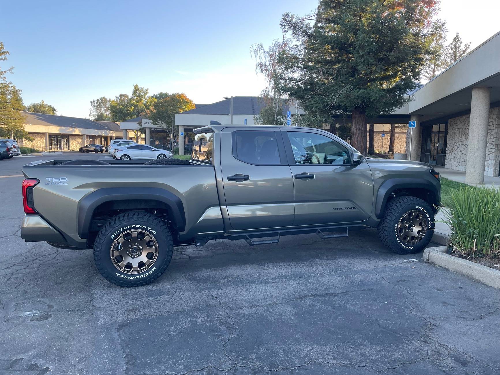

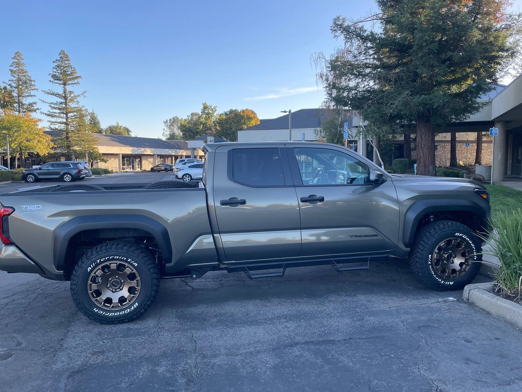

Just swapped in trailhunter 18 wheels with BFGR 265/70/r18 KO3s for stock TRD OR wheels and tires. Slight improvement :wink: What you guys think?
Sorry, but I think you went backwards on your wheel swap.
