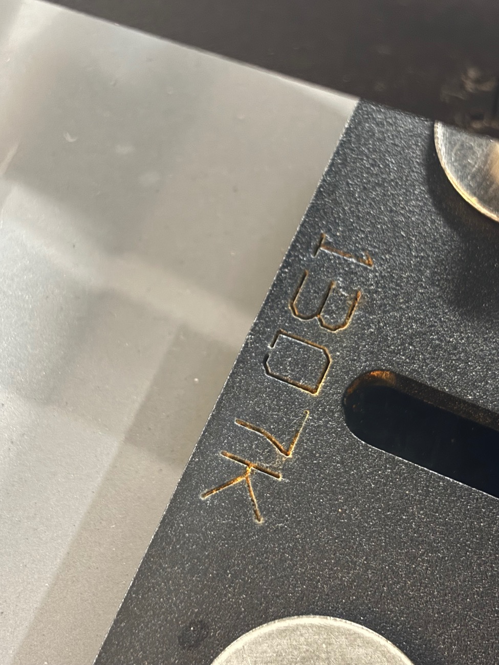

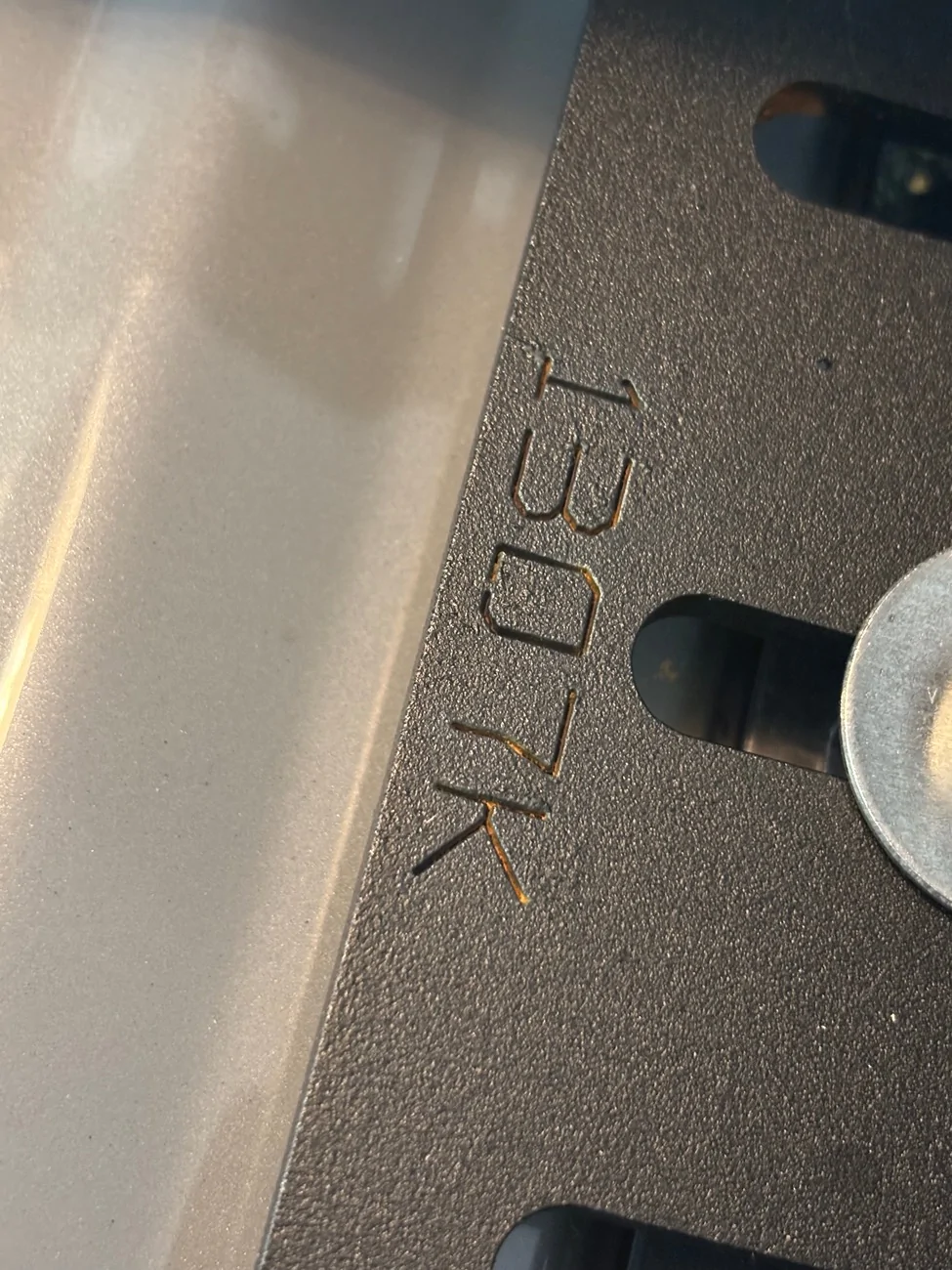

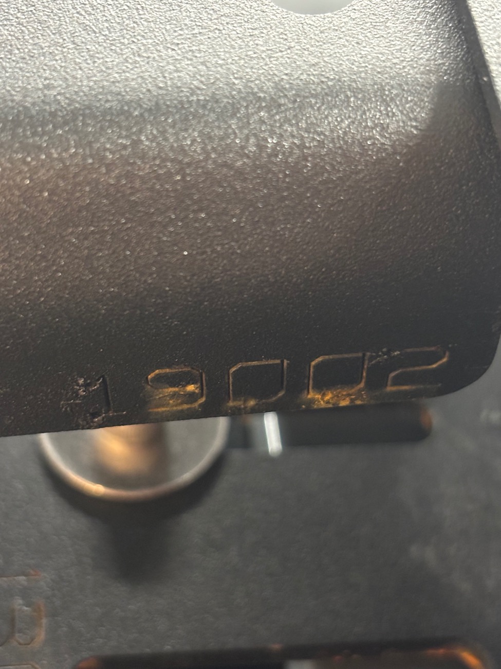

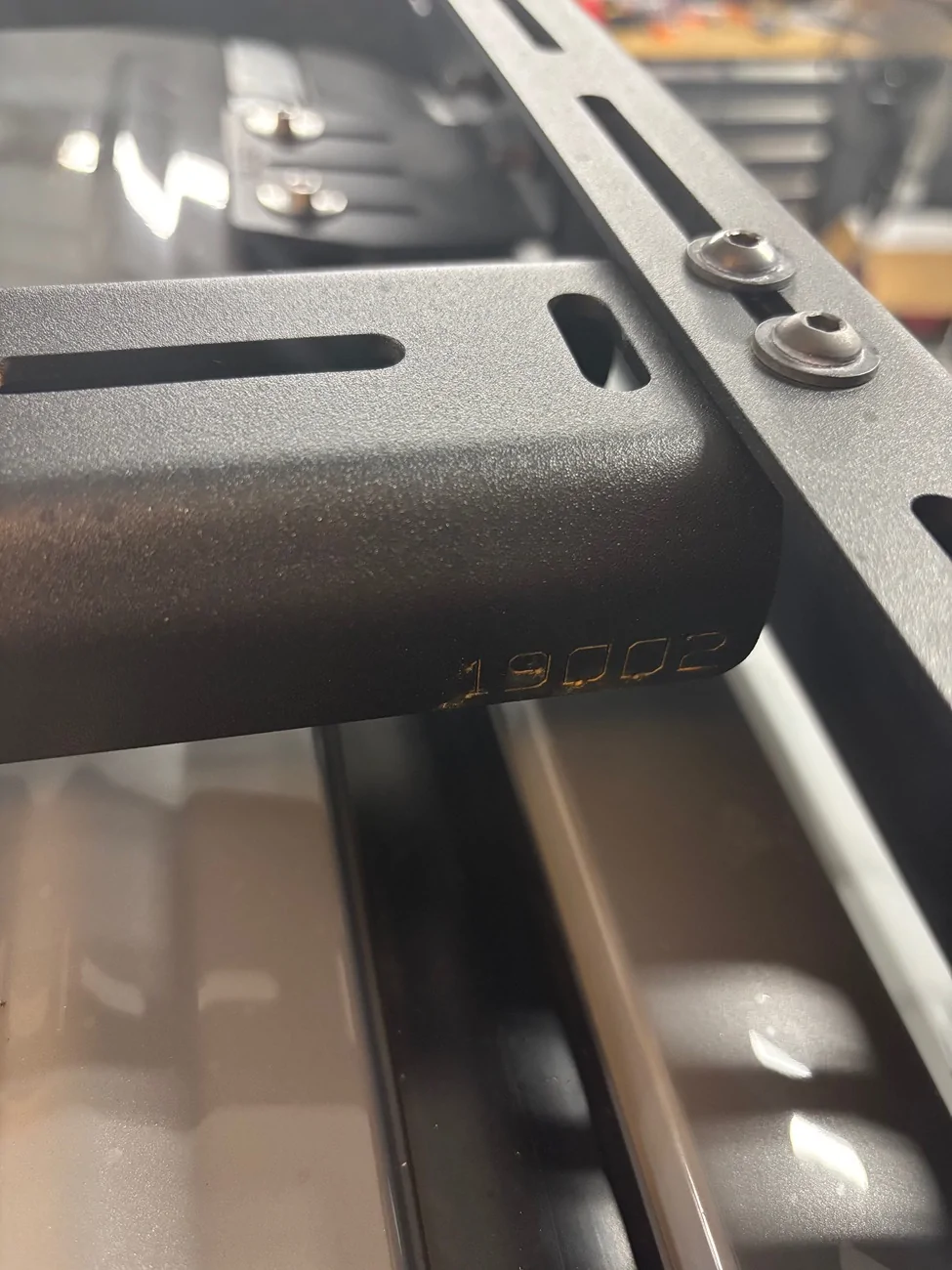

I just took some pics of mine today. Installed June 15 of this year. 2.5 months and already rusting in several spots. I’m going to email the company and see what can be done. Obviously, I’m not pleased.
Man, now I really am thinking that I'm gonna need to add some sort of extra coating. I get where the engravings start rusting since that seems done after the powdercoat, but all the other places like the slotting and threads?!?! that is either bad QC or jus carelessness I feel like.
I still love the look of the rack, and while measures shouldn't need to be done receiving a brand new product, seems like that is what is going to be needed.
wradar
May 9, 2025
VA
2021 Tacoma
I don’t think they’re added after, I just think they’re so thin that the powder isn’t able to impregnate the cuts thoroughly enough to get good coverage.

That doesn't explain the bolt threading and slot areas though those are plenty big for the powder coat

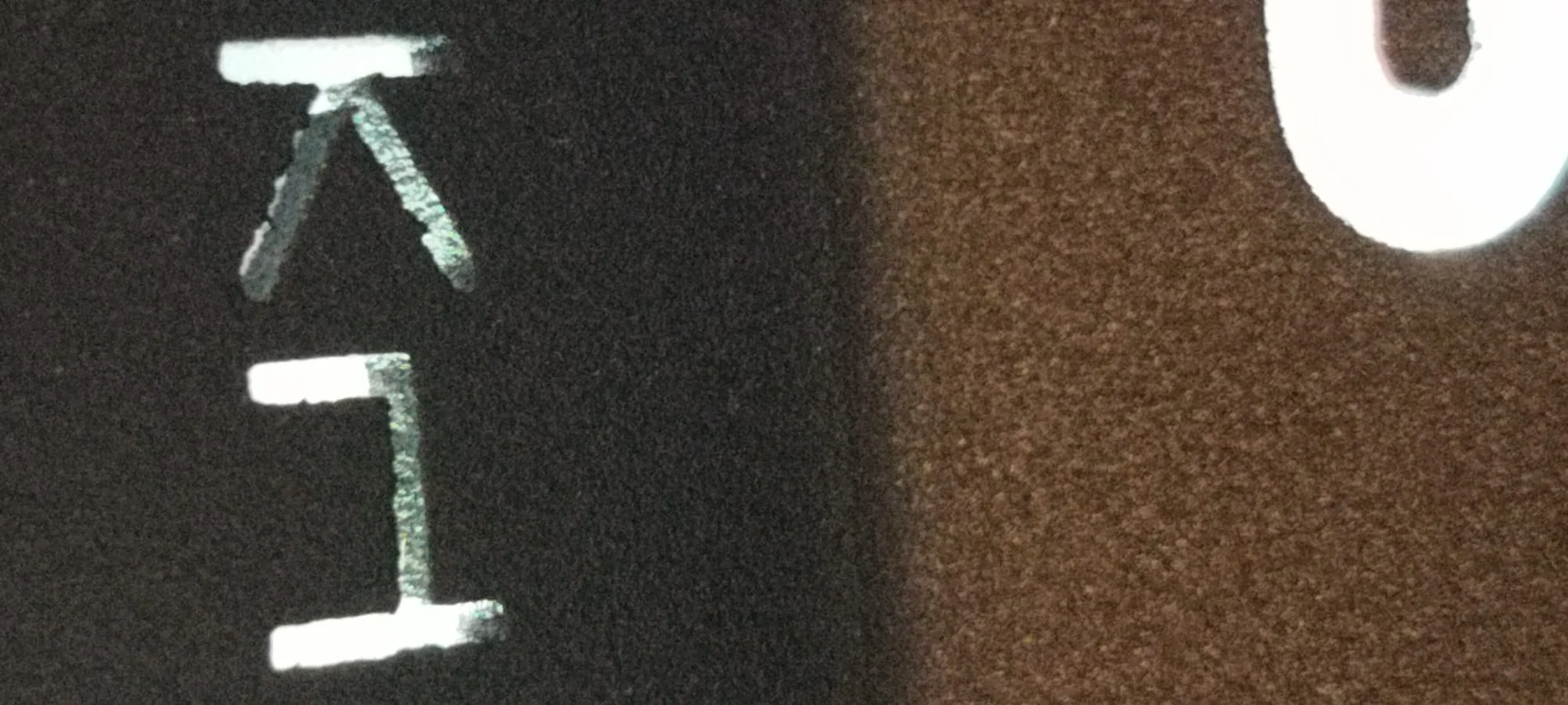

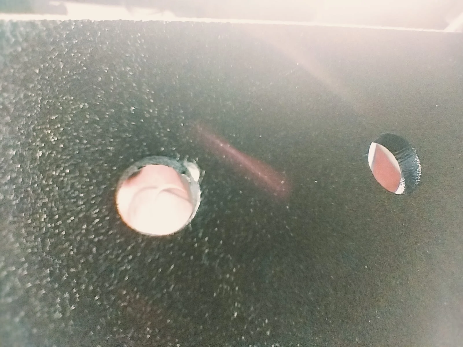

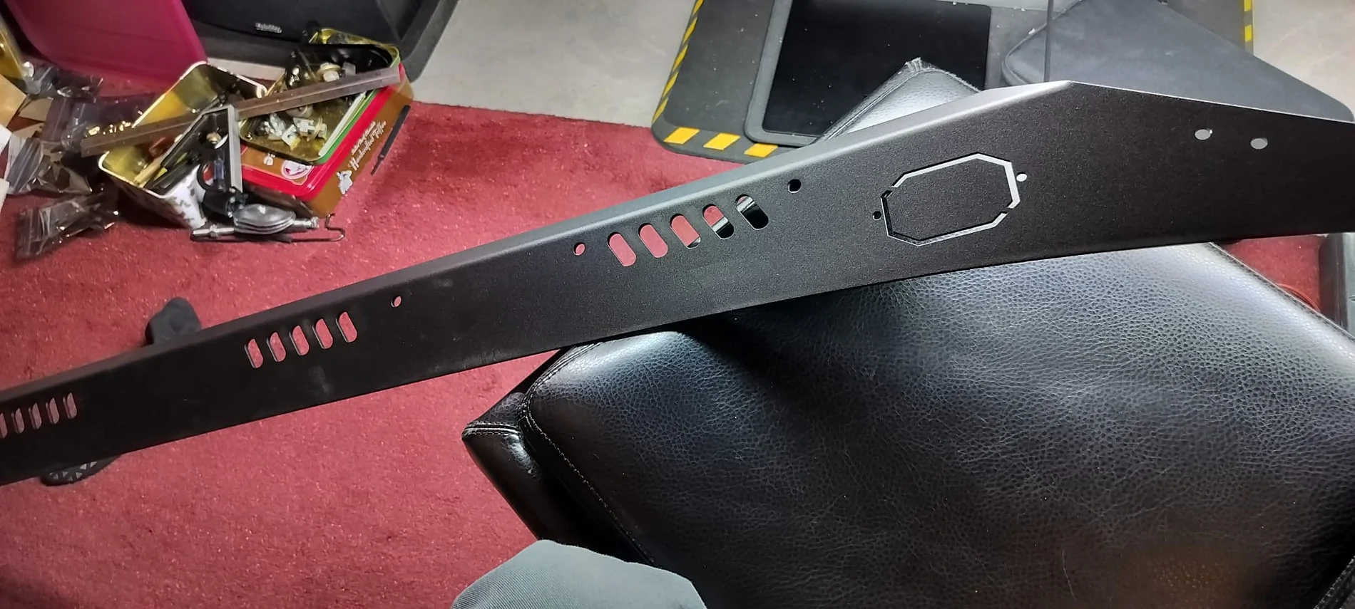

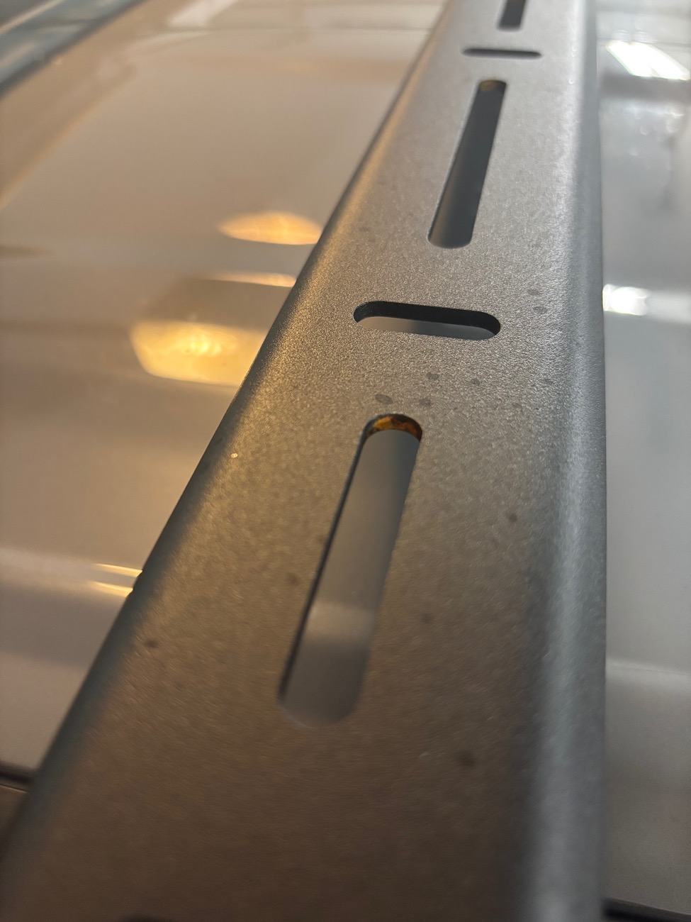

So to give everyone an update, I have not yet installed my roof rack, as this whole post got me thinking of what could be the main cause. Keep in mind this is a brand new uptop kilo rack just received last thursday and only pulled out the box, never installed.
The pictures are of just 1of the main side pieces.But I imagine that the powdercoat issue is a part of all pieces that go through the process.
Ultimately from what I can tell its it seems like the powdercoat guy is doing bare minimum of what he's laying onto the parts.

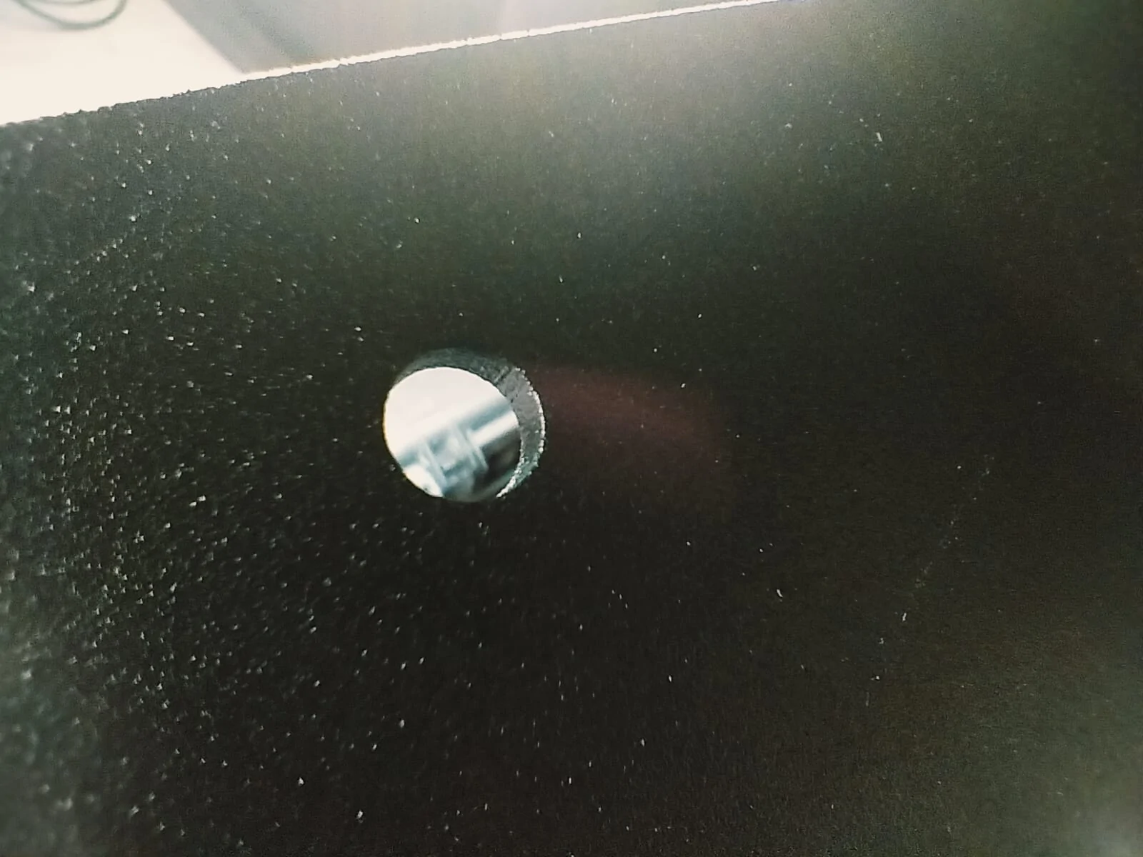

The small halfcircle here is probably where the part was hung from, but you could see on the edge of the right hole, that there is a hairline edge thatdoesn't look like its fully covered.
2024 Tacoma UpTop products review & photos WhatsApp Image 2025-09-01 at 23.03.28_b9128ded
a little more sharper shot and adjusted light to see where the edge is missing some coat
2024 Tacoma UpTop products review & photos WhatsApp Image 2025-09-01 at 23.03.28_bce5645

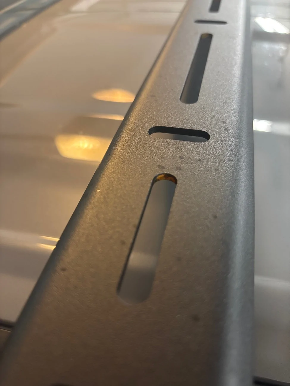

At first here I thought this might just be dust and thought ok lets try wiping this away. But rather it seems that these sports are really where the coat is just more thin. or didn't adhere well enough, and so by the time the rack reached me, some have sloughed off.
2024 Tacoma UpTop products review & photos WhatsApp Image 2025-09-01 at 23.03.28_34c0acf
Don't worry about your uptop logo tho, there is plenty of coating there. nice and thick too. SMH
2024 Tacoma UpTop products review & photos WhatsApp Image 2025-09-01 at 23.03.28_fbfdf0d2

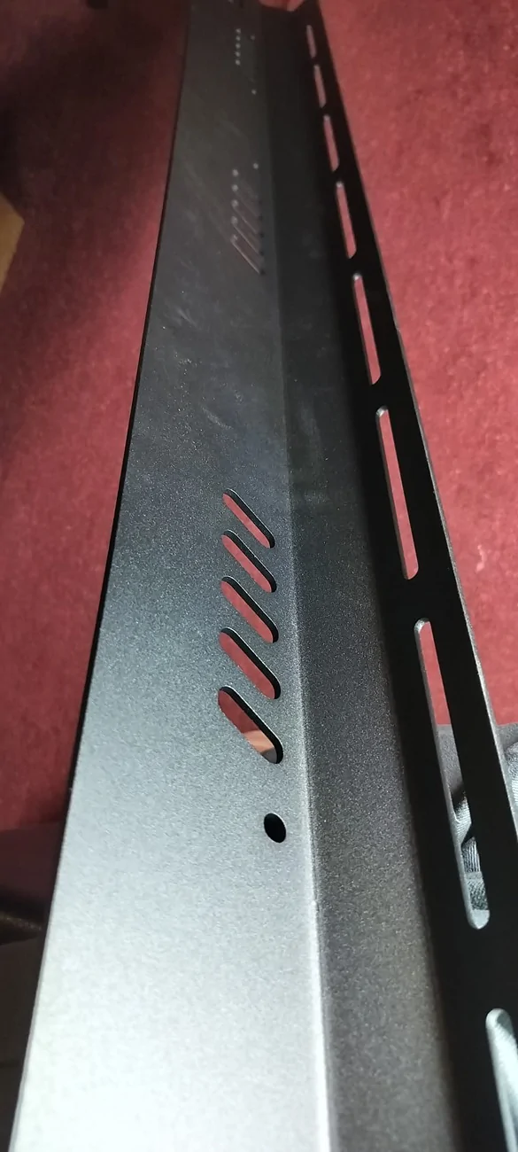

Also on the note of the lettering being too small for the powdercoating to penetrate into, at least on this part seems that it is more than large enough. But of course this is by the logo, so I imagine more time was spent spraying around this area.
2024 Tacoma UpTop products review & photos WhatsApp Image 2025-09-01 at 23.03.28_c3f3c055

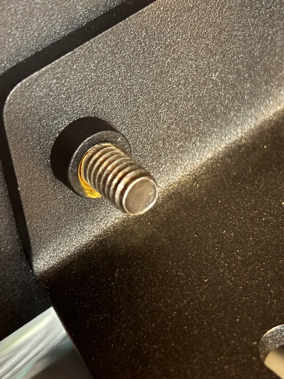

Same "dust" marks,well no not dus, but thin powdercoating, and his is on the OUTSIDE that is visible to all.
2024 Tacoma UpTop products review & photos WhatsApp Image 2025-09-01 at 23.03.28_c1402836

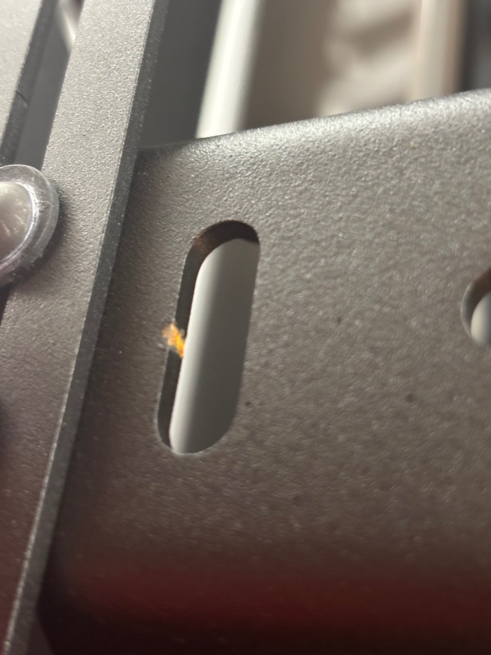

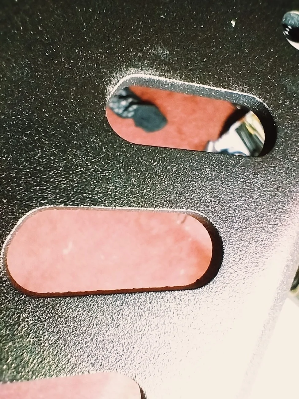

Another one of those slots exhibiting signs edge of the metal showing that might become rust prone later.
2024 Tacoma UpTop products review & photos WhatsApp Image 2025-09-01 at 23.03.28_ddc96389
So there you have ladies an gentlemen, brand new rack, still sketchy QC. I feel like I need to take the rack to a powder coat shop, pretty good feeling that if I had installed it, i'd start seeing rust stains real fast, and it barely rains here!
