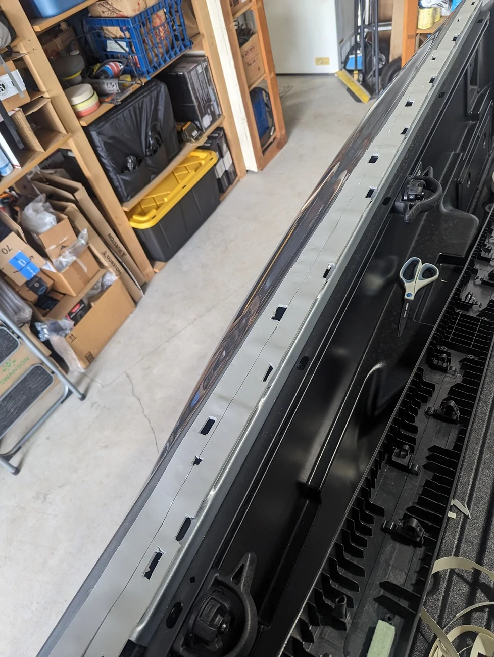

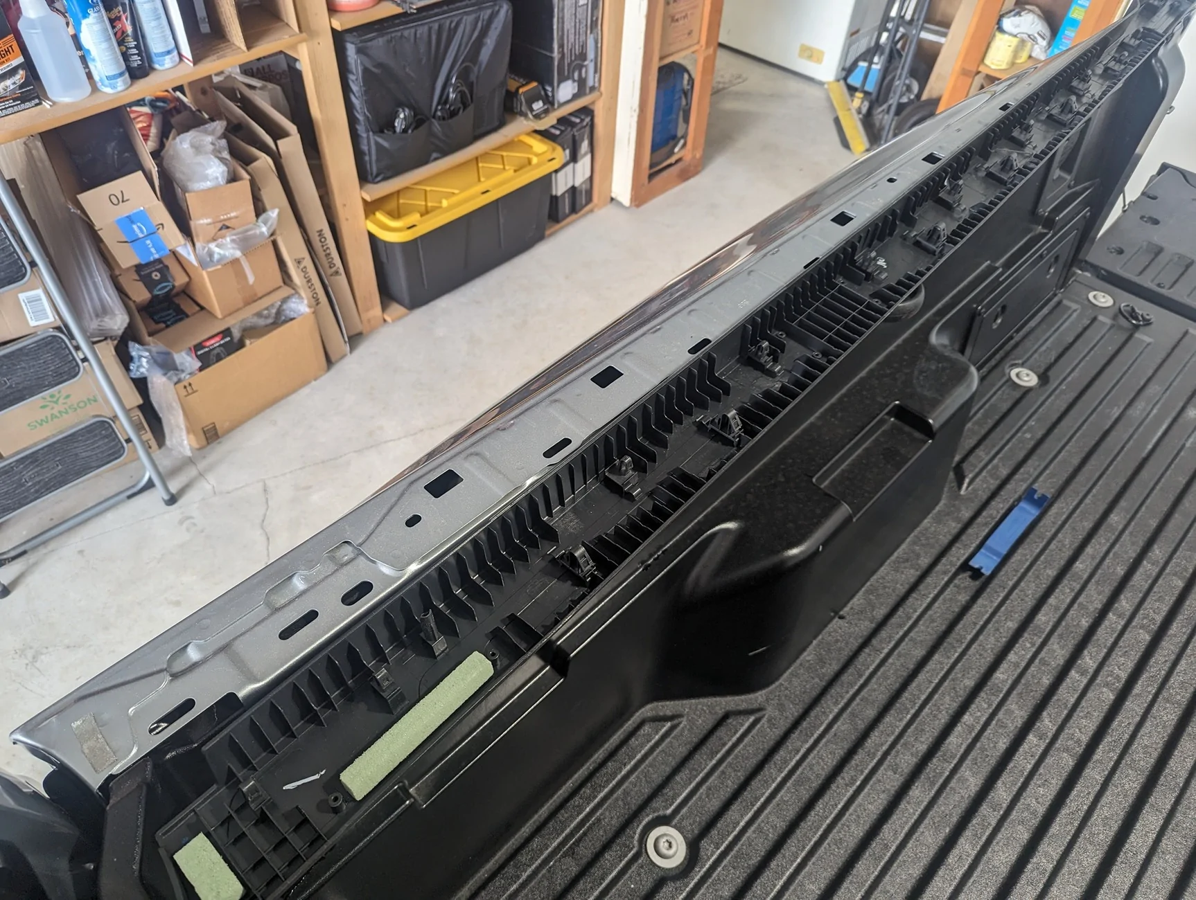

Hey Dan, I came across your thread after searching for Lonepeak. I just received an email that my build is ready for install and I will be driving to Washington in a couple of weeks. I was wondering if you did the recommended bed cap seal before picking yours up and any advice on the subject would be greatly appreciated as well as any thoughts on your camper now that you have had it for a while. Thanks, again.
I did attempt to seal the caps and would encourage you to do a better job than I did. The Tacoma bed is a sieve and I've been chasing water for two years now.
2024 Tacoma Lone Peak Overland Camper Install - Review & Photos 1000007689
2024 Tacoma Lone Peak Overland Camper Install - Review & Photos 1000007688
If I had it to do over again I would have used a couple tubes of Sikaflex and filled every hole I could find. It's not just the caps either, although they're obviously what you really need to do before the install. Water leaks around the bed lights, tie-down rails, storage bin, etc... Basically any place the bed is cut or drilled will leak!

Thanks for the tips! I will try and be diligent with the sealing. I'm coming from Atlanta, lol, and plan to catch a Braves game against the Mariners during the first week of May. I plan to get the install a couple of weeks before then and do some exploring around the area with the new camper before the game. I've never been to this part of the country. I'm coming from a 2wd setup that I've taken thousands of miles on trips, and this will be my first real overlanding capable machine. I have the Trailhunter so it should be setup for the extra weight. I may still add some beefier Dobinson's once I get it built out the way I want it and get closer to a final weight.
