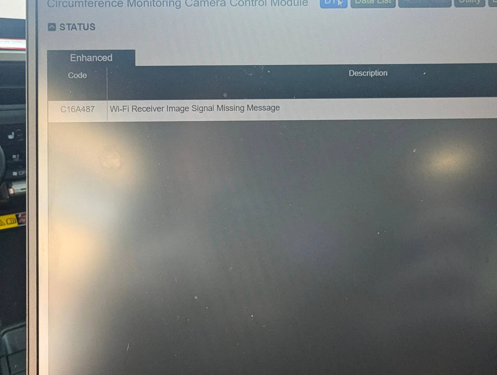

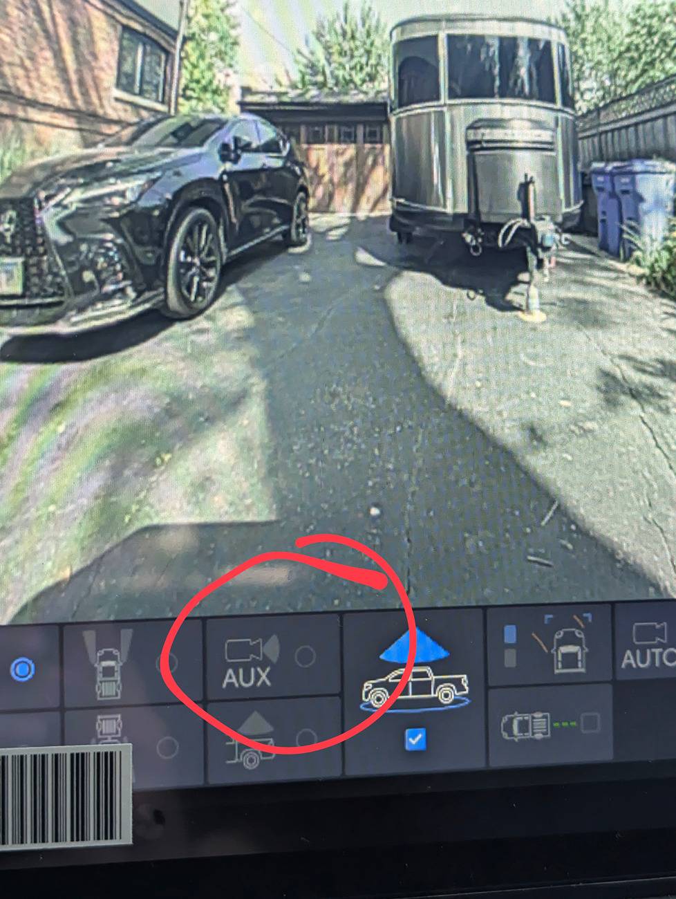

Updates!
Managed to get GTS+ working on my laptop and when I working on try to configure the grill camera on my new Heritage grill, there is an option to enable to Auxilary Camera - better known as the WCS camera to us.
When doing so, we gain a new option - the one anyone interested in this thread seeks, the "Aux Camera".
2024 Tacoma WCS (Wireless Camera System) for 4G Tacoma PXL_20240810_203355100~2
However, after enabling the option, we see that the truck throws a DTC - C16A487 to be exact, description of "Wi-Fi Receiver Image Signal Missing Message".
2024 Tacoma WCS (Wireless Camera System) for 4G Tacoma PXL_20240810_201835549
But I think this is good - this means, the car must have a "Wi-Fi Receiver" ... probably what I called in my previous post the "Trailer Camera ECU" per Toyota's documents.
So, what does this mean :
a. I'm fairly certain trucks equipped with the Digital Rear View mirror have this "Wi-Fi Receiver" or "Trailer Camera ECU". It's all one unit. This is even further confirmed as the wiring diagram for the ECU shows an input for a "Rear Digital Camera Assembly #2" - my guess is this is the camera for the digital rearview. It's basically a single box for everything digital rearview mirror related.
b. In theory, we should be able to install the (2) aforementioned antennas in my previous post and connect them to this ECU/control box/Wi-Fi receiver. Per removal/installation docs, it shows this being located behind the rear seats.
c. Once the antennas are installed, you need to enable the Auxilary Camera in the "Circumference Monitoring Camera Control Module" within GTS+.
d. At that point, you'd go through the pairing process with the actual camera kit itself. We have the part # above.
I think at this point I may just order the two antennas and give this a go. They're only like $50 a piece. But my only concern is whether they come with the harness/connector as well. So I think I need to just rip out my rear seats and do a bit more research. But I feel like we are getting close to a solution.
