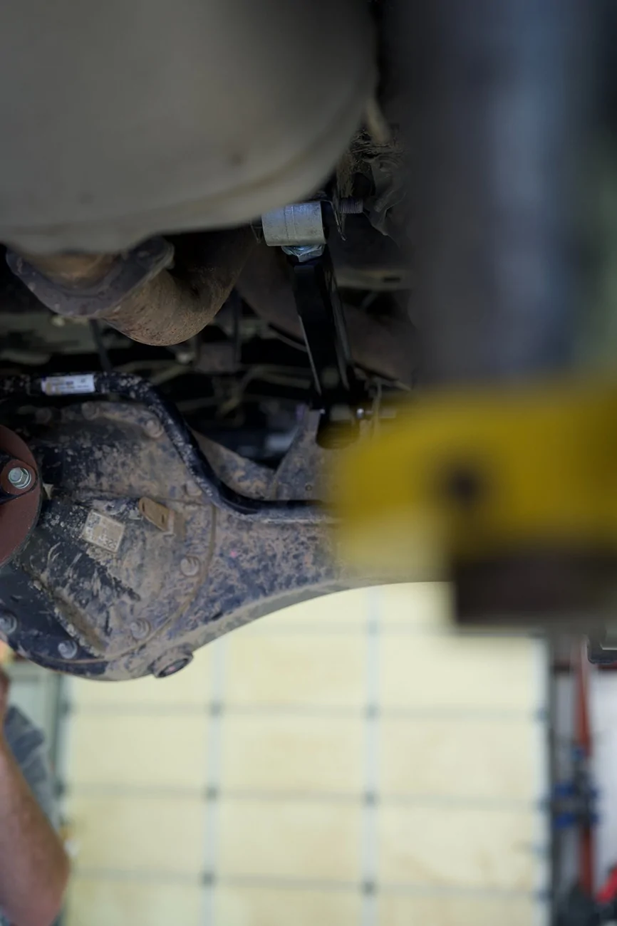

So what are the different links, and what does each one do? There are upper links, lower links, and the panhard, some call it the track bar. I’ve got each one pictured in this section.

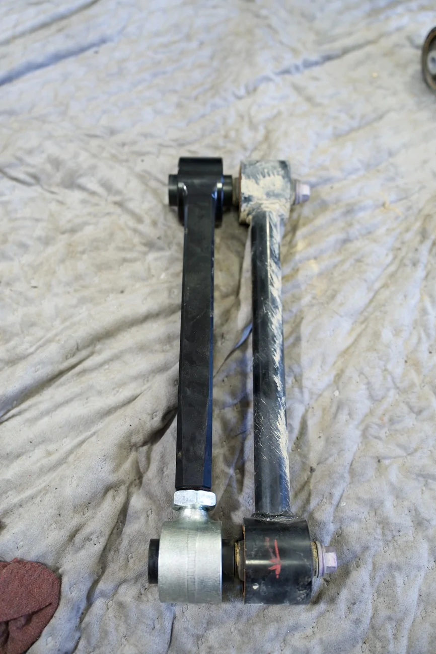

Upper links:
  • These are the shorter arms mounted higher above the axle. Their main role is controlling axle rotation. They do a lot of work during acceleration and braking by helping keep the pinion angle in check and preventing the axle housing from twisting too much.
  • For anyone less mechanically inclined: they help keep the axle from “rolling” backward or forward when torque is applied. Since the 2024 Tacoma’s coil-spring setup separates spring support from axle location, the upper links now handle part of the locating job that leaf springs used to do.

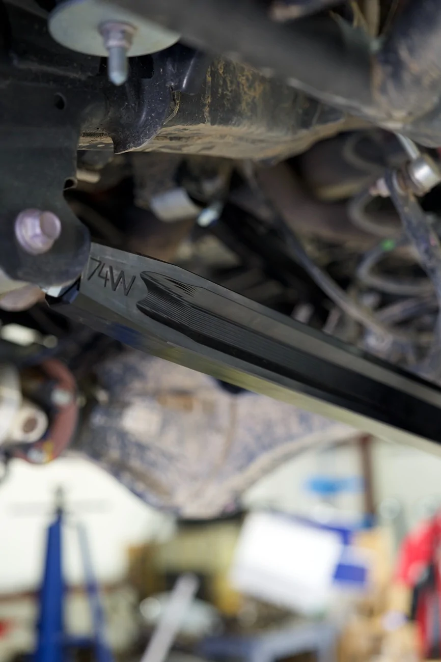

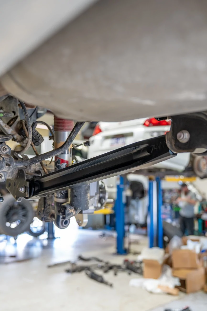

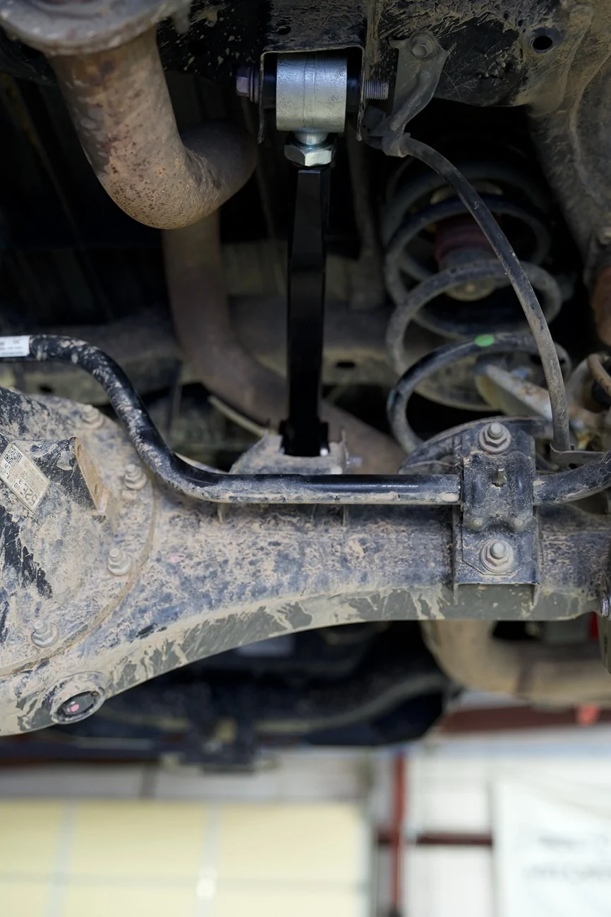

Lower links:
  • These are the longer arms mounted lower below the axle. Their main job is to keep the axle positioned front-to-back and transfer much of the driving and braking force between the axle and the frame. They also help guide the axle through suspension travel. Because they’re longer and mounted lower, they do a large part of the work in keeping the rear axle tracking correctly as the truck moves.
2024 Tacoma What Rear Links Do on the 4th Gen Toyota Tacoma and Why I Upgraded to 74Weld’s New Set DSC01263

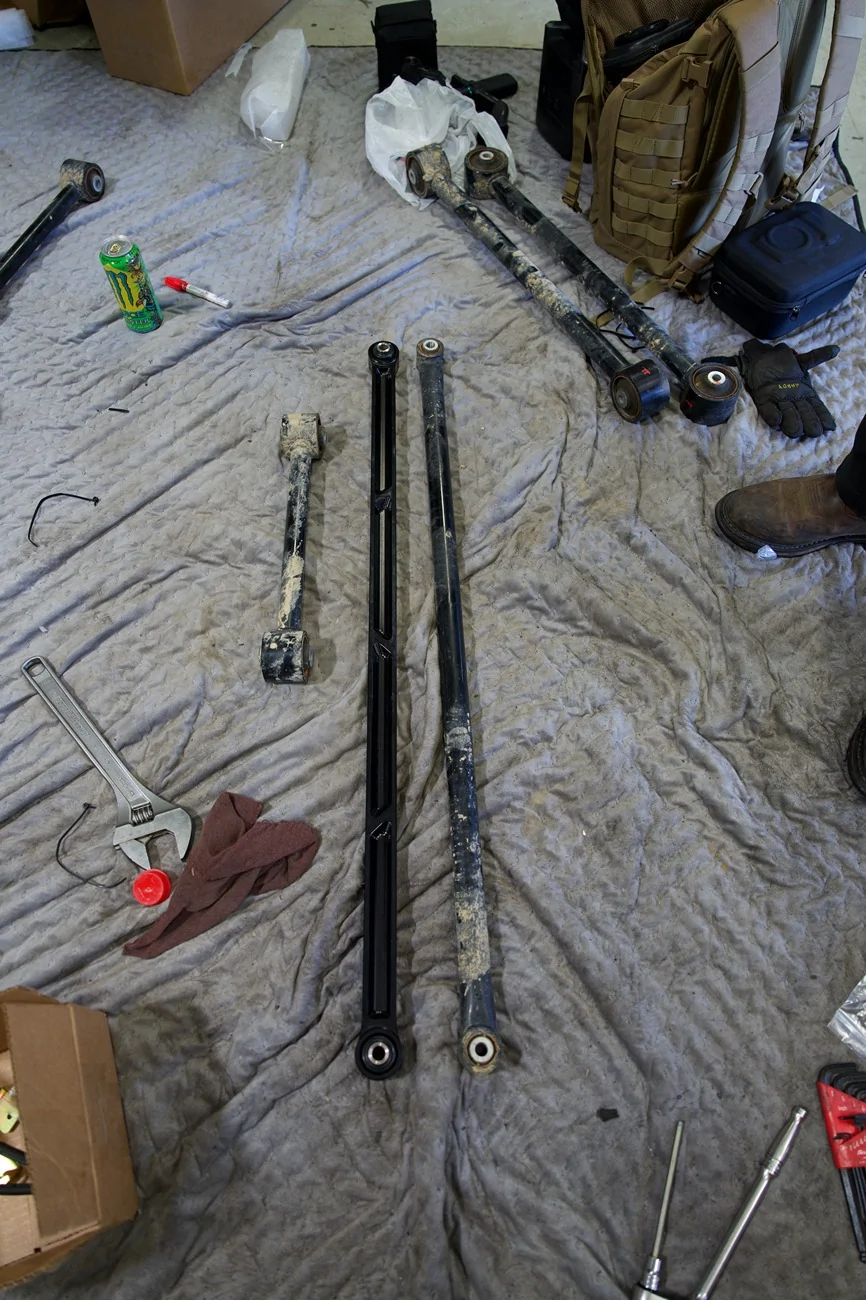

Panhard/Track bar:
  • The panhard keeps the rear axle centered under the truck from left to right as the suspension moves. The upper and lower links mainly handle front-to-back location, and axle rotation, while the panhard takes care of lateral control. Without it, the axle could shift side to side in relation to the frame.

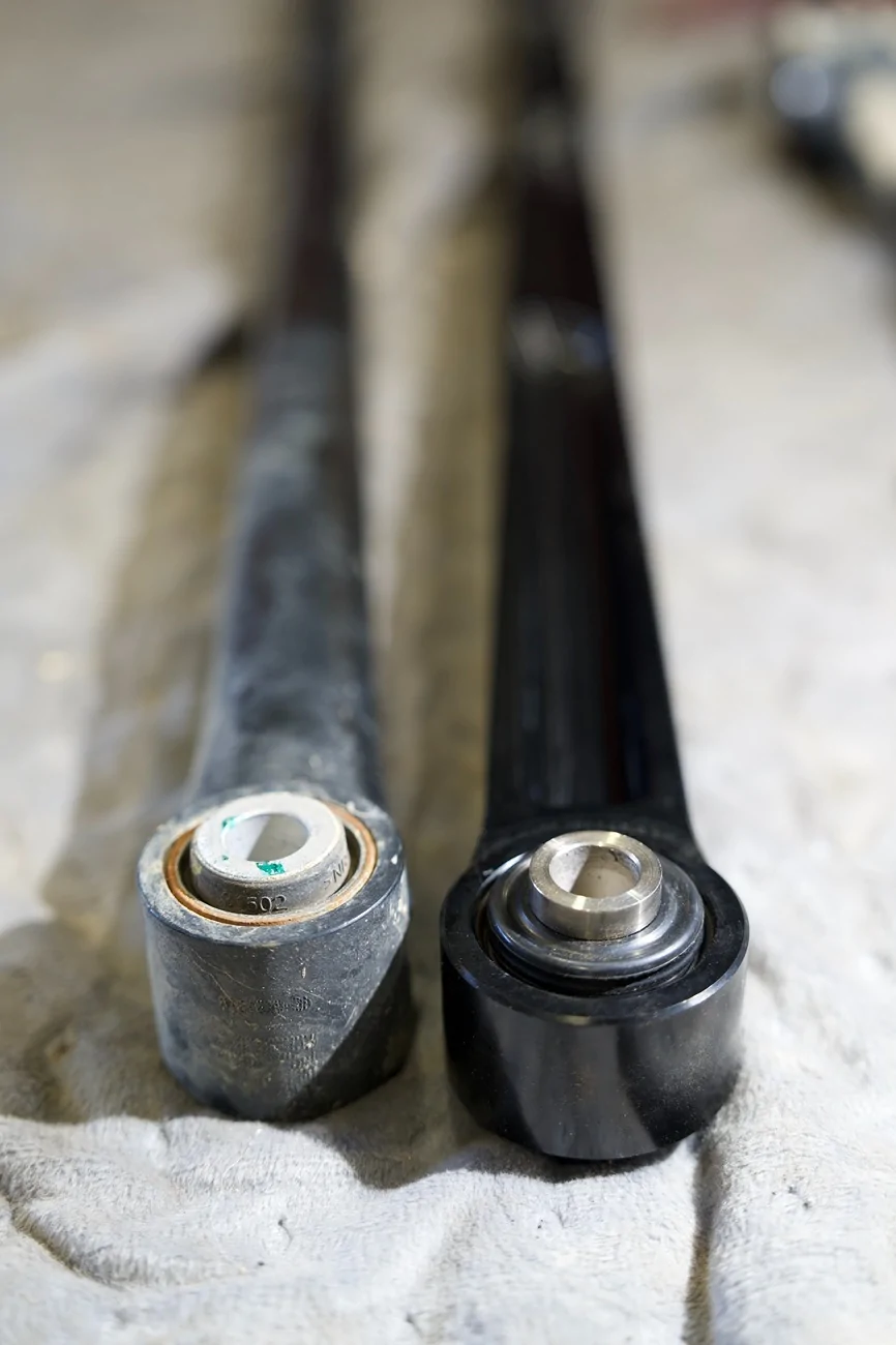

  • Maintenance: Each end of the upper and lower links uses a maintenance-free Rock Krawler Adventure Series joint. That means more angularity and articulation from the suspension, while still keeping the ride quiet. If you’re like me, a squeaky truck drives you insane. Especially a new one, so that matters a lot. The panhard/track bar is maintenance-free also, using a sealed flex joint on both ends.

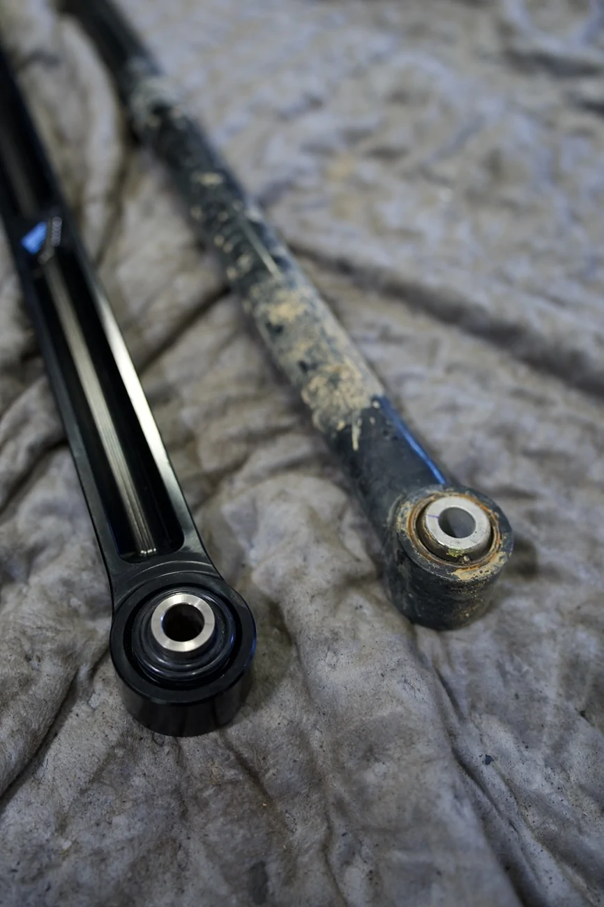

I attached some photos below showing the joints and side-by-side comparisons with the stock parts. If you made it this far, thanks for reading.
Upper Links vs OEM

Rock Krawler Adventure Series joint vs OEM

Panhard / Track bar side-by-side with OEM
