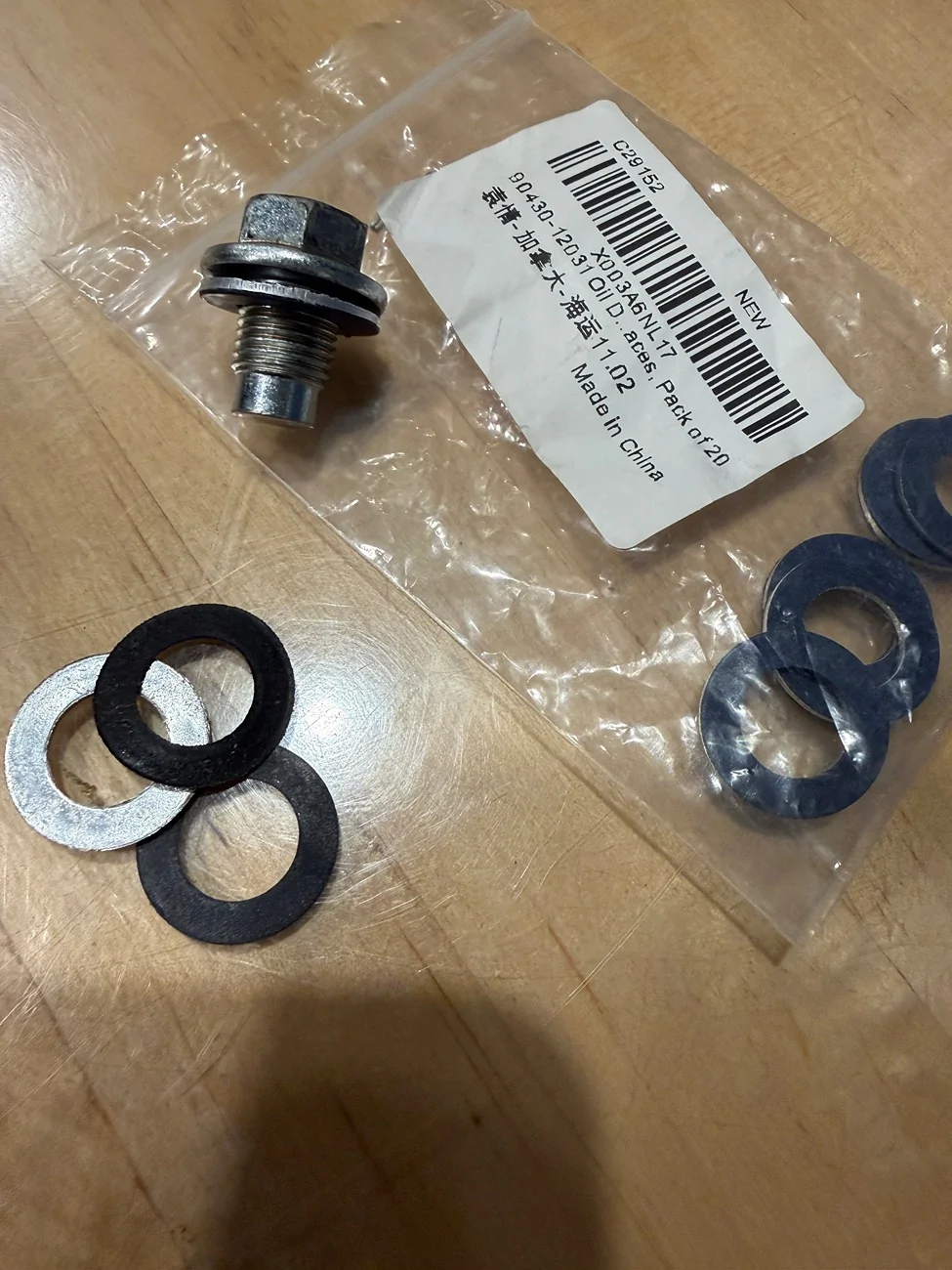

Just did an oil change on my truck and the drain plug was not even finger tight! Kinda scary. I don’t use a torque wrench on the plug but I usually tighten it quite well, and an extra crank for good measure. What I’ve found last two oil changes is the “Amazon” chinesium gaskets basically separate, the adhesive between the felt layers disintegrates, and thus the plug loosens over time. Quite dangerous, so beware. If you are going to use the cheap gaskets you’ll need to retorque after idk 500 miles? Otherwise use a genuine Toyota gasket purchased from the dealer for confidence.

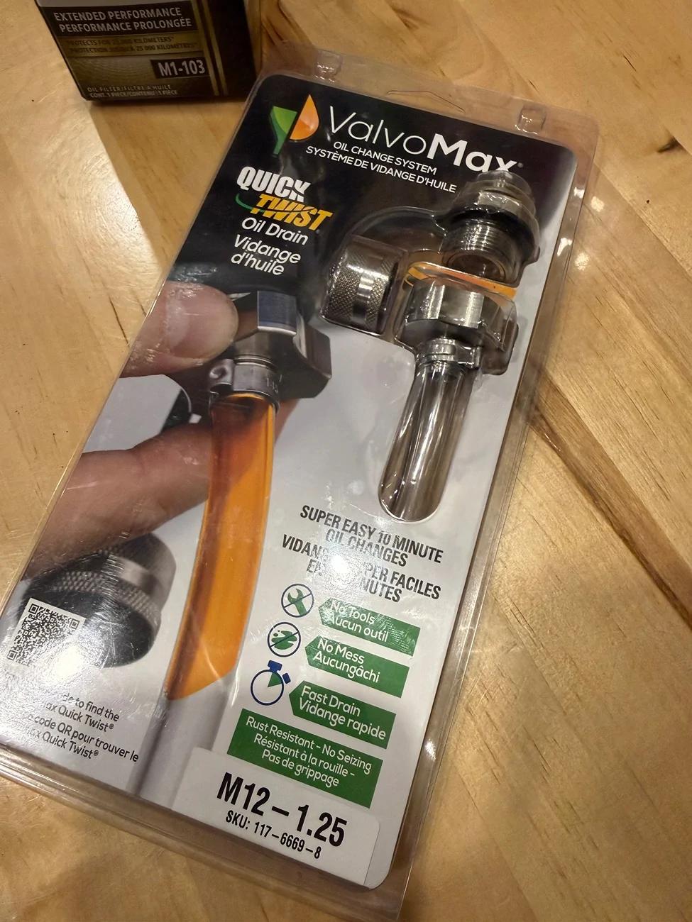

Since I had the oil drained and dealer parts was closed, I got a Valvomax. Seems high quality, should be nice and easy oil drains. I like the sealed cap and shorter threads so the pan drains more out.
