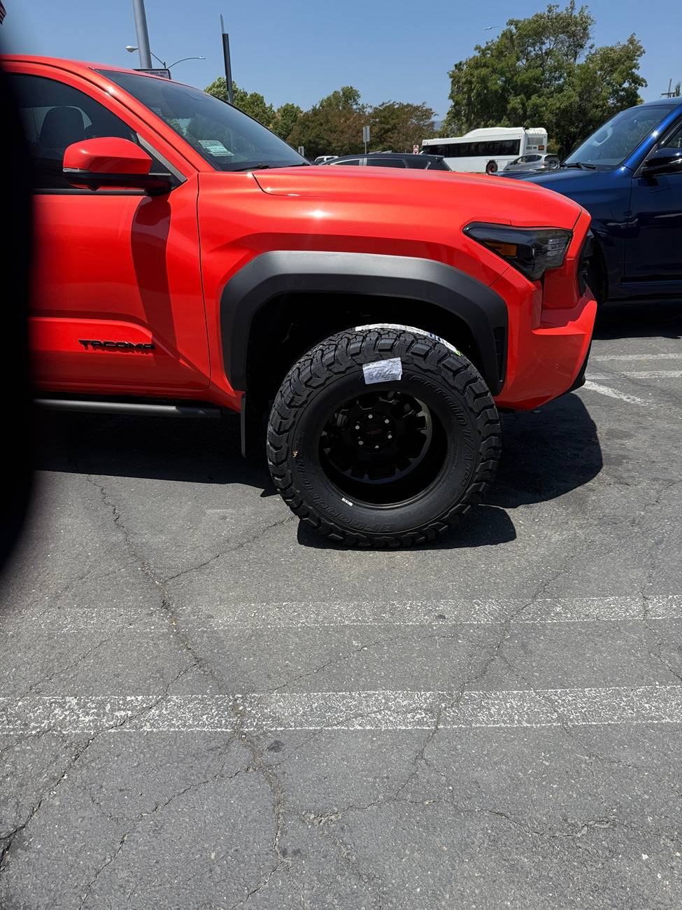

I went to America’s tire because I wanted to see the Nitto Terra Grabber G3 and Toyo OC AT3 EV tires in person. I talked with them about the tire’s fitment on the Methods I recently bought.
Wheels: Methods 316 18 x9 6x139.7 + 18.
Tires: 275 70R 18.
Basically, they said that tire size is in their red zone for potential rubbing and they recommend 275 65 R18.
Does anyone know for sure? Is there a site I can put in these specs and get a go/no go Before wasting money having them install tires that won’t fit without rubbing or modifications?
Here’s a shot of KO3’s in that same size in my wheel Well

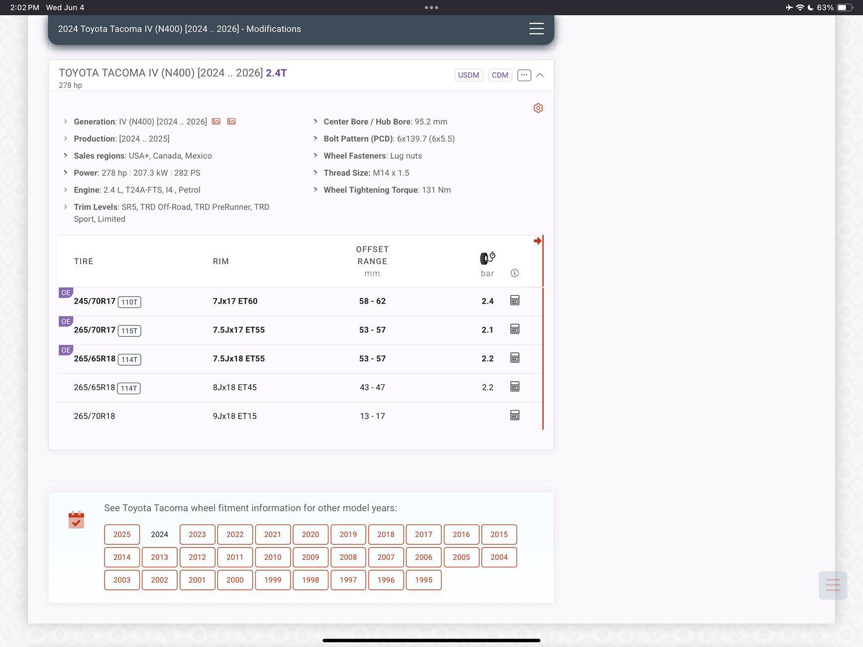

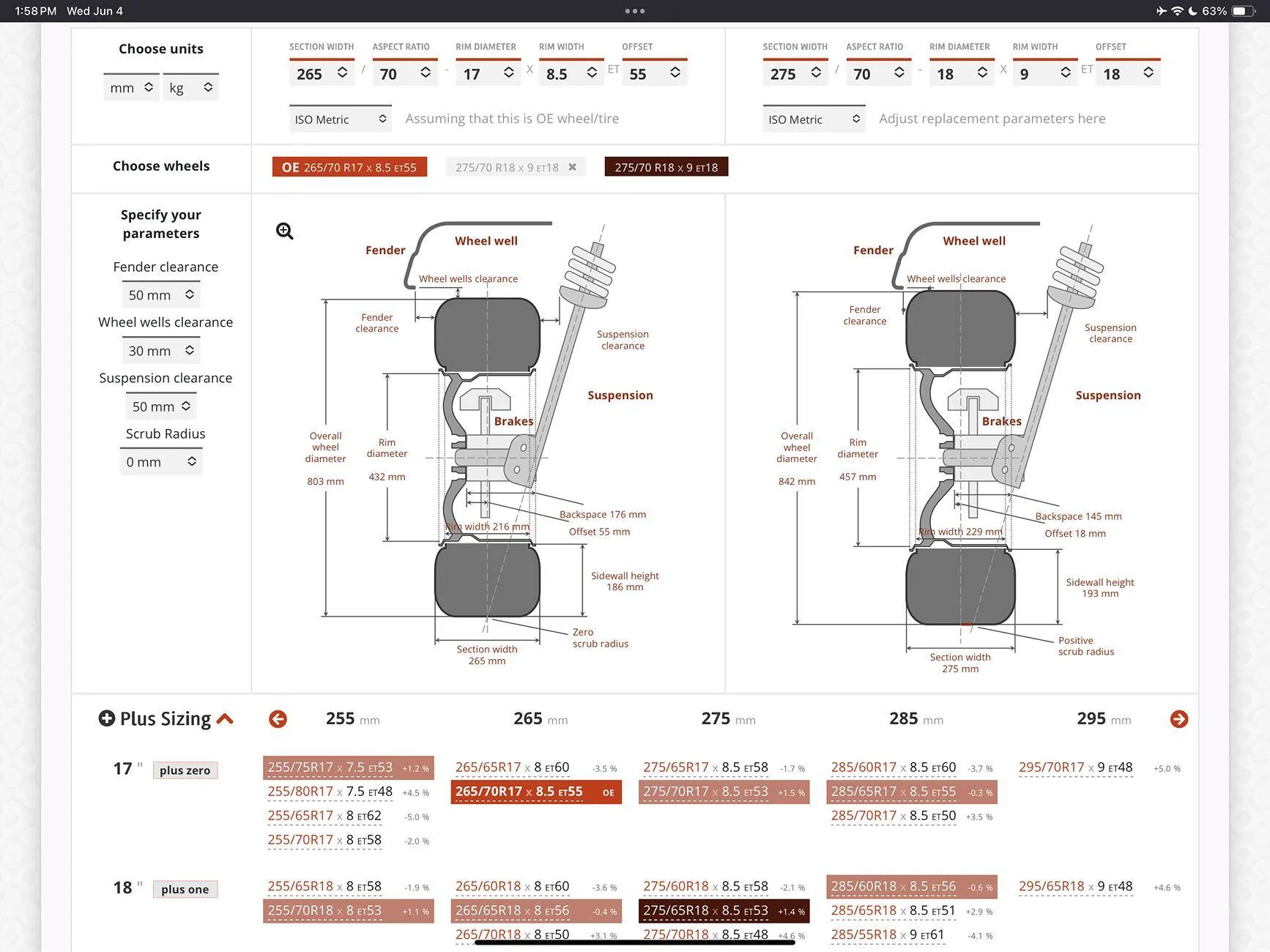

I found this, but I would think someone here has experience with the size I’m looking at.

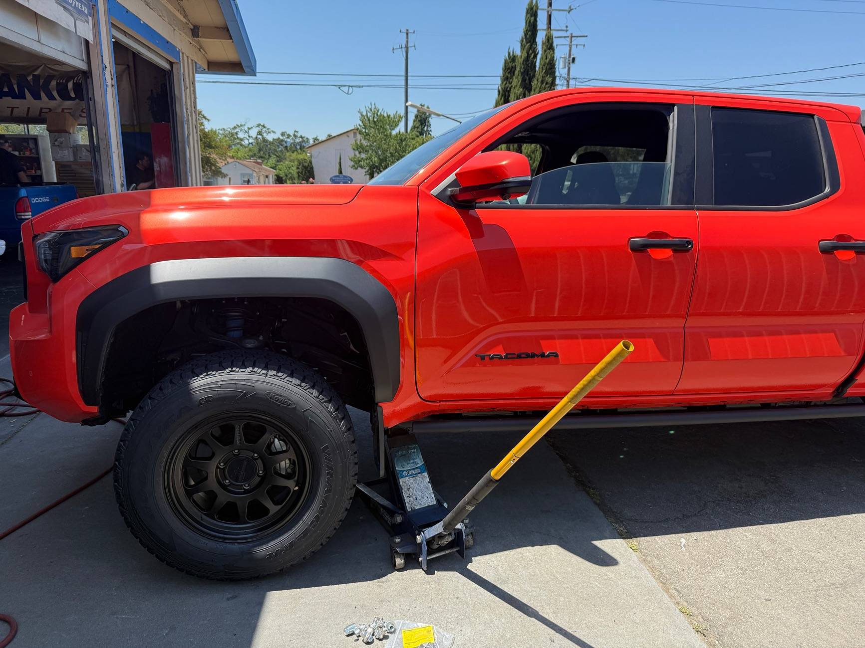

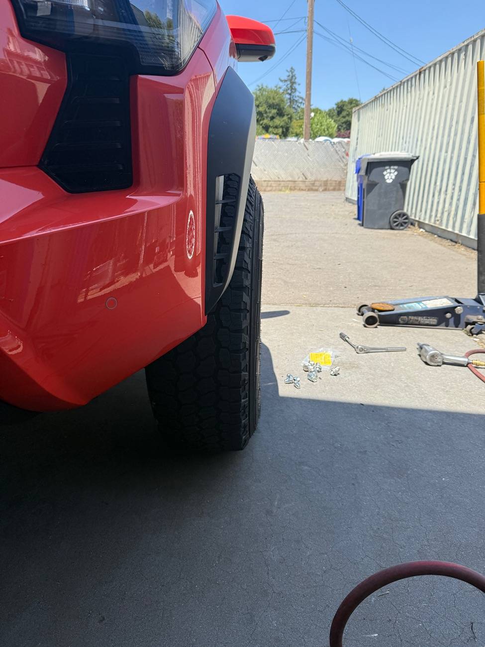

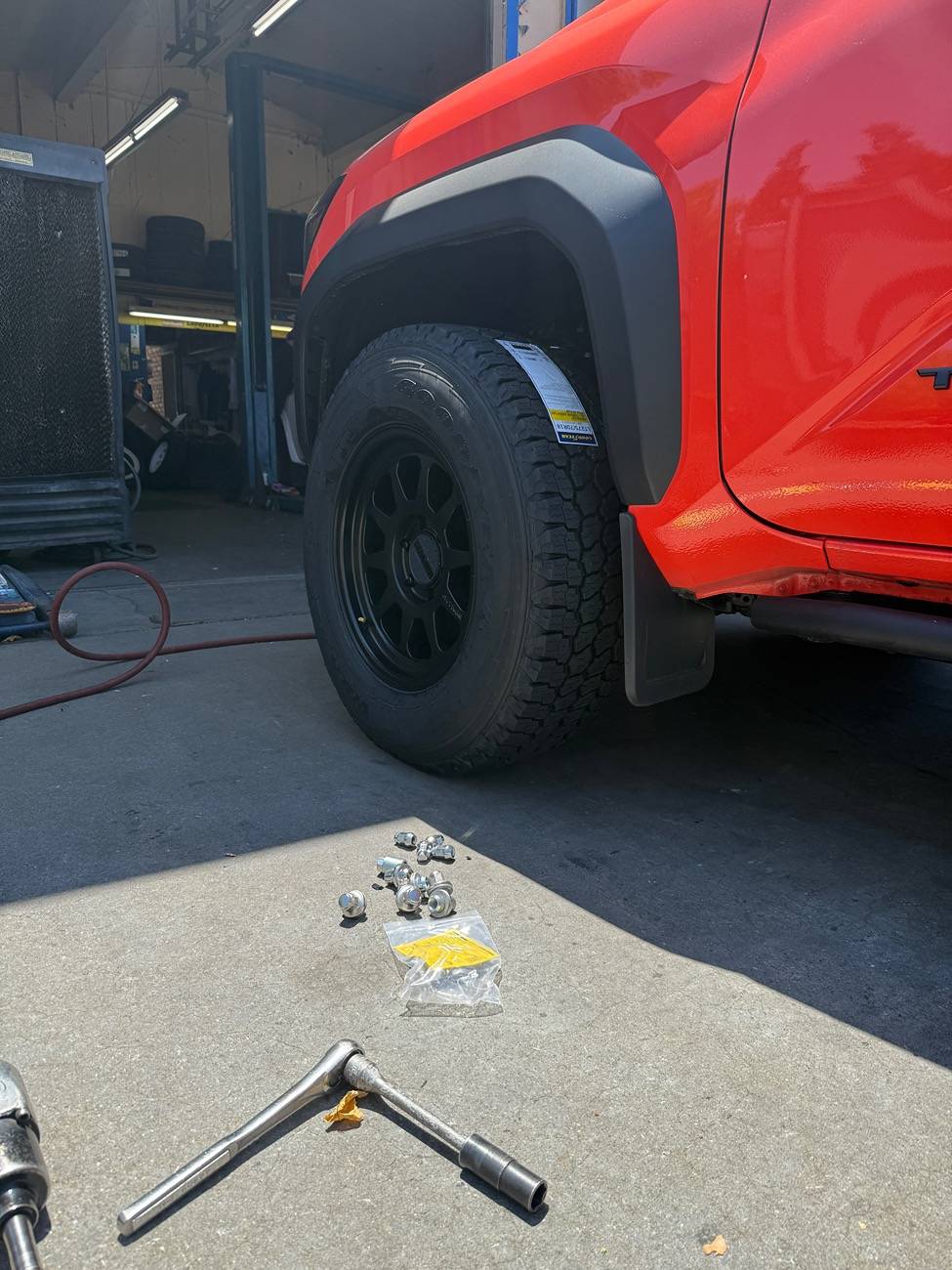

Thanks, I had a local tire shop test fit a 275/70/18 with a tire they have on hand and it’s just barely squeezes in. The tire i want is .15 wider than the tire they measured with. Probably will work. we’ll know when the tires arrive. I ordered Method’s lugs yesterday.
