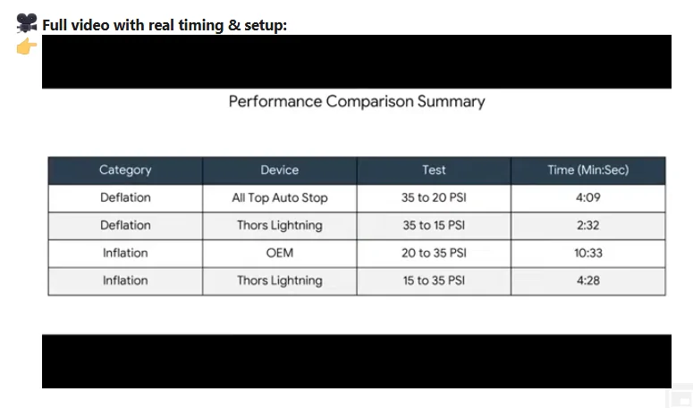

I finally did a real-world side-by-side test between the 4th Gen Tacoma Trailhunter factory onboard air and a serious aftermarket air system after multiple trail days — and I honestly didn’t expect the outcome.
I actually like Toyota’s onboard air for convenience. It’s clean, integrated, and always there. But when you factor in air-up time at the end of a long trail day, the difference becomes a lot more noticeable than I thought.
I tested:
  • Same truck (2025 Tacoma Trailhunter)
  • Same tires
  • Same target PSI
  • Stopwatch timing
  • Best-case setup for factory air (4-tire hose)
The results weren’t bad for factory… but once you compare airflow and total time, it changes how you look at onboard air vs aftermarket.
If you own a Trailhunter, air down regularly, or are deciding whether factory onboard air is “enough,” this is worth seeing before you commit either way.
🎥 Full video with real timing & setup:
Curious where everyone lands on this:
Factory convenience or aftermarket speed?
Drop your thoughts below — especially if you’ve run both.

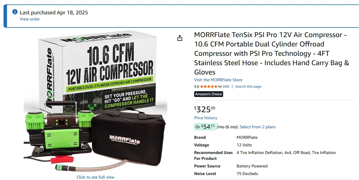

I use this external compressor:

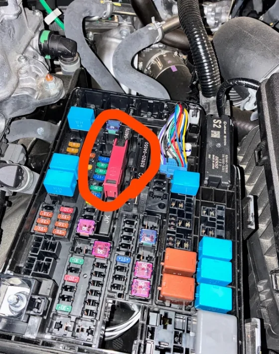

I open the hood and clip to the positive terminal by the fuse box, and ground to the chassis.
I have a four way hose that reaches all tires, and can "set and forget" the PSI desired, and handle other things while it airs up. Will take a full set of KO3s (285/70/17) from 18 to 32psi in about 3 min.

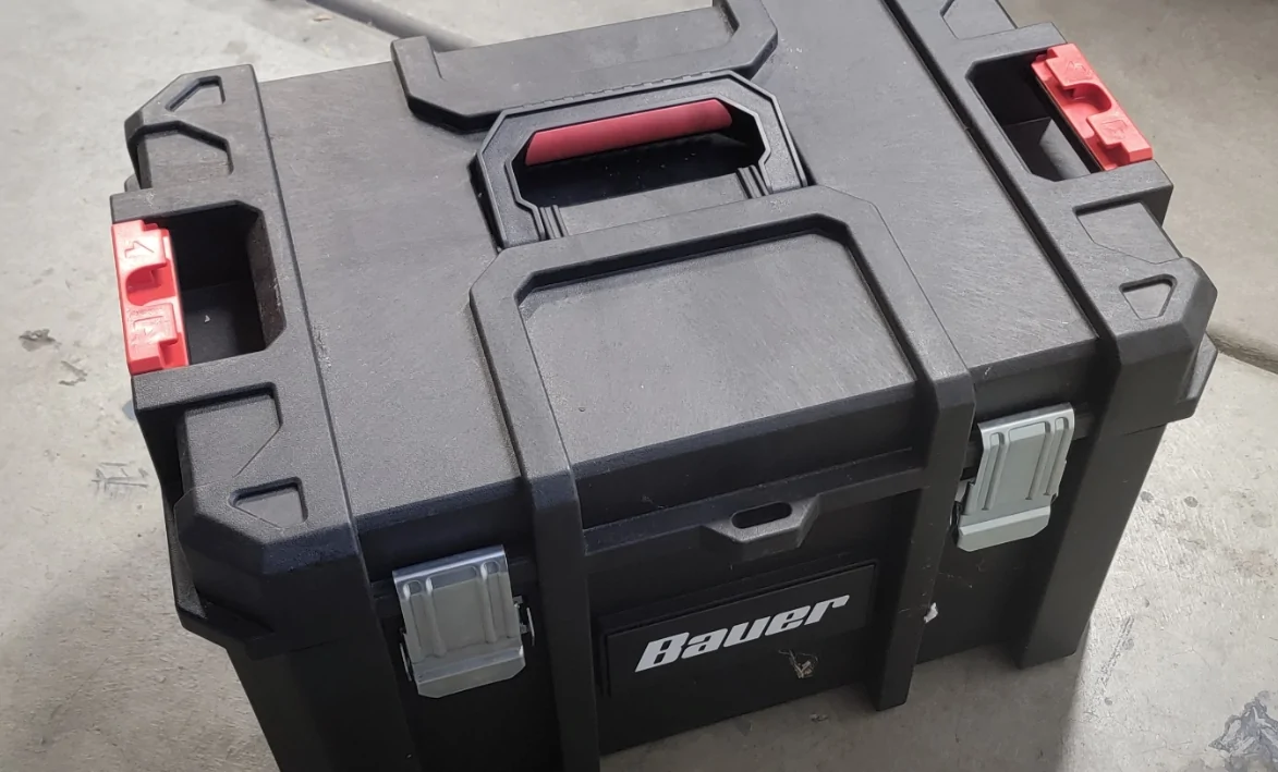

Yes it's not mounted in my engine bay or under my seat, but I like it, and the whole kit fits perfectly in one of these:

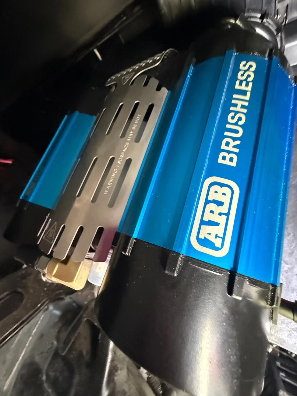

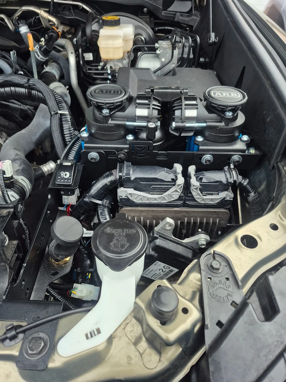

ARB twin, installed with a Zroadz bracket. I use the Morrflate 4 way airlines to air up and run of the mill deflators when I'm out off the beat and path.
Clean and effective for me
