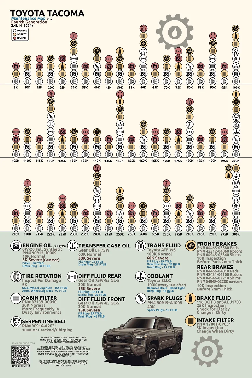

I'm sticking to the severe schedule:
2024 Tacoma 10,000 Mile Oil Change 1767585919601-4u
We all do stuff that falls under "severe" use, even if it's mundane like starting the truck cold to move it 200ft (happens sometimes) lol
The only variation I'm going to do to the schedule above is trans fluid at 30k instead of 60k.
