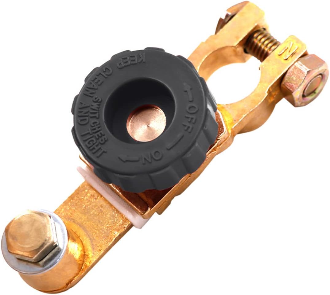

Something useful when going away for a time.
Yes. I can’t see it where it’d be useful on a daily driver. If you were not driving your truck for two or more weeks, then it’s a good idea.
