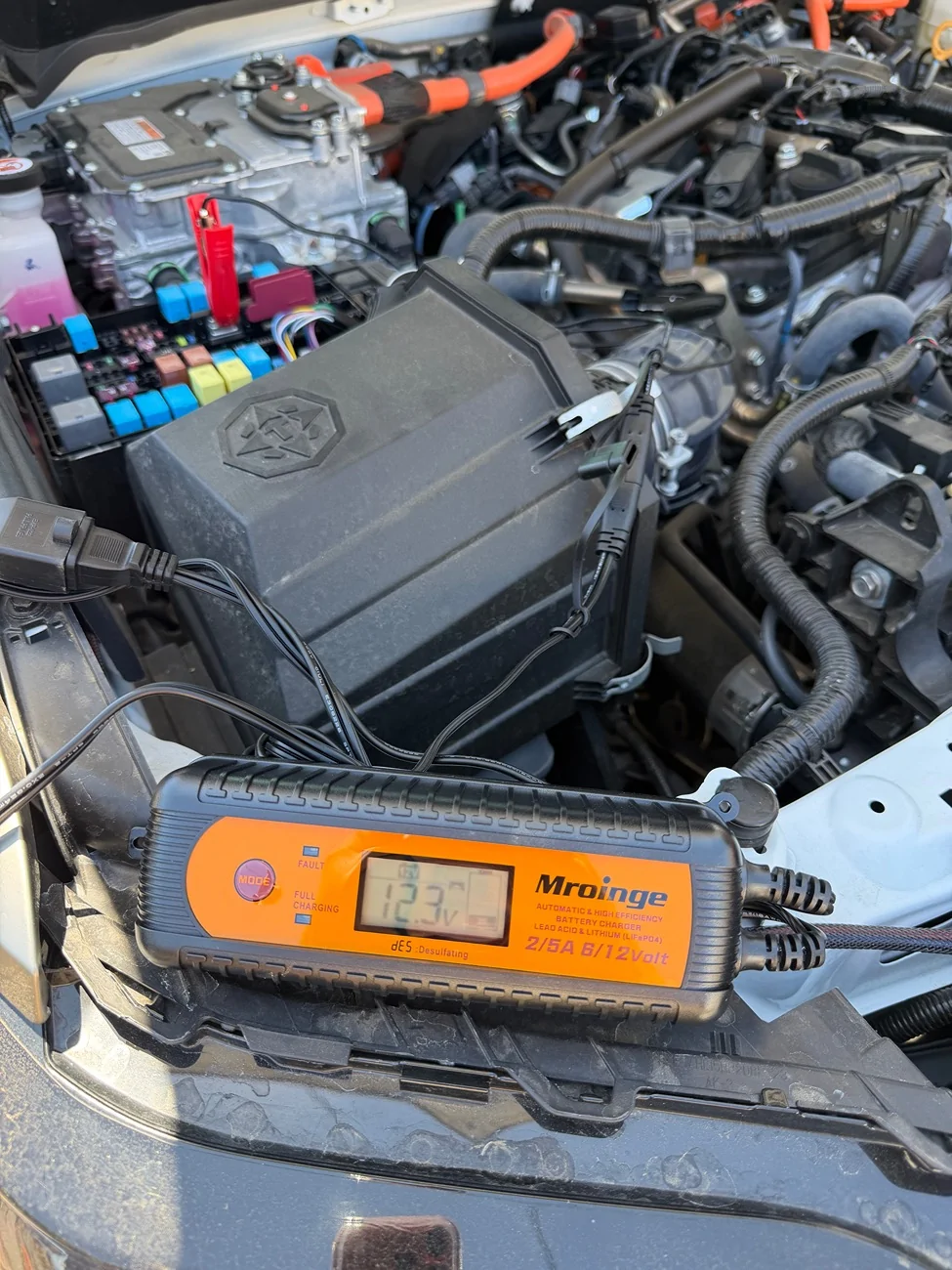

Good info, and it just confirms that we are more or less on our own with this. I work from home and my truck sits a few days every week. I check it and put on my battery maintainer when I know it has a couple of non drive days. That keeps my battery just below 12.5 volts, which is the 70-80% range. If I just drive it and treat it like a normal vehicle it usually sits at 50-60% charged or lower.
I don't like it, but this keeps it alive and I doubt that I will ever buy another Toyota hybrid. My wife's Lexus battery electric SUV is the same way and I usually have my maintainer on one vehicle or the other, which is really lame for two almost new Toyota products which cost over $120k.

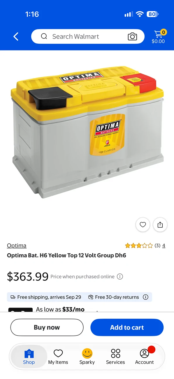

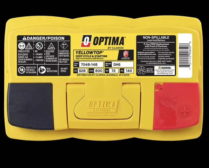

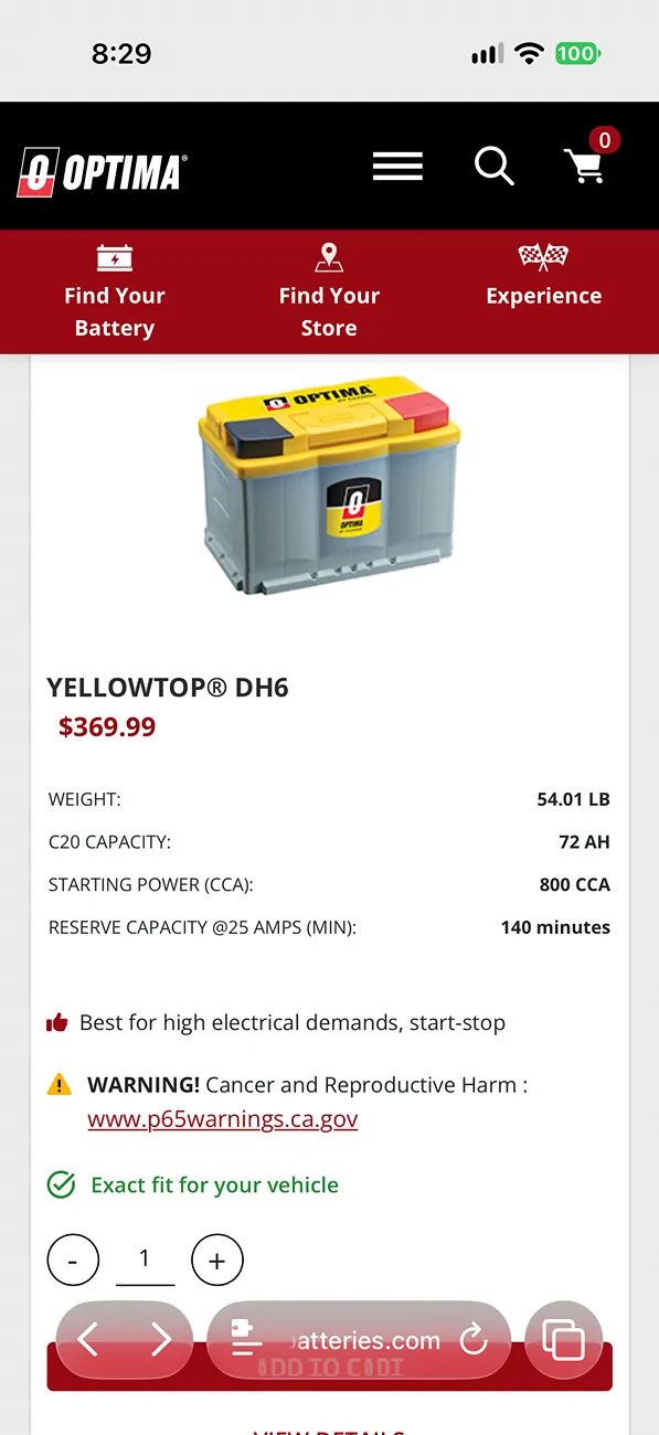

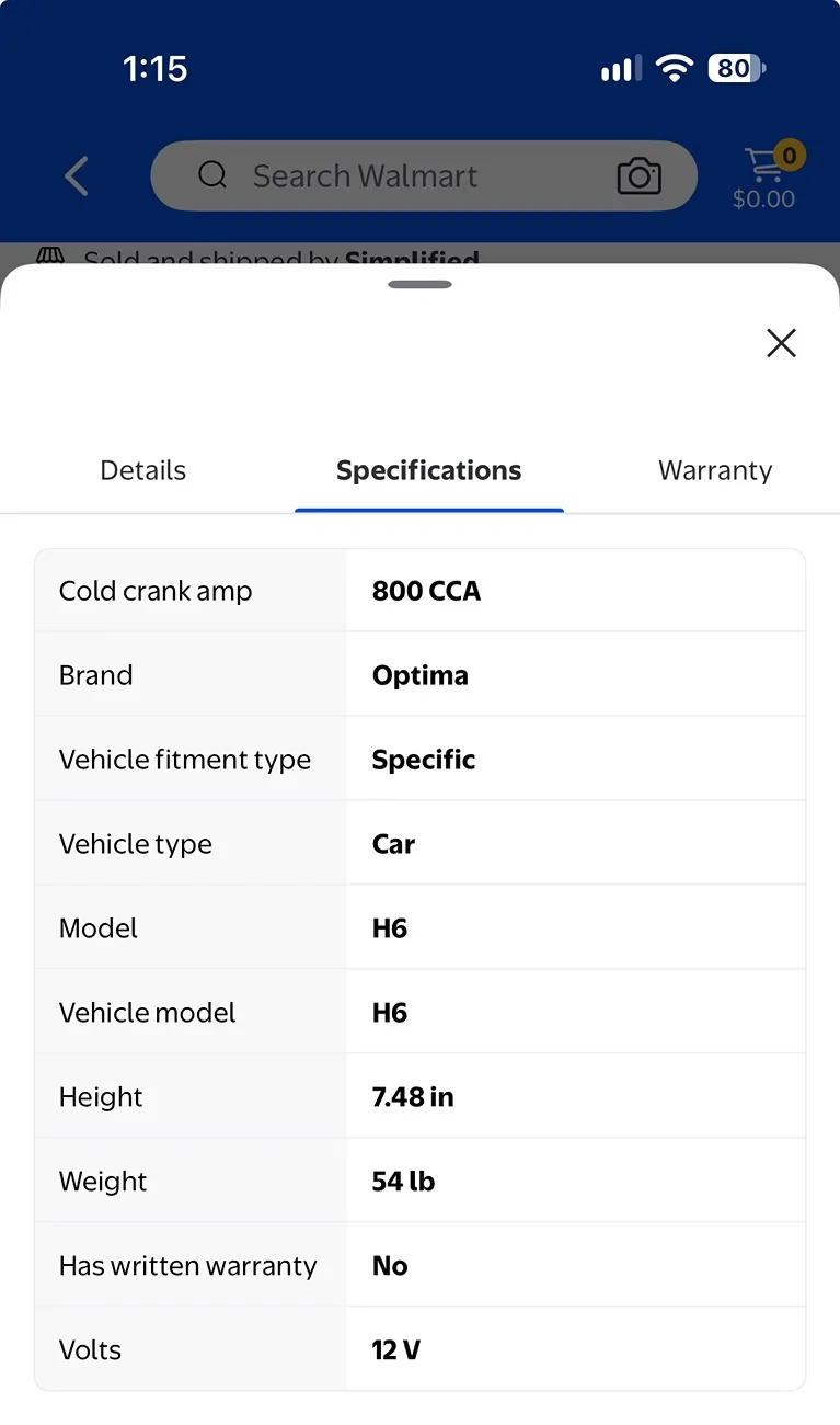

Update on my post in this thread about the Optima battery: We had to return the DH7 battery to 4WP to swap to the slightly less beefy DH6 model because of physical fitment. Price at the local 4WP was the same for either model. Walmart also sources from three resellers or you can order directly from Optima. I was glad I bought locally because returning the DH7 was easy.
Even though Optima’s website indicates that either the Yellowtop DH7 or DH6 will fit, the DH7 is too long by about an inch to fit the battery locking bracket at the bottom of the tray in my hybrid (placed under the back seat).
Pics: last time I had to recharge my dead OEM battery; DH6 batteries and specs.
We tested the DH6 simply by taking that HipCamp trip I previously mentioned, 3 hours away to the Lockwood and Paso Robles areas this past week. Had a great time and I didn’t feel battery anxiety. We continue to carry jump boxes in all our vehicles - always a good practice.

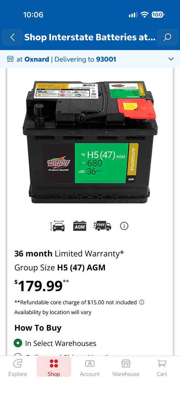

For your wife’s vehicle, if you want to think about putting in an AGM, this is what we put in my wife’s ‘24 Subaru with constantly weak and dead OEM battery. Her battery was 2 1/2 years old. We replaced with an Interstate AGM from CostCo (see pic). Cost $180 to $200 less than an Optima DH5, which would fit. The Optima is beefier but we don’t need 20 more CCA for that much difference.
Thanks, that is helpful and my wife loves to save money. :sunglasses:
She had an Infiniti SUV that killed its batteries on a regular basis and after it was out of warranty I put in an Optima red top. We had that car for years longer and it was fine. We bought a jump pack for it, but after the Optima was installed we never needed it again. My 2011 Tundra overcharged its battery and I was constantly cleaning battery acid up and eventually it ate the tie down strap. I put a yellow top Optima in it and problem solved. I quickly became a big Optima fan, even though the cost is crazy.
