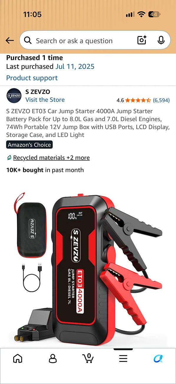

I also carry a jump box, but that battery was so dead dead, it wasn’t reviving. At least it wasn’t reviving with my Zeus pro. Going to carry a beefier jump box, but will have to keep it in one of the Roam boxes on the roof rack.
Been keeping this jump box behind the back seat. My rooftop Roam boxes get really hot and cold. I’d worry about a battery being happy up there.
S ZEVZO ET03 Car Jump Starter 4000A Jump Starter Battery Pack -- https://a.co/d/088v4WXG
