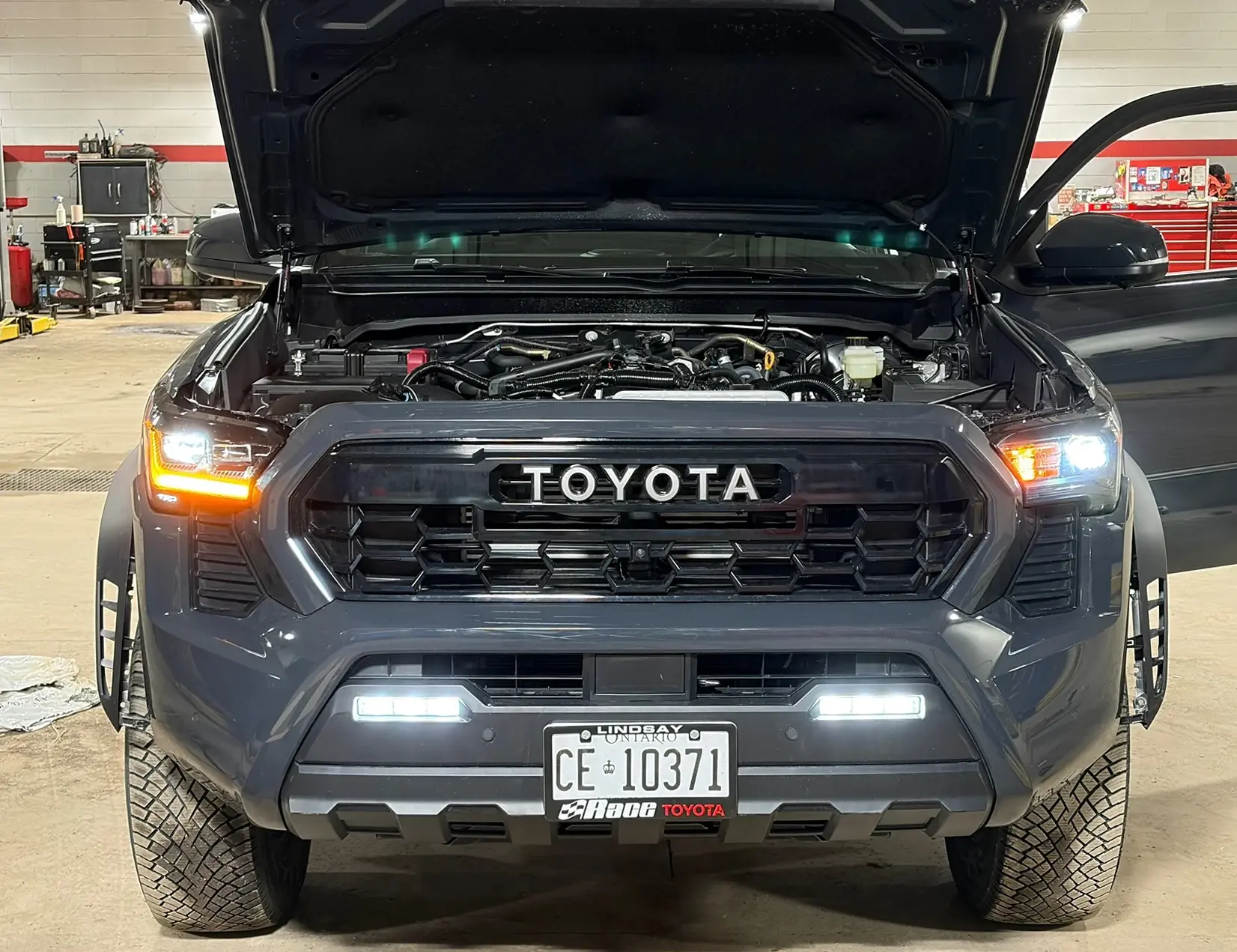

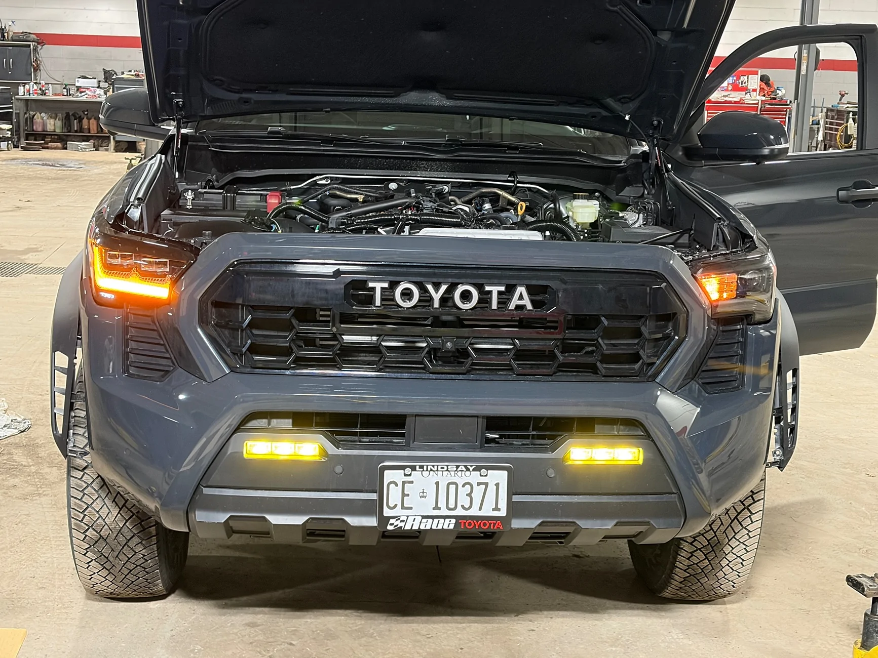

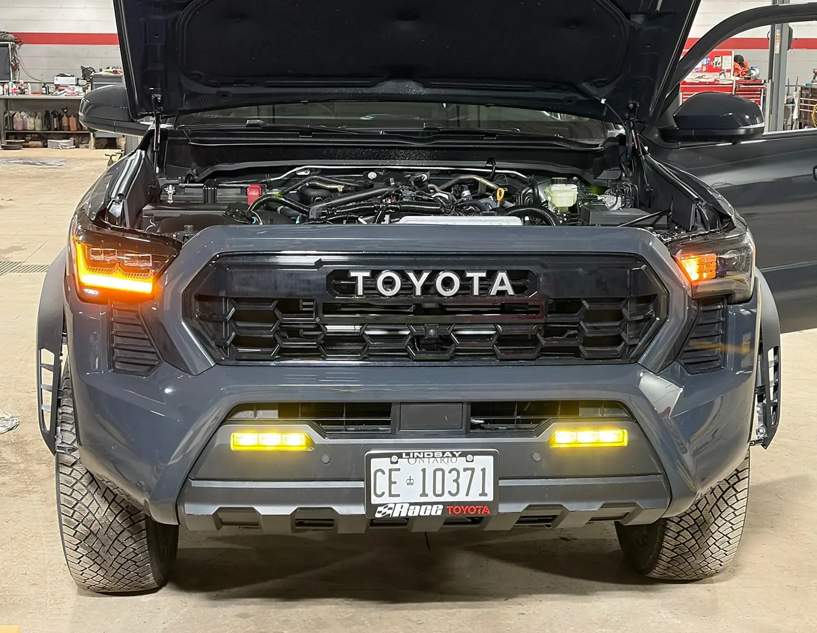

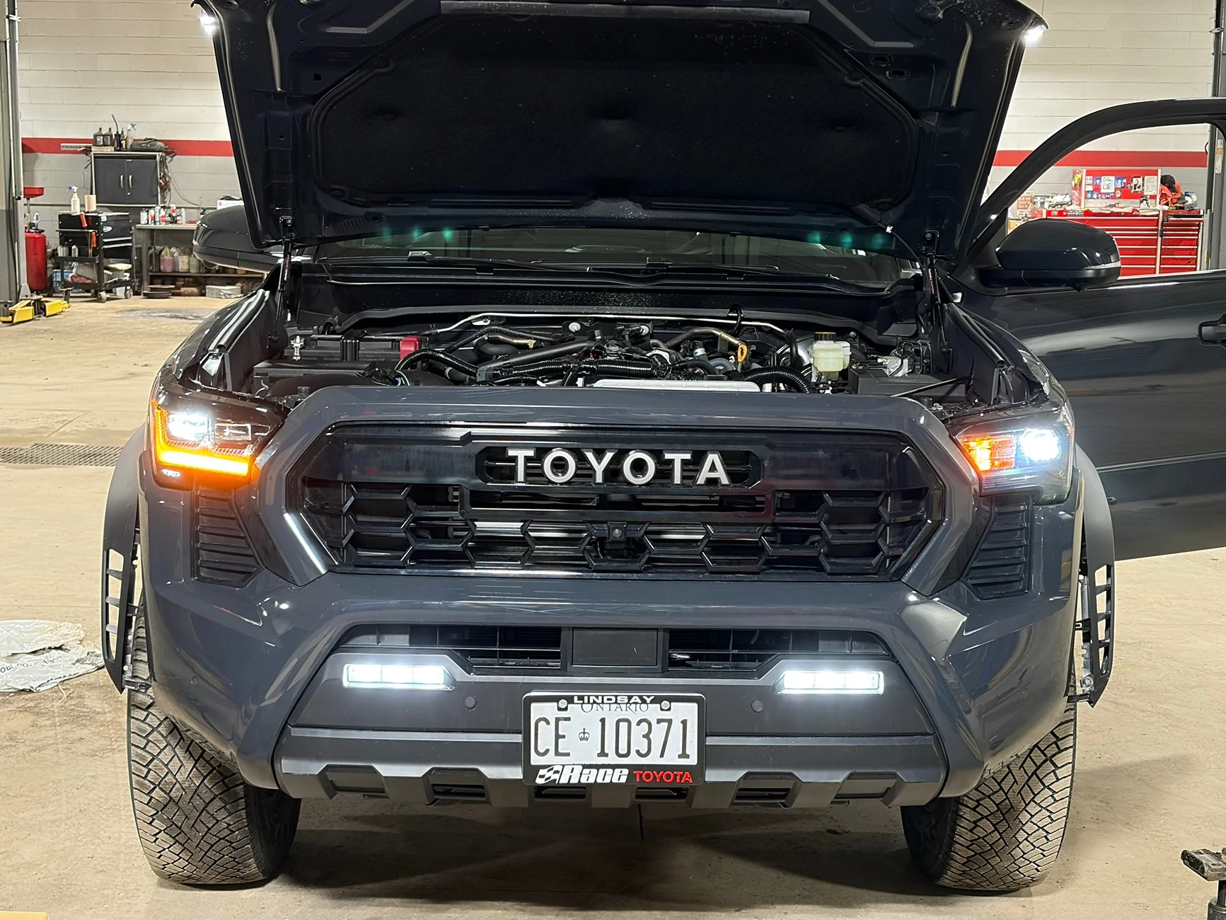

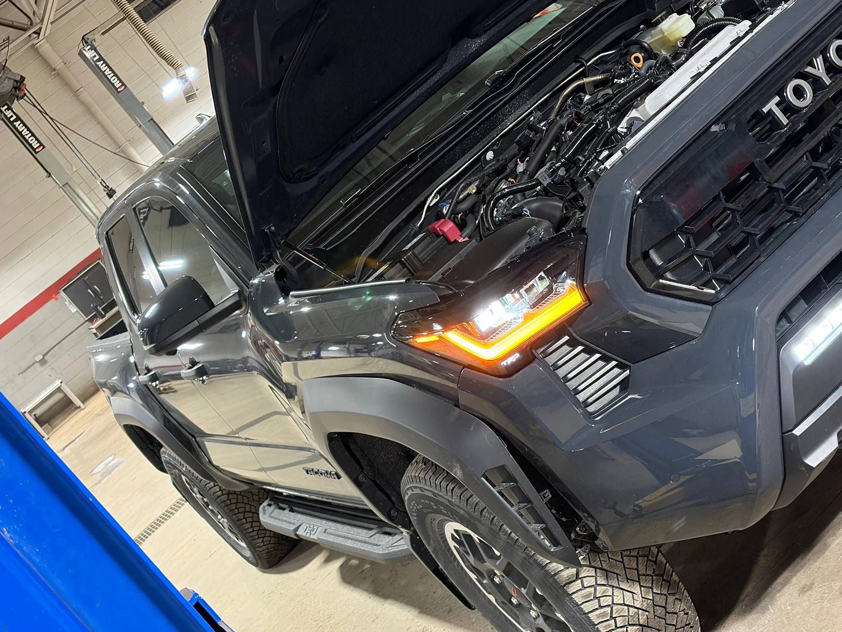

So as part of my build I wanted a better looking headlamp in my OR and fell in love with the 6G 4Runner TRD Pro lights with the amber DRL and dual projectors. After doing some digging I was pretty confident they would be plug and play and can now confirm they are 100% plug and play.
There is a dummy slot for the extra connector and everything mounts up in the exact same spots. You just lose the front bracket piece which I think just is an extra secure point for the fake air ducts.
Edited: You don’t have to have the lights leveled like I previously thought. The manual adjuster is just reversed on the 4Runner lamps so when I only had one installed it sat lower than the OEM lens as at 0 the OEM lens is at its highest while the 4Runner lamp is at its lowest. Once I put the second lamp in I actually prefer it this way. Having the higher number be the highest light level setting makes more sense to me.

Did you need a 4Runner wiring harness or was it plug & play with the factory Tacoma harness? I really dig the look. Nice work šŸ‘ŒšŸ¼

So you lose one of the best functions of the OE lights in the wheel to adjust the light level AND paid a bunch to do that. Crazy times we live in.
What? No you don't lose that at all. The new lights just need to be properly adjusted to correct height first and then will work as intended. The aim adjusting wheel just doesn't bring them up high enough first.
Nope no harness is required. They use the exact same connectors between the two models. Main power plugs into the same spot, headlight levelling motor plugs in the same spot and if you have a lower trim with the halogen turn signals that connector plugs into the dummy connector on the back of the lamp.
Gotcha. Misread that. I thought the wheel was no longer working. If is my favorite part of the lights as in winter I add sandbags to the back and my lights have to be adjusted.
Yea I wouldn't do this upgrade if I lost functionality of that šŸ˜…. I tow quite a lot and it really helps keep the lamps pointed where they need to be.
