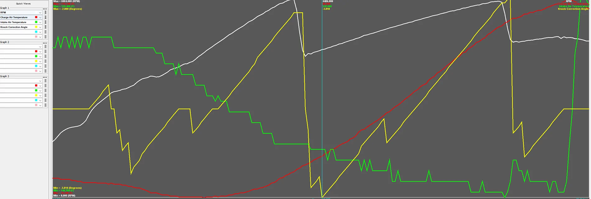

To go one step further from above, here's an example of a data log with limited parameters shown:
  • Intake air temperature (at the intake and at the manifold)
  • Engine speed
  • Knock correction angle
you can see the knock correction angle (yellow line) moves around -3, dips, then climbs to close to -2, but it also dips down to -3.8 on shift. The way to read this is to follow the RPM scale (white line) to where it peaks and then drops off, and that indicates a shift point.
The KCA in this log is what would be considered normal and would not be cause for concern.

What To Do This Week
If you notice throttle movement in a log, look at it in context:
  • Throttle angle vs pedal position
  • Gear
  • Intake Air Temperature
  • KCLV and KCA trends
Single events don’t tell much.
Patterns do.
