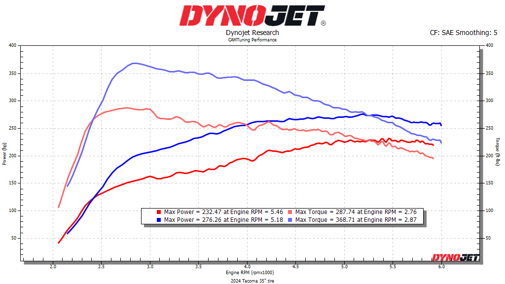

Session 6: Rotating Weight: Why Bigger Tires Feel Like Lost Power (and How Tuning Gets It Back)
Let’s take a quick break from sensors, trims, and tables and talk about something you can feel immediately behind the wheel: rotating weight.
Earlier this week I had a Tacoma on the dyno running significantly heavier tire and wheel combo than stock. No engine changes. Same truck. Same dyno. The only variable was rotating mass.
(These tires are ~65lbs each, on factory wheels)
The baseline result was exactly what you’d expect:
  • Lower measured power
  • Slower acceleration
  • A drivetrain that had to work harder to do the same job
But here’s the part most people miss.
That “lost power” isn’t gone — it’s being used.
Why rotating weight matters more than vehicle weight
Rotating mass (tires, wheels, driveshafts) doesn’t just need to be moved forward — it has to be spun. That means:
  • More torque required to accelerate
  • More load on the engine and transmission
  • Slower rate of RPM change
  • Heavier demand during shifts
This is why trucks often feel:
  • Sluggish after tire upgrades
  • Lazy to downshift
  • Less responsive at part throttle
What the dyno showed
Despite the heavier setup, once calibrated correctly:
  • Torque gains were equal to—or better than—stock-tire trucks
  • Throttle response improved noticeably
  • The power curve became smoother and more usable
2024 Tacoma Tuning Facts - Understand Your Truck Like We Do at CAMTuning 2024 non  hybrid tacoma 35i
The tune didn’t “add magic horsepower.”
It reclaimed efficiency that the stock calibration wasn’t designed to preserve with heavier rotating mass.
OEM calibrations are built for factory tires.
Once you change that equation, the strategy needs to change too.
The takeaway
Big tires don’t ruin performance — unaddressed calibration does.
When torque delivery, throttle behavior, and shift strategy are aligned for the added rotating mass, the truck stops feeling heavy and starts feeling intentional again.

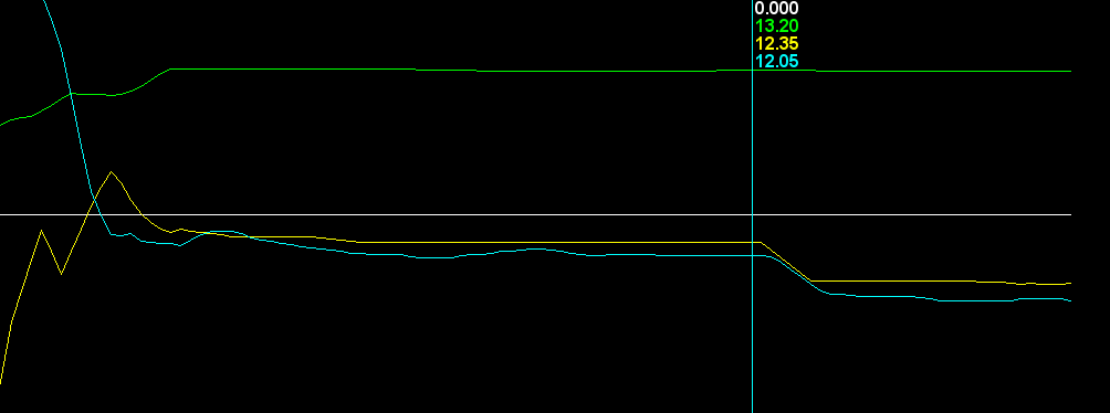

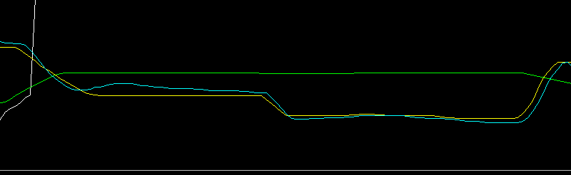

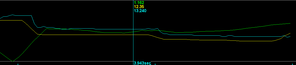

Session 8: Pulling these concepts together, and what to monitor on your Cobb Accessport
If you’re running a tuned 4th Gen Tacoma / T24 truck, your dash should give you context, not anxiety. Here’s the clean setup I recommend:
1. KCLV (Knock Correction Learn Value)
This is your long-term knock learning value.
It shows how the ECU is adapting over time based on fuel quality and operating conditions.
You’re not chasing a perfect number — you’re watching for stability.
If it lives in a consistent range and behaves predictably, that’s healthy.
Sudden sustained changes are what matter.
2. Knock Correction Angle
This is real-time knock response.
You will see small corrections. That’s normal closed-loop strategy.
Important reminder that:
-3° = effectively 0.
Seeing -3 doesn’t mean you’re “losing 3 degrees.” It’s essentially baseline behavior.
What you’re watching for isn’t small blips — it’s repeated, large corrections under steady load.
Trends > single events.
3. Boost
Keep it simple. Just boost.
Know what your truck normally makes in:
  • 3rd gear
  • 4th gear
  • Typical temps
Toyota torque targeting means boost isn’t just a “max PSI” number — it changes based on load and conditions.
If you know what’s normal for your truck, you’ll instantly spot when something is off.
4. Charge Air Temp (Post-Intercooler)
Not generic intake temp — charge temp.
This is the temperature of the air the engine is actually ingesting after compression and intercooling.
This directly affects:
  • Ignition timing
  • Knock sensitivity
  • Torque consistency
If charge temps climb, the truck may feel softer — even if nothing is wrong mechanically.
5. Long Term Fuel Trim
This is one of the most underrated parameters.
Stable trims = sealed system, healthy airflow modeling.
Sudden swing = possible boost leak, vacuum issue, or MAF contamination.
It’s an early warning system.
What I don’t recommend:
  • Staring at AFR constantly
  • Chasing peak boost numbers
  • Turning the Accessport into a stress device
The goal isn’t constant monitoring.
It’s knowing what’s normal.
Once you understand your truck’s patterns, you’ll recognize changes early.
What are you running on your dash?

Session 12: Airflow Numbers, Intakes, and Why Some Gains Don’t Stick
On a MAF (mass air flow) -based system, airflow is not directly measured mass in a perfect sense—it’s calculated based on what the sensor reports and how it’s calibrated. Change the housing, change how air passes over the sensor, and you can change the reported airflow without actually changing how much air the engine is ingesting.
A larger MAF housing or different flow path can cause the sensor to underreport (or overreport) airflow. The ECU thinks less air is entering than actually is, so it commands less fuel. That creates a lean condition—more air relative to fuel—which will often feel stronger right away.
That “feels faster” moment right after installing an intake is often not additional airflow. It can just the engine being under-fueled.
Over time, the ECU fixes it. The oxygen sensors see the lean condition and the ECU starts adding fuel through fuel trims to bring the mixture back to where it should be. Long-term fuel trims learn that correction and carry it forward, so even under load (open loop) the system trends back toward the commanded AFR.
Let's review some real data from customer vehicles.
Right after install:
LTFT near zero
Reported airflow may look lower, because the way the air is crossing the MAF has changed.
Actual AFR is leaner than commanded
Fuel Trims (green) 1-3%, but AF desired (yellow) is richer than actual (blue)
2024 Tacoma Tuning Facts - Understand Your Truck Like We Do at CAMTuning 1774451599019-df
After some drive time:
Total fuel trims (mostly long term in this case) goes positive (adding fuel)
Commanded AFR and actual AFR line back up
“Extra power” goes away
Fuel trims (green) ~13%, but AF desired (yellow) and actual (blue) are well matched:
2024 Tacoma Tuning Facts - Understand Your Truck Like We Do at CAMTuning 1774451566328-7
Properly calibrated fueling *after revision based on data logs- this is a real customer of mine, tuned remotely.
Fuel trims near 2% (green), AF desired (yellow) and actual (blue) well matched:
2024 Tacoma Tuning Facts - Understand Your Truck Like We Do at CAMTuning 1774451542064-kk
This is why airflow comparisons between intakes can show misleading data. If the MAF scaling isn’t correct, you’re not comparing airflow—you’re comparing sensor interpretation, and the engine running conditions are not a direct comparison.
Real gains from an intake come from reducing restriction pre turbo and improving how easily the turbo can move air. But if you see an immediate jump in performance without calibration changes, you need to wonder whether it’s actual airflow… or just a measurement shift.
Here's the key takeaway: airflow data only means something if the MAF is calibrated correctly.
