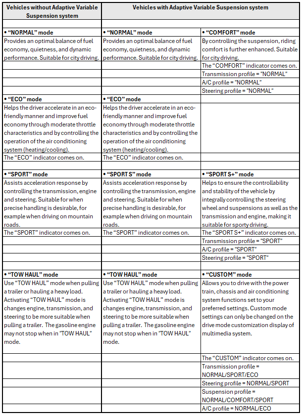

An observation about modes, eco mode appears to go deeper than just switching tables. If you turn your heat or A/C on high and switch from eco to any other mode, there is an observable increase in fan speed. I would assume that it does that to reduce overall load for fuel economy. I have been meaning to go test charging voltage to see if it's doing it by reducing overall voltage or if it's isolated to the blower motor.
It's been on my todo list for a bit to do some testing to see if there's any more differences than can be observed. Like sticking a camera in the grille to see when and how the shutters operate and things like that. I've never owned a vehicle as complex as these trucks and find it fascinating.
Only Normal/Comfort will restore automatically if the truck has been turned off for more than 10 minutes. Otherwise,

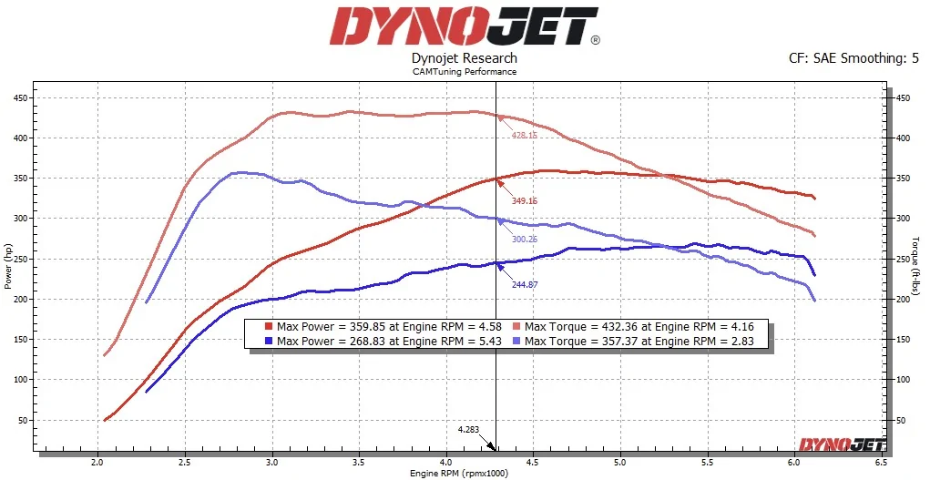

Here's an example on my personal truck on 91 (stock) vs an E30 blend. This is with an intake and intercooler as the only 2 modifications:
2024 Tacoma Tuning Facts - Understand Your Truck Like We Do at CAMTuning SXTH e30
In the limited trim, it allows you to customize your drive mode. You can mix ECO/NORMAL/SPORT engine response, suspension mode COMFORT/NORMAL/SPORT+, Steering set to NORMAL/SPORT+, and ECO/NORMAL Climate control. So what you're noticing is true, and on the limited trim you can select which Climate control profile you want to use. ECO being the more conservative use of the air conditioner system.

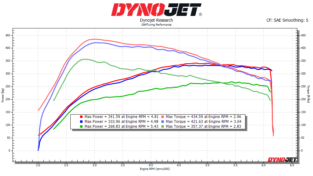

Green- stock truck
Blue- Intake, intercooler, stock downpipe, tune
Red- Intake, intercooler, FaF downpipe, tune
2024 Tacoma Tuning Facts - Understand Your Truck Like We Do at CAMTuning downpipe vs stock vs stockdownpipe

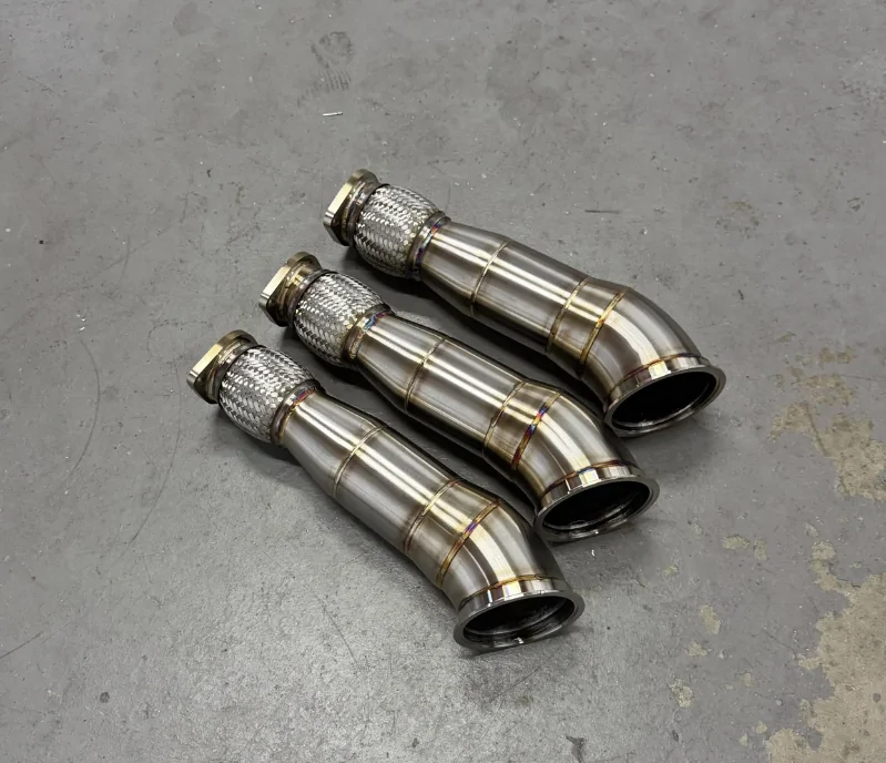

The highest quality, hand built in the USA downpipe is sold here:
FAF Race Downpipe
