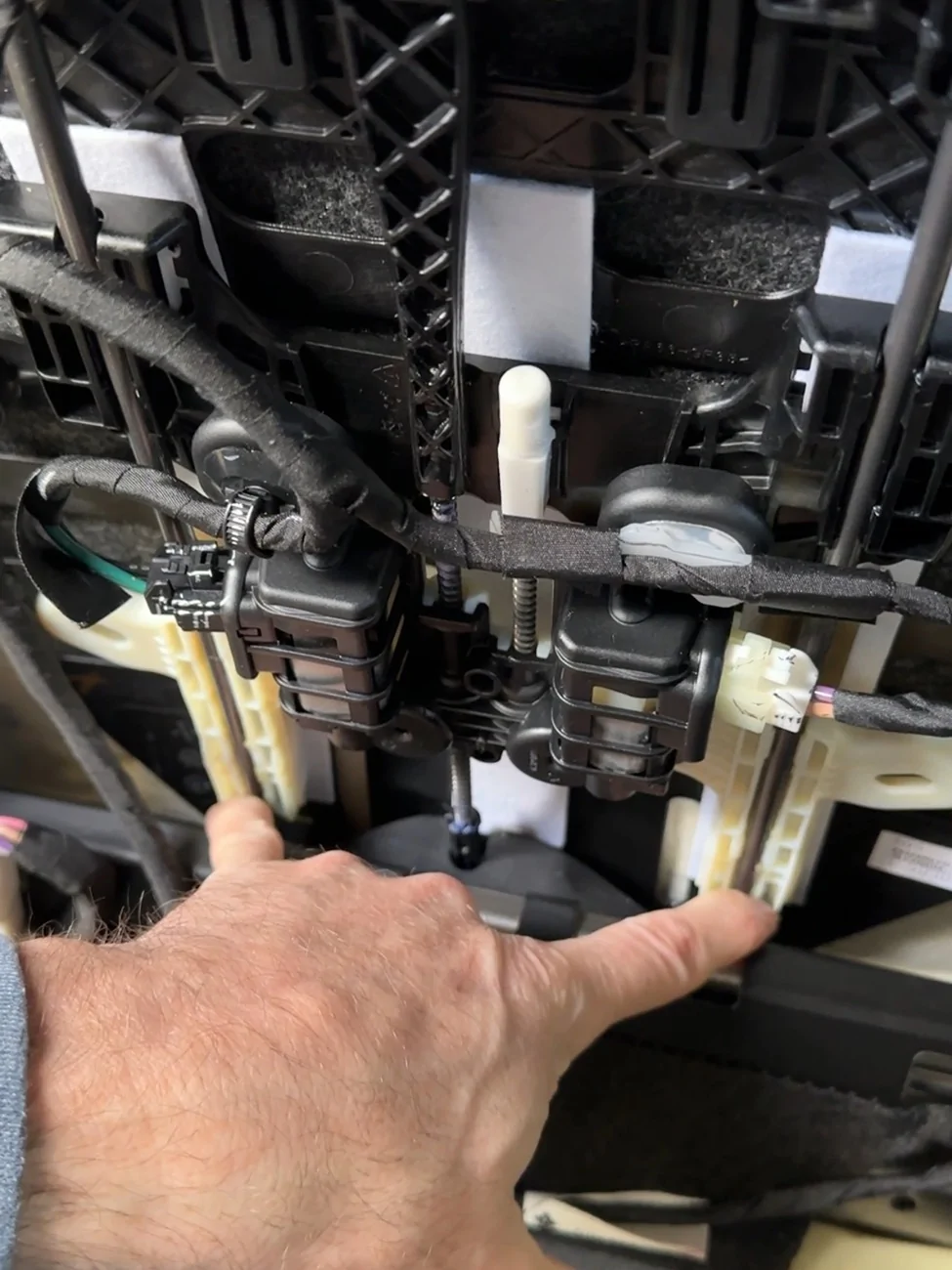

The rails of the lumbar mechanism that carry the vertical adjustments shift forward and back. Unzip the seat cover (first undo the elastic hoops underneath the seat that secure the lower flap) and you’ll find that whole mechanism is loose when you apply some push/pull. I added a 6-7” long piece of thick pvc foam cut to fit between the rails and the plastic frame - where my fingers are. I’ve seen people use wine corks or whatever you have available as long as it is snug enough to eliminate the play. Hope this helps!
Awesome thank you for finding this out! If the dealer doesn’t want to do this on my next service I’ll take matters into my own hands. Doesn’t seem like they have a true fix for this.
Hell yeah man. My guess is they won’t do anything. Took me 10 min to do. Hardest part was undoing the elastic hoops underneath lol. Just so happened to have so leftover foam and it did the trick.
Yeah I’m sure I’ll be doing it. I have taken those hoops off and they are a little annoying lol
