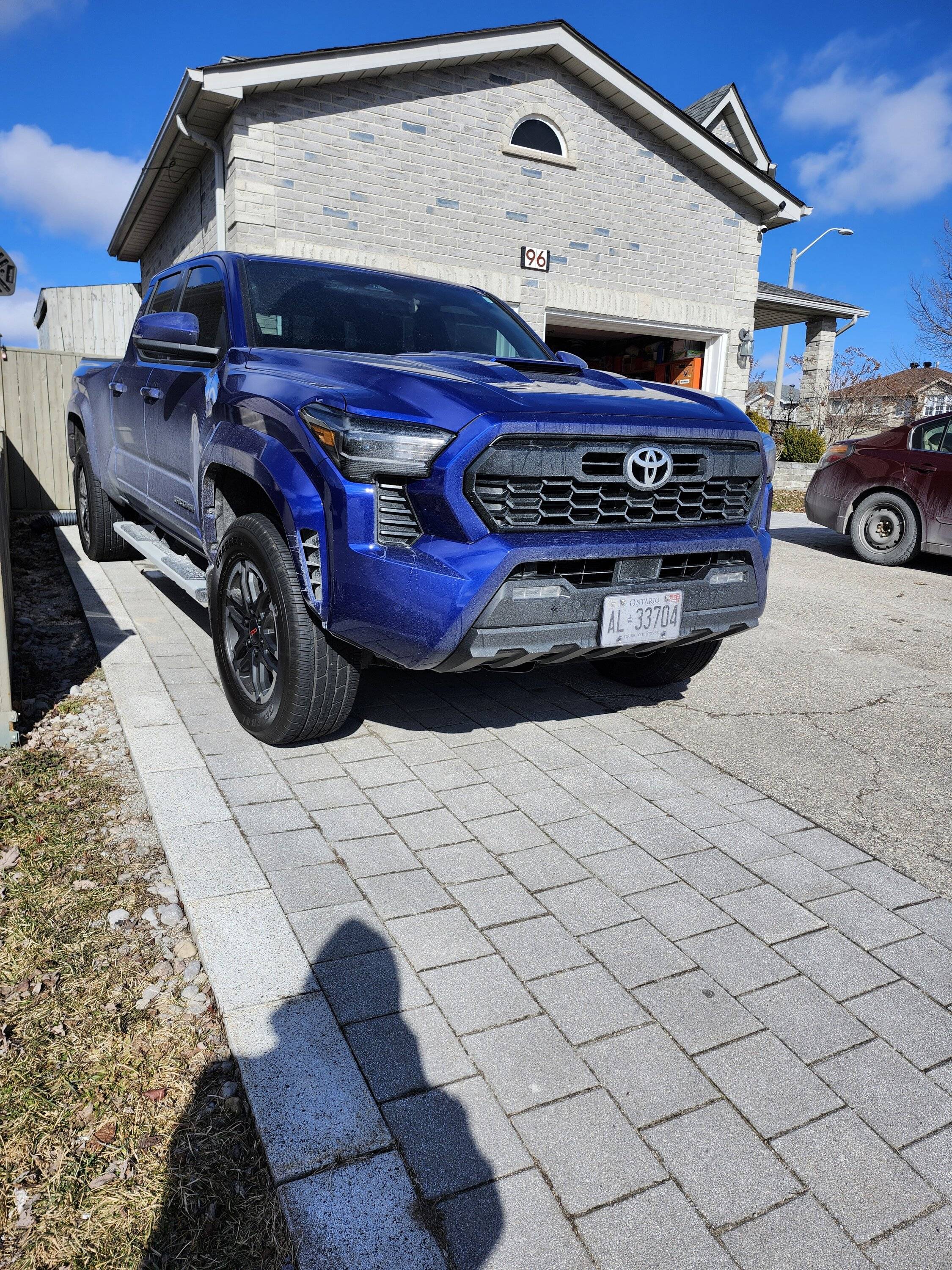

I removed my air dam chin spoiler and it is very easy (took about 45 seconds with cordless drill and 10mm socket) there are 9 easily accessible fasteners.
Mileage wise I don't expect to see very much difference. TFLTruck noted a .5 mpg difference I believe.

Looks good! What’s hanging down below the front bumper (on either side of the license plate) in the straight on picture?
That is the fake skid plate. It's made of some sort of Fibreboard it looks like. The off road would have a thin metal skid plate. The sport is like this. Still debating what to do there.

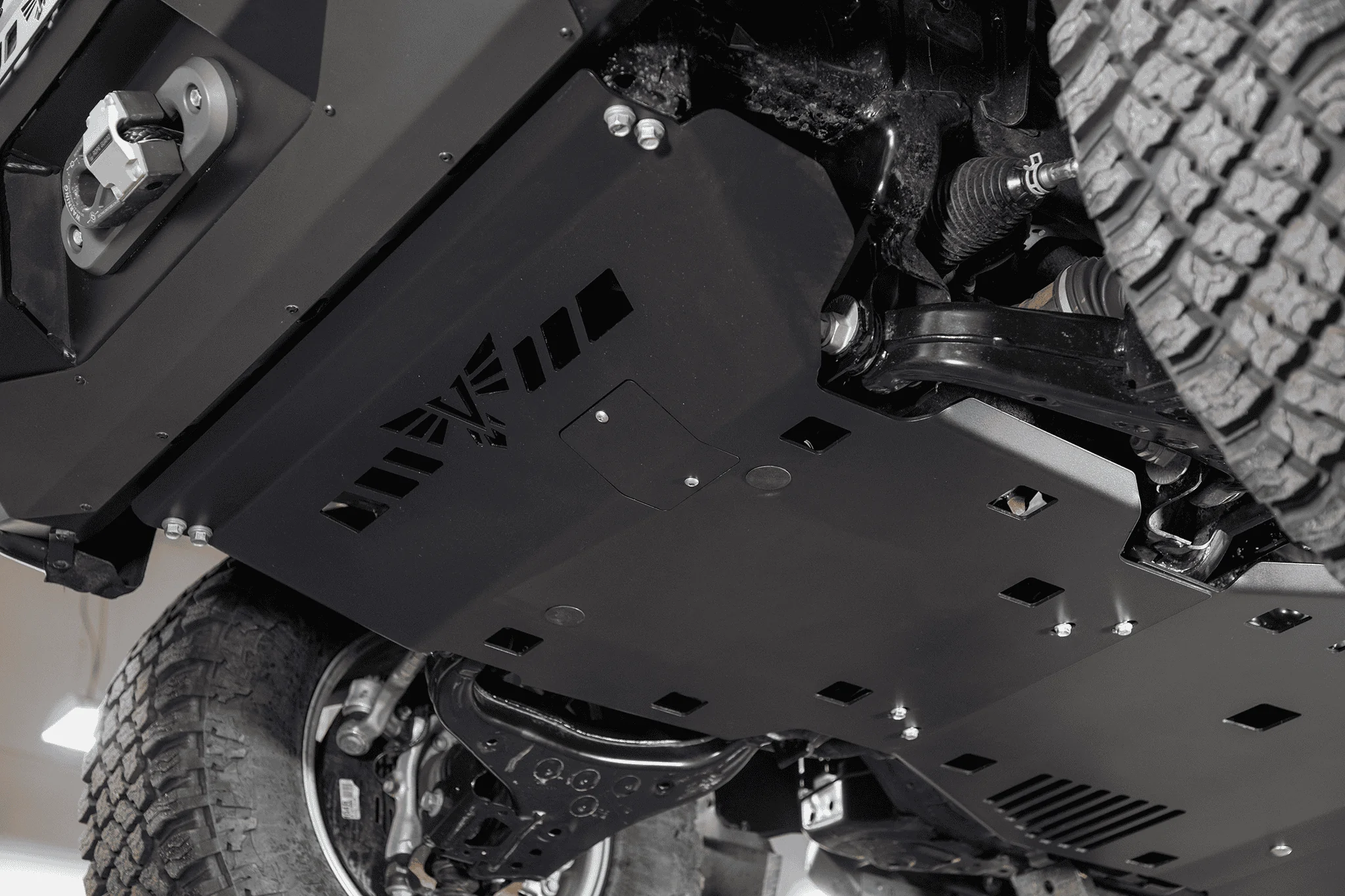

Looks like Victory 4x4 and Krave Automotive have skid plates now. They might not fit your requirement of not crazy expensive.
I’m looking as well after seeing the photos of the dam being removed.
