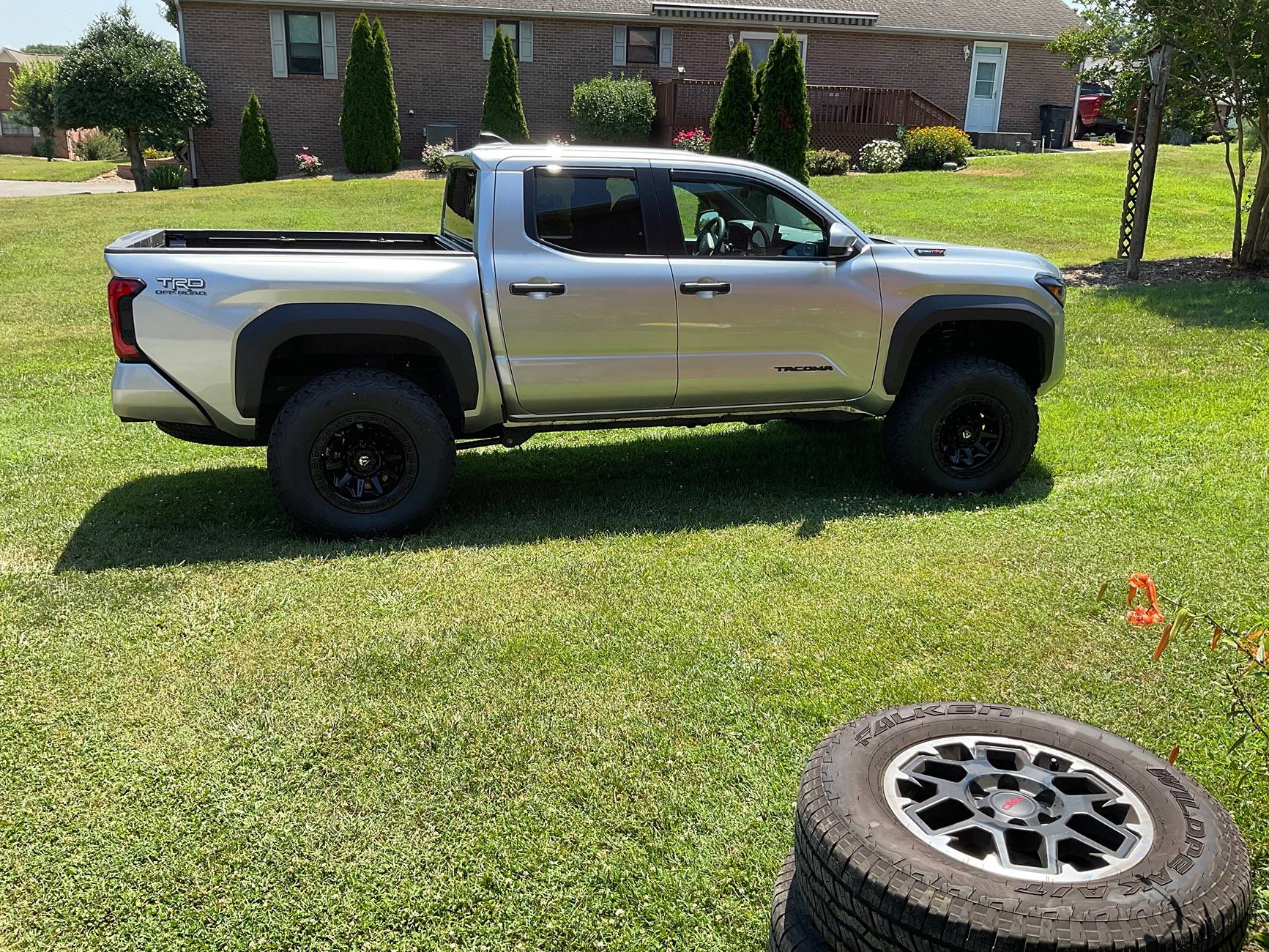

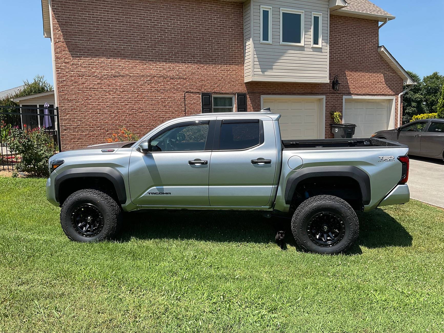

24 off road hybrid
wescott pre collar lift
nitto 285/70/17 = 33” tire
RRW RS2-H
Wheel 17 x 8.5
Offset 25mm
2024 Tacoma 4th Gen 2024+ Tacoma Aftermarket Wheels & Tires Pictures / Specs Compilation - Add Yours IMG_4655

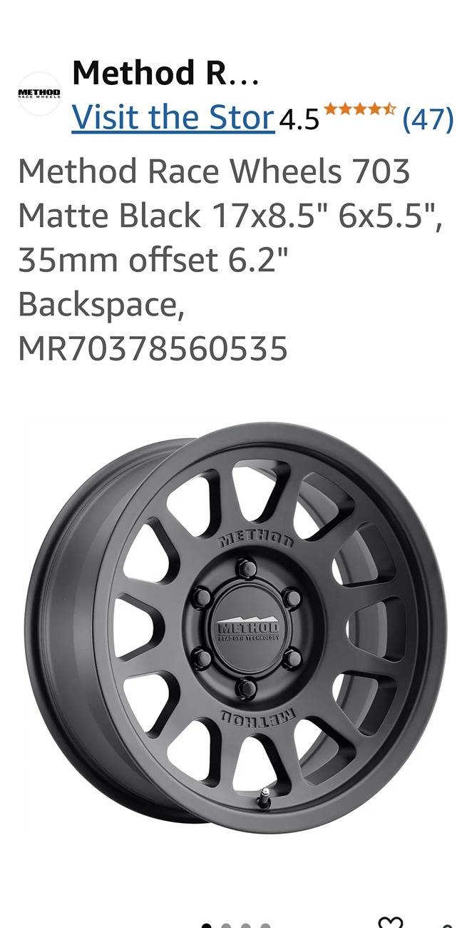

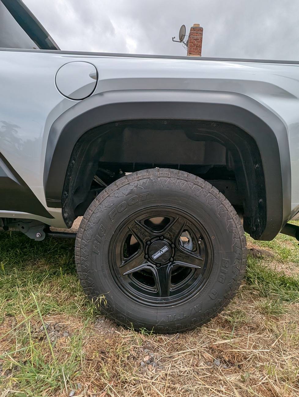

Hey guys I'm trying to order Method wheels and it's hard to get a decent price on shipping of course there's always Amazon... Will these fit my Off road... Sorry to post here but I'm confused because I was looking for 703's
+35 offset
6x139.7 this says 6x5.5? I'm definitely no expert at wheels or tires... Thanks. Also backspacer not sure what that means either ?

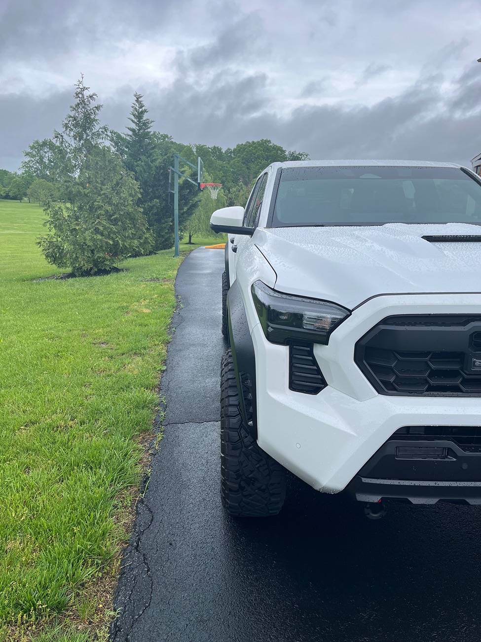

nice wheel , i got 319's same size
fits great came with spacers but BigO guy says they didn't fit & were not needed
1 1/2" poke

Hey guys sorry for the dumb question but I just orderd my Method 703's and was told to get part# MR70378560535
I just noticed it will have a different hub center size cause the 4th gen tacoma says 95mm or something... Is this a problem... I'm sure there are adaptors/rings... I didn't see before I orderd I just assumed it would fit... Did most you guys order 95.1mm? Or is this normal for aftermarket wheels to have a big hub bore?
Some say it does some say it doesn’t? It’s easier to mount the wheels with the correct bore diameter, the lugs carry the weight when torqued, I don’t think it really matters? If you’re concerned get the rings.
did u order the matching lug nuts ?
Yes I orderd the lug nuts but didn't know it was a different size hub.... Obviously I know nothing about aftermarket wheels... Thanks...

my Method's came with black plastic rings , but when i had them mounted BigO Tires said not needed & didn't fit anyway
i was like u i ordered the wheels not knowing much about poke ,offset as i once did back in my motorhead times
THANK YOU... Damn feel alot better now I was freaking out because I paid $300 shipping and didn't want to pay to return them... Appreciate the help!

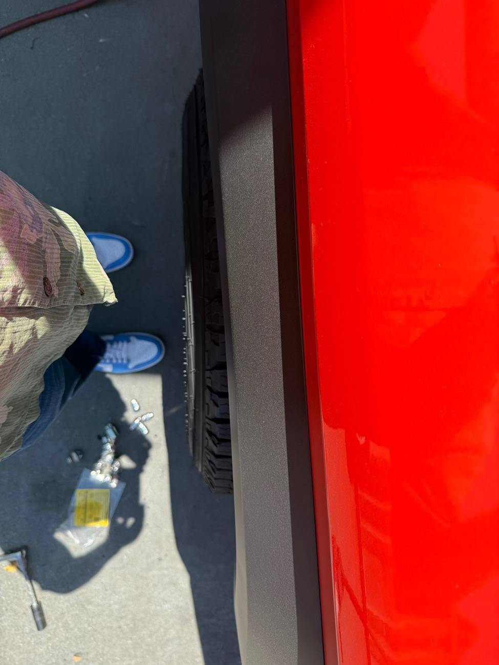

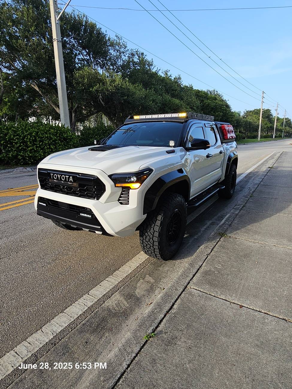

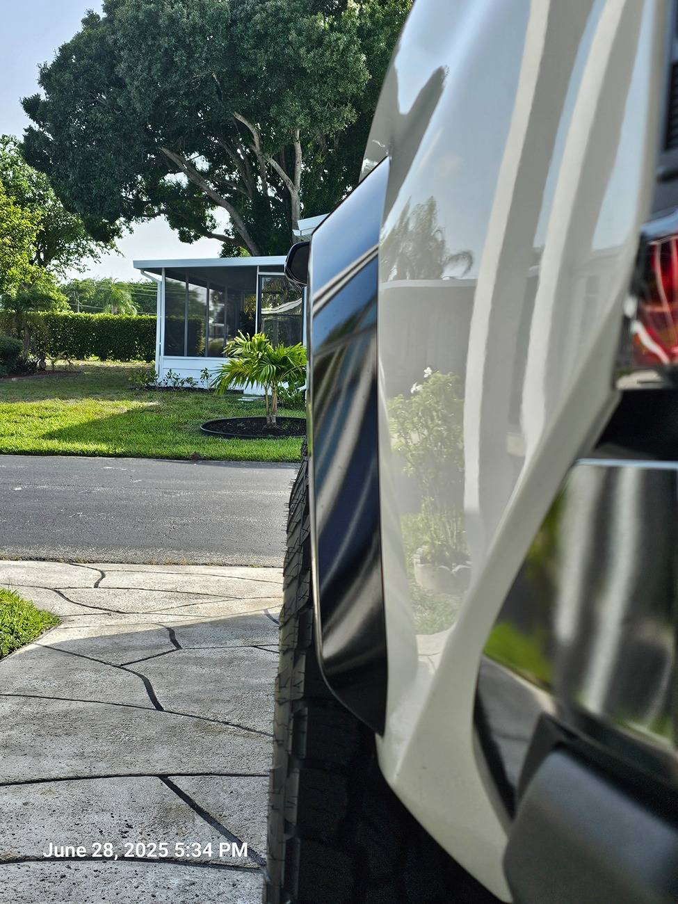

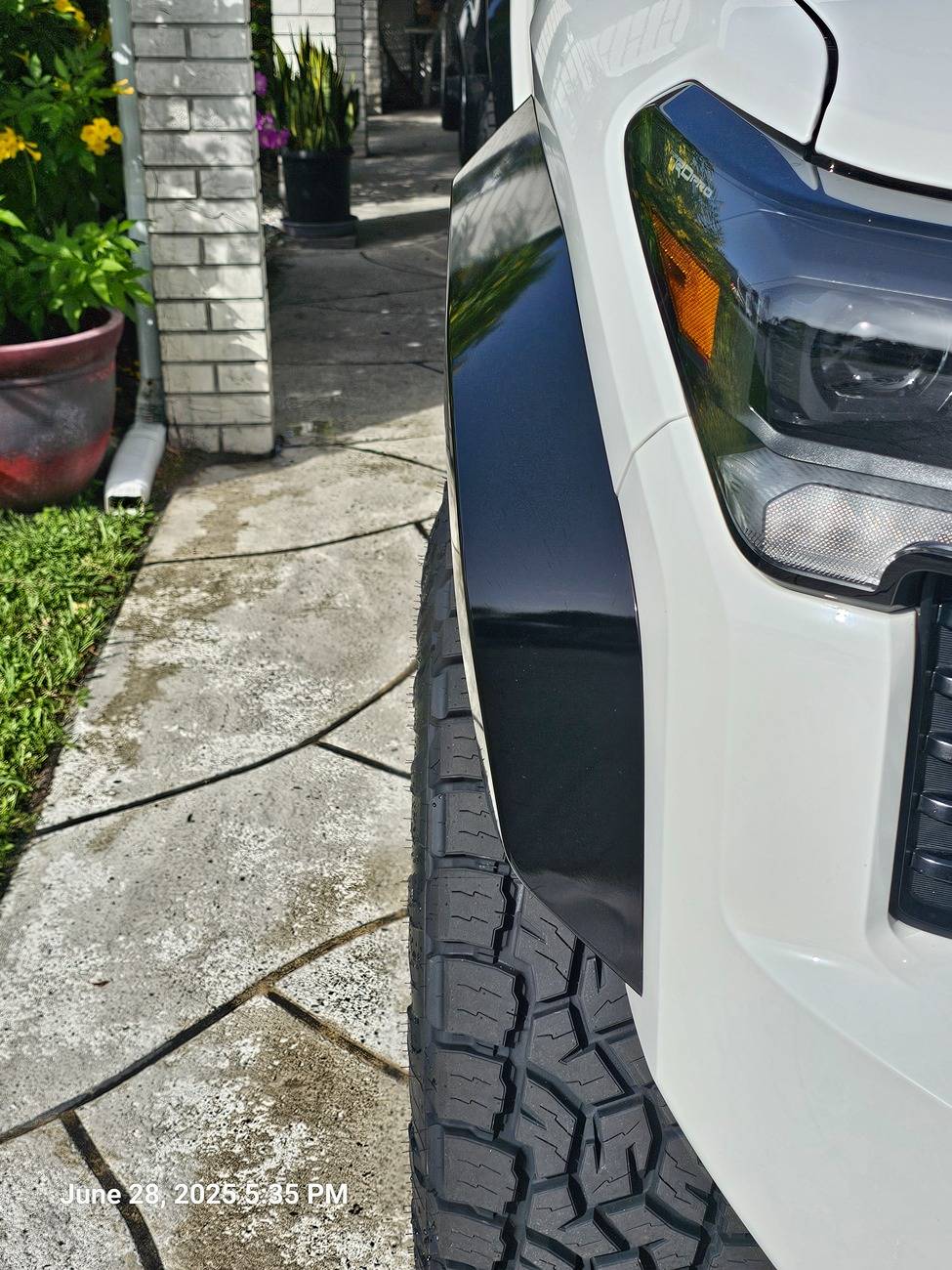

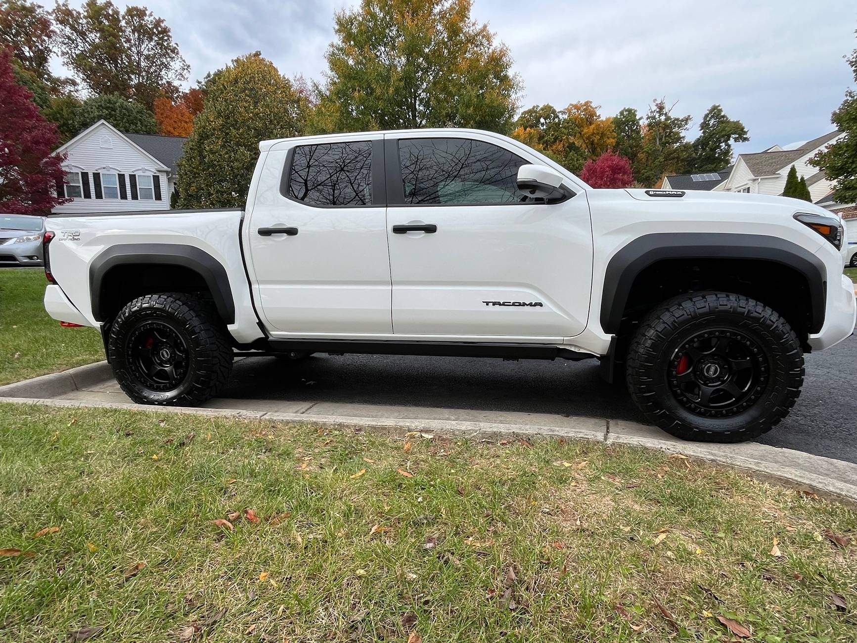

Thoughts on this build as far as offset goes?
Planning to buy these same Seibon fender flares and it looks as though they extend out further than stock TRD OR (the model I have on order). Im thinking a +25 offset might look a little odd with flares that extend out this far unless Im missing something. Im not sure what the offset is... possibly 0 or maybe -10. I assume this would require some trimming if running a 35" tire.
Love this stance however so Im trying to find out what I can if anyone knows or has any ideas. Thanks.
Yes Seibon flares are more than the OR ones. You would want more aggressive fitment wheels for that. Let us know, we can help with the Seibon fenders, got them in stock.
-Josh

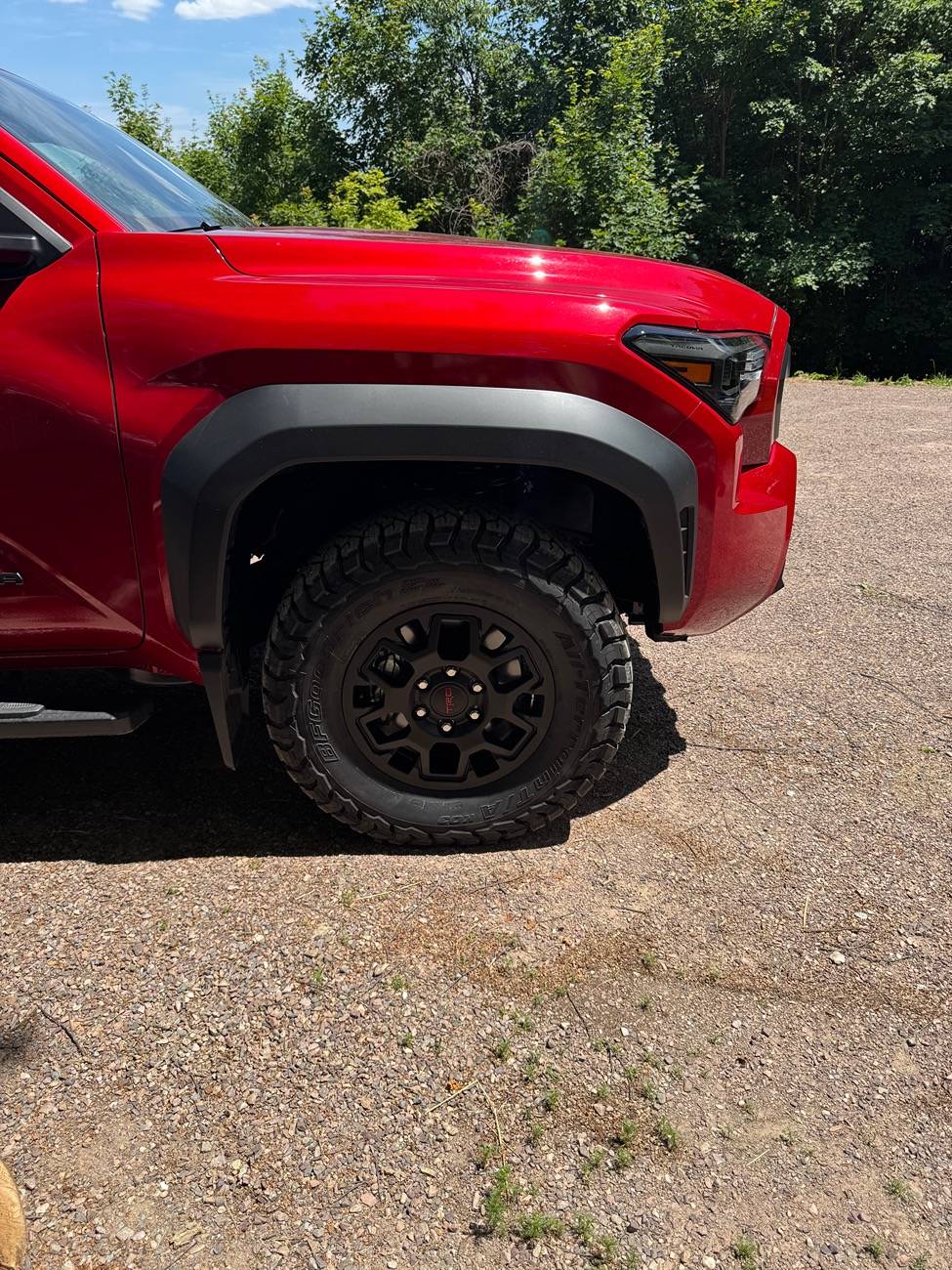

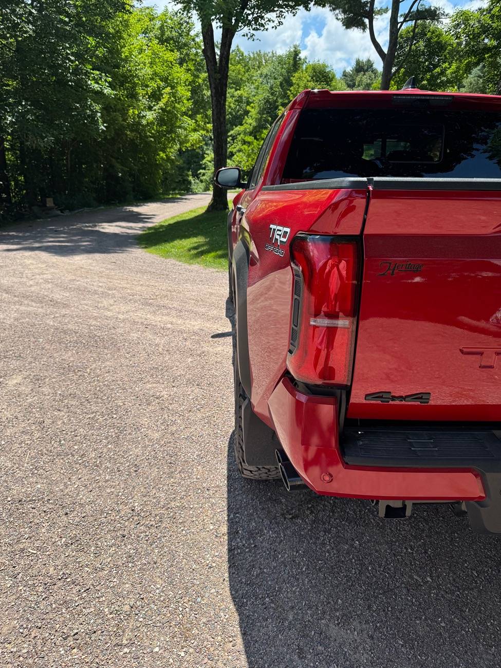

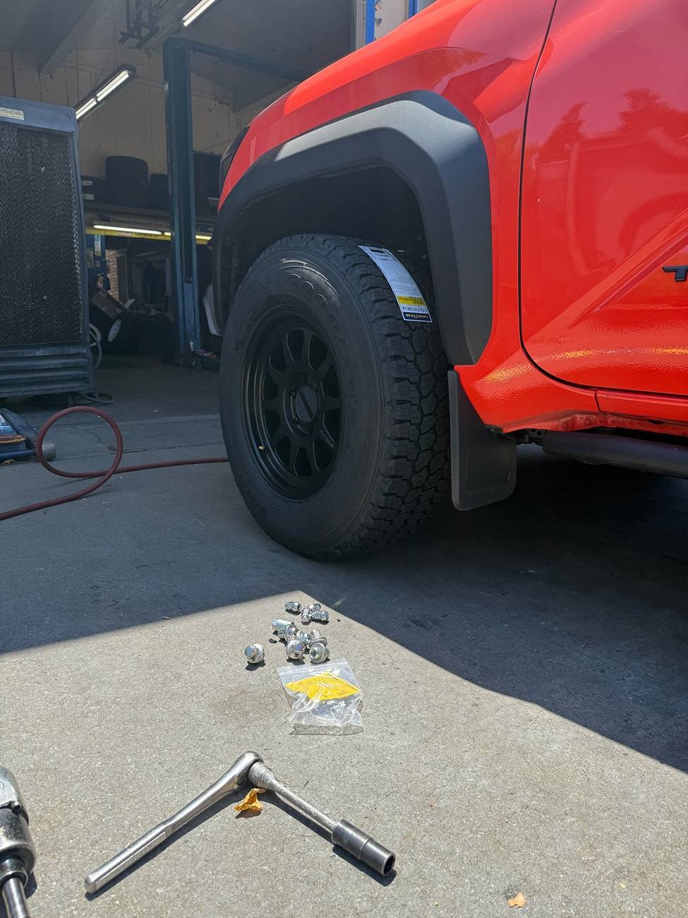

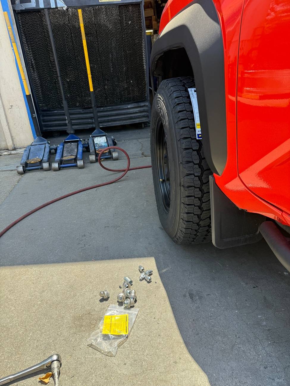

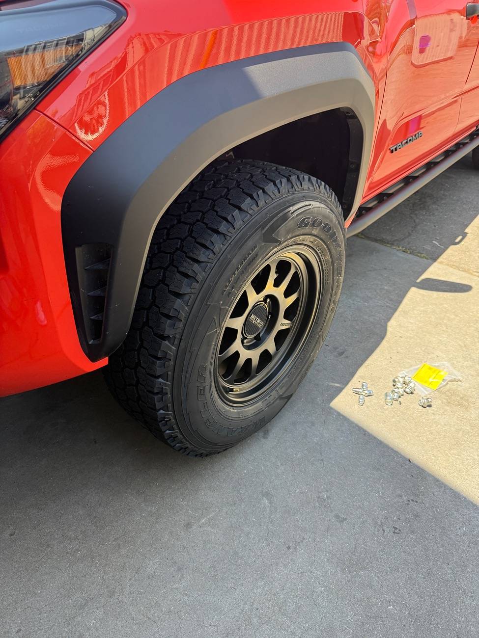

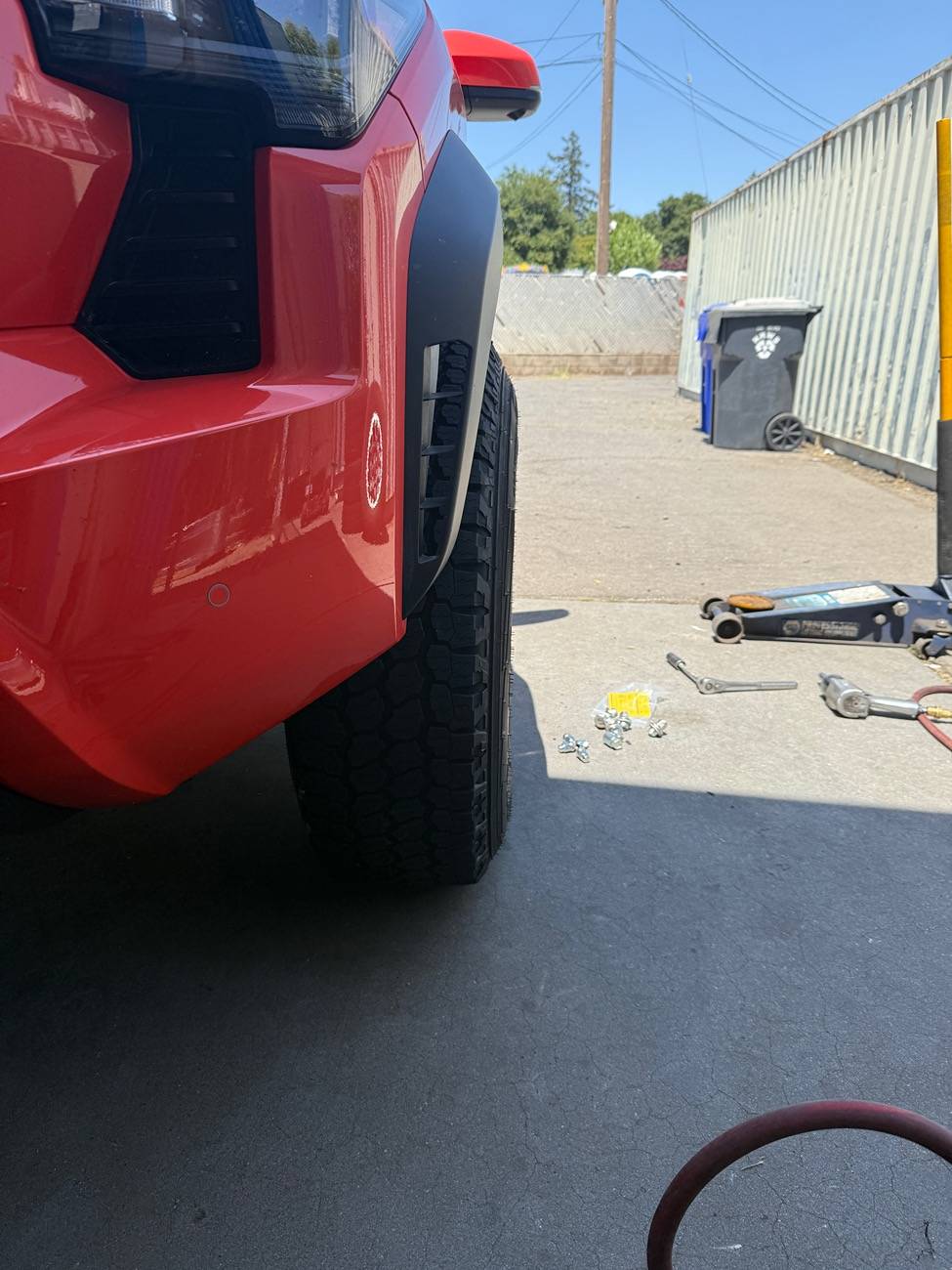

Not a done deal yet, but I did some fitment checking on my new method 316’s and a 275/70r/18. It clears the Goodyear tire they had in stock, by about a quarter inch between the tire and mudflap. The Toyo OC AT3 EV’s are just a hair wider so it’s going to be a nail biter.
just ordered method‘s ET lugs, the tire shop, Napa tire, just ordered the tires.
Highly recommended Napa Tire, Jay and Jeff were great hosts, understood what I needed and mounted the tire in these pictures as a courtesy just to double check they they would likely fit and work out for me…at no extra charge.
America’s tire wanted 100 bucks to mount and dismount if they didn’t end up fitting…
Difference between working with an 18 year old cashier and a business owner….
