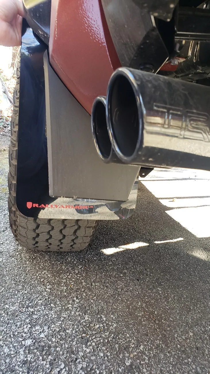

So I wanted to update this thread, I finally managed to get the rally armor flaps installed, though it was a pain and the rear drivers side still isn't perfect. Here's some pics. They look good, the black matches the fender flares and the red almost matches the paint.
The rear drivers side was the worst one. You can see how the top screw isn't really seated fully, and the foam spacer isn't sized properly IMO. Of course this was the one I originally started with and the one that gave the most trouble.
The rear passenger went on easier though I still couldn't get the top screw to grab with the included washer, so I ditched it. Note the spacer, DO NOT over tighten the screws over the foam spacers, they're not gaskets, they are there simply to fill that space.
The fronts went on ok, though I found it easier to turn the wheels towards the opposite side of the truck for access. There's this space that bothers me in the front but I'm over it, just glad to finally have something on there.

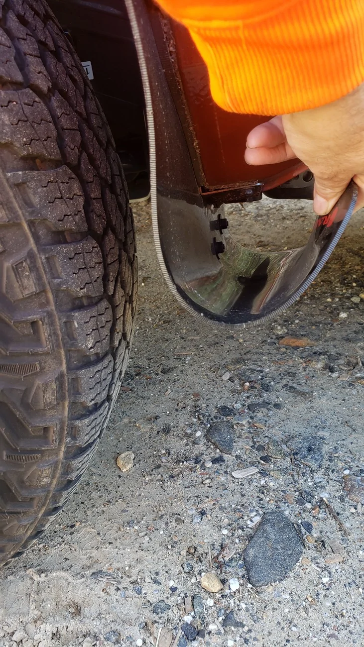

Are these effectively "high clearance" flaps that don't take more room than the OEM flaps?
Also, is that super shiny gloss for making them easy to clean? I would prefer matte, but maybe this has an advantage.
Lastly, I hear these are more flexy than the RokBlokz or ARKs. I need flexibility when driving over terrain so they don't tear off.
No they're much bigger than OEM. The fronts measure approx 18.25" x 12.25" and the rears 19" x 11.25" I like the gloss because it matches my flares, they do seem to stay pretty clean. They are pretty flexible, I can't compare to RB or ARK but I attached a pic that shows the flex on the front

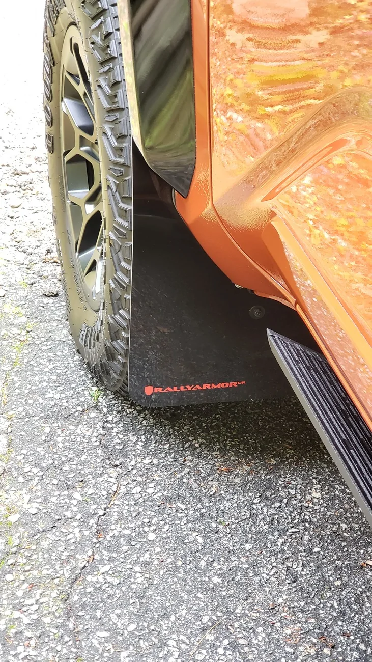

They’re big but don’t look goofy. Got a pic of the fronts ?
