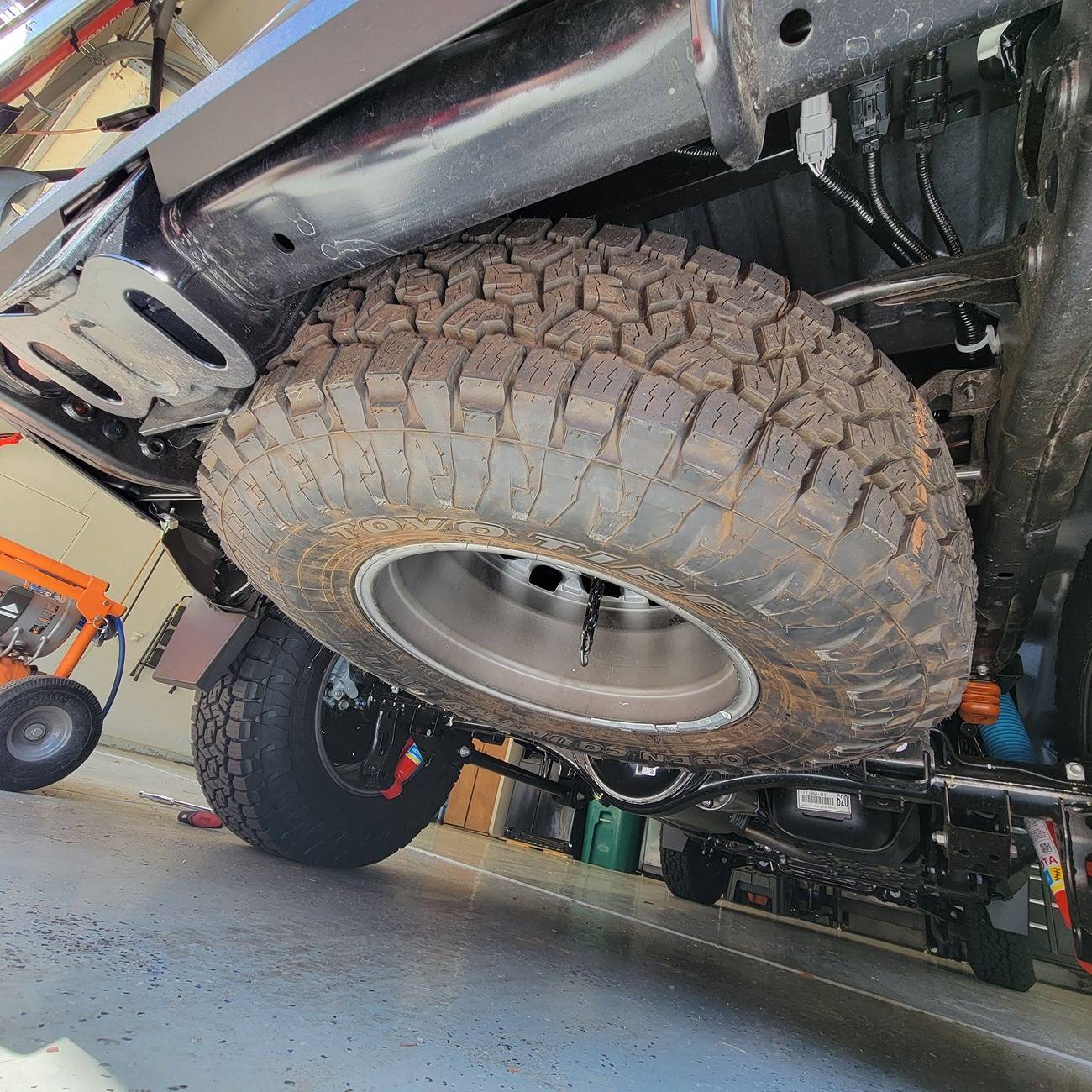

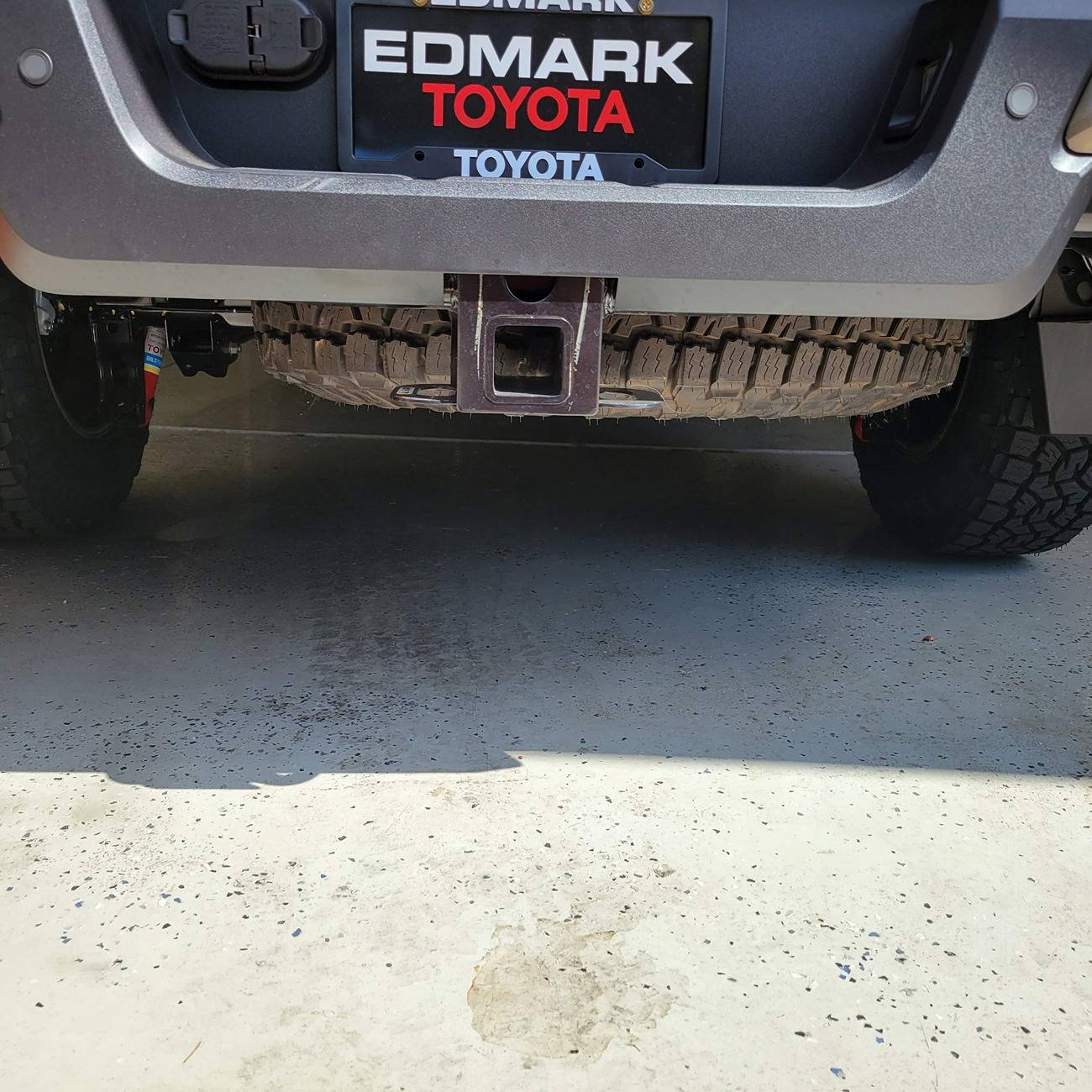

I am also considering the AllDogs lift, Not to fit tires, but for clearance off road, to offset drop from the front and rear bumpers I will be adding, and to better tow my offroad camper
You might consider 255 80 r17's. Those are 33" and the full size spare fits nicely with little overhang.
This video helped me decide on the narrower tire. It won't stick down as far as a spare
