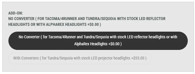

I have been eyeing these for a while and saw they were on sale right now. However got confused when I saw an option for a converter.
2024 Tacoma AlpaRex Double Tap fog lights 1764266898321-h
When I inquired about how to know if I need the converter....I'm pretty sure there are no 4th gen Tacomas with LED reflector headlights. I thought they were all projectors. I got the following answer from their support:
"Thank you for contacting AlphaRex USA. These fog lights are direct fit for 24-25 Toyota Tacoma without Rigid fog lights."
Therefore I believe that you need the converter on the higher level trims (TRD Pro and Trailhunter) that come with Rigid brand fog lights and the other trims do not need the converter since they do not have Rigid brand fog lights.
Just figured I'd toss my idea out there since there did not seem to be any resolution to this question here. I think I'm going to order a set without the converter for my TRD OR.

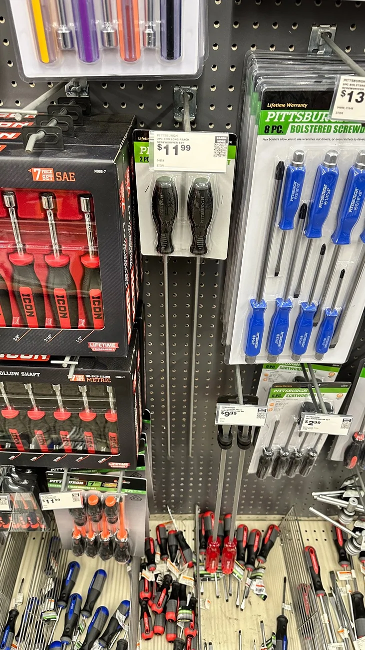

So I think I did it wrong 🤣. @MT-Taco how did you adjust them? Seems to me the bumper cover has to come or I missed something given how high they are. I didn’t see anything obvious to adjust them.

No need to remove the bumper cover. You’ll need a long Phillips screw driver and a good light to see where the adjustment screw is at.

Went to harbor freight to get these lol
Yes those would be perfect! Once I looked in the right place it was obvious. It is indeed a long large Philips head. At least 7”. My 6” one was just slightly too short.

You can also adjust these with a 10mm socket, swivel and a long extension if you do not have a screwdriver long enough. That was how I did it. No need to use a ratchet as these are easy enough to turn with just your hand.
