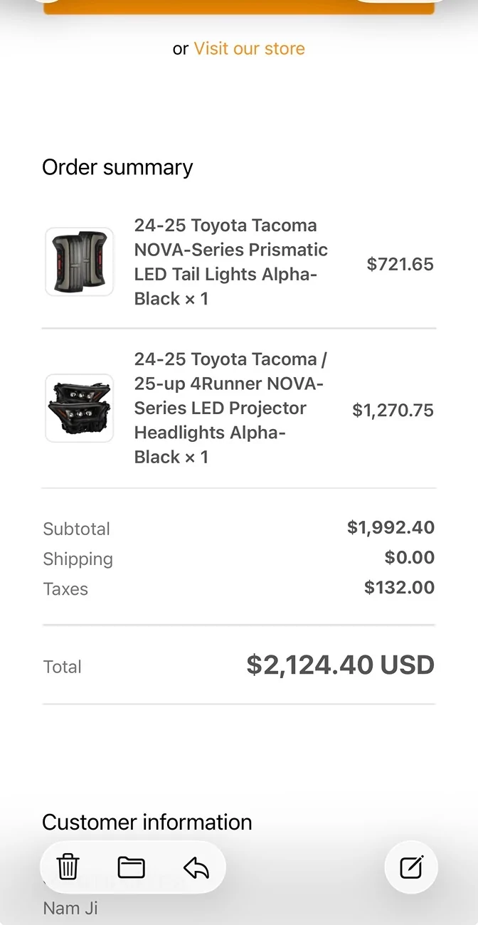

For black friday sales I ended up going with with the RGBHaloKits site instead of TacomaLifestyle and Tacomabeast. It was like $1,195 for the Alpharex Alpha Black Nova Series (Quad LED).
