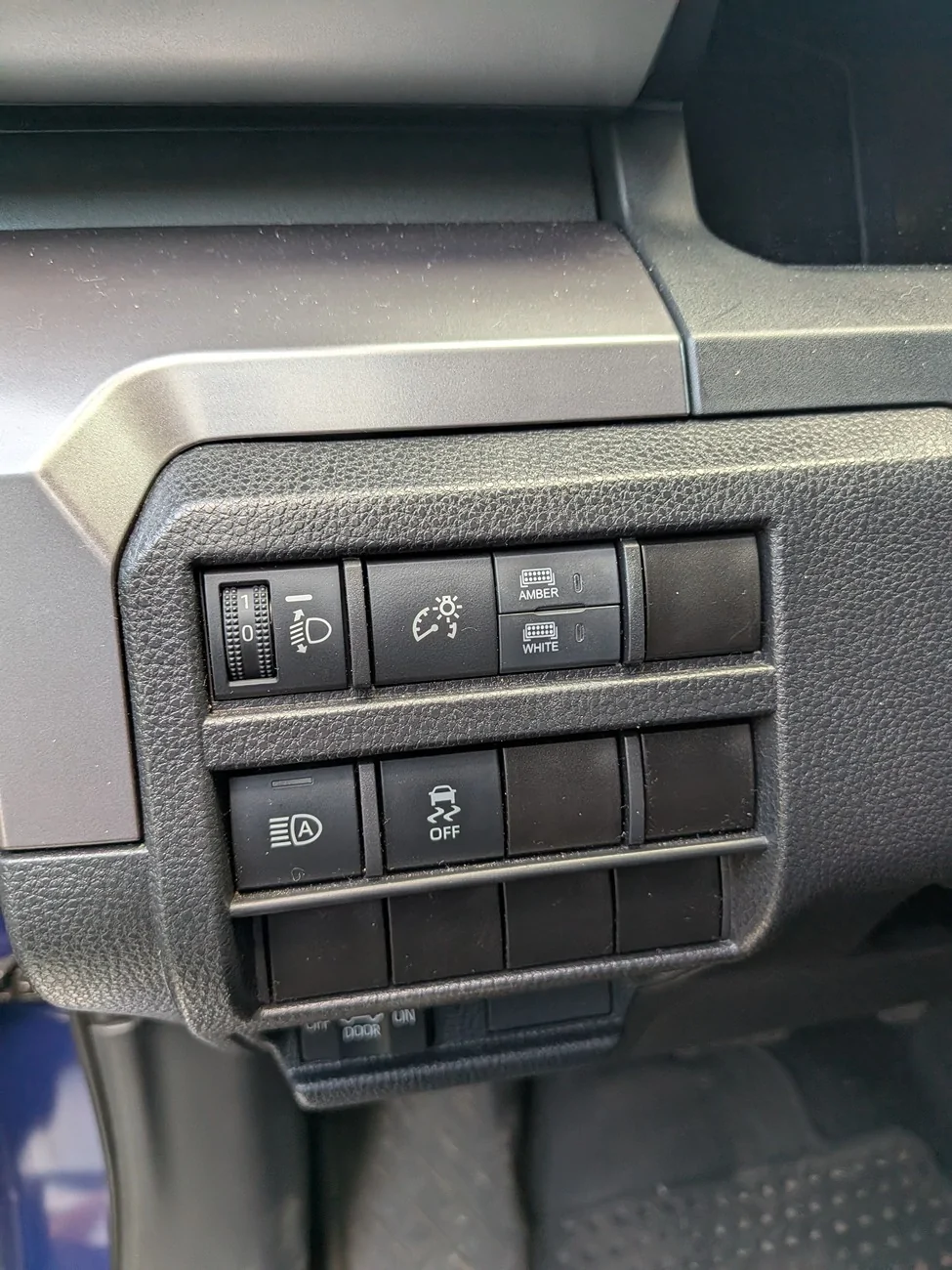

I should have gone OR for the aux switches! I have to take extra steps to wire lights into the dummy switches but it’s too late now I already have the vehicle gotta make the best of it!
It's extremely easy

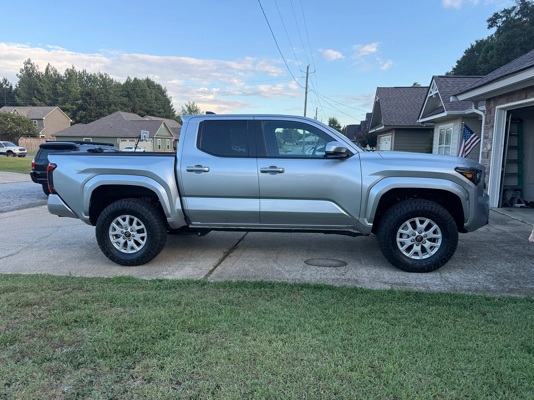

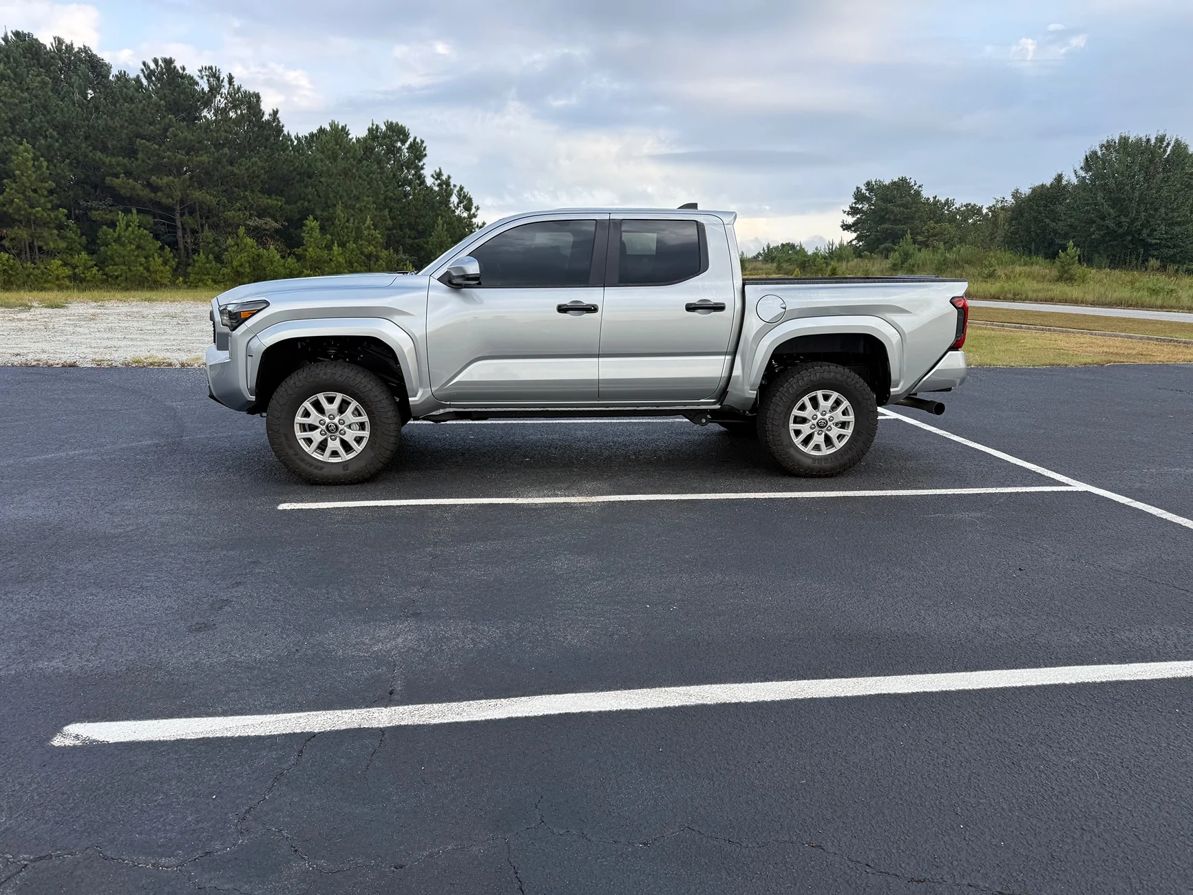

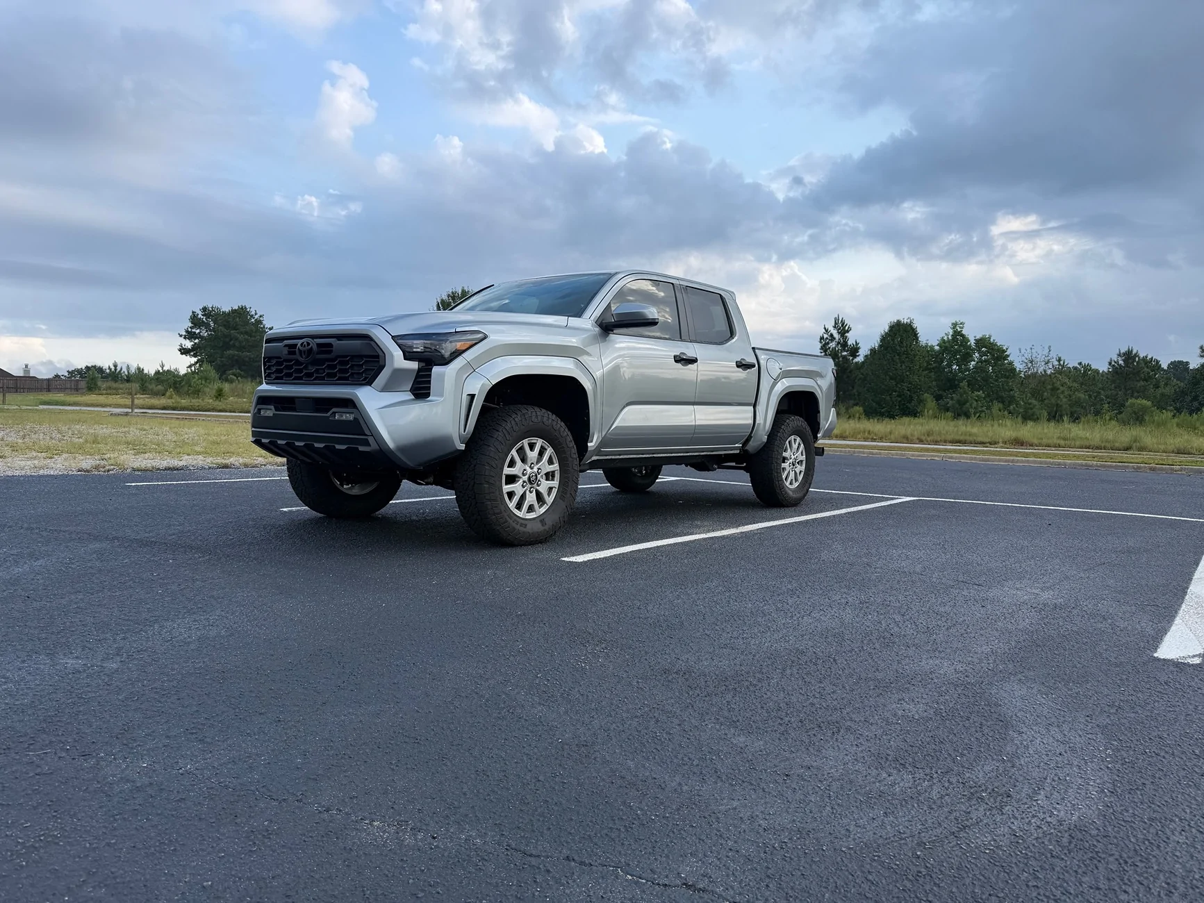

My SR5 so far.
Bilstein 5100 $478
Cornfed 1” rear spacer $80
TRD OR grill $80 off eBay.
Bridgestone Maverick at 285/70r17 $1147
I lifted it myself. It’s not difficult at all. It’s currently 1.8” lift in the front and 1” in the rear.
I still have wheels and front skid to go. I think that’s about all I want to do to it.
Big advantages an OR has is a bigger rear axle, rear locker and MTS. Everything else I would of replaced anyways. Also I have a fully built 3G Taco. That’s really why I picked an SR5 this time around.

That’s awesome bro and those tires can be re used if you change the wheels in the future. The only thing I would possibly want to change is maybe add an aggressive center cap to the wheels.

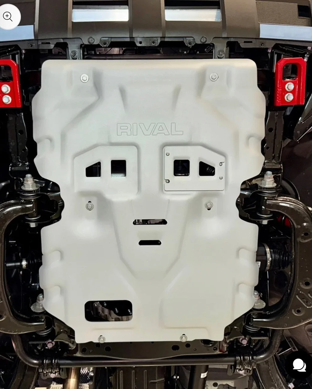

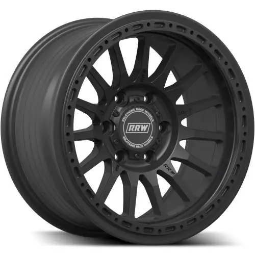

I didn’t have the truck 24hrs before I bought those tires :crackup:
I already have wheels and the skid picked out. Luckily the 26 SR5 already has the skid crossmember support unlike previous years.
RRW wheels and the Rival skid has a place for oil changes.

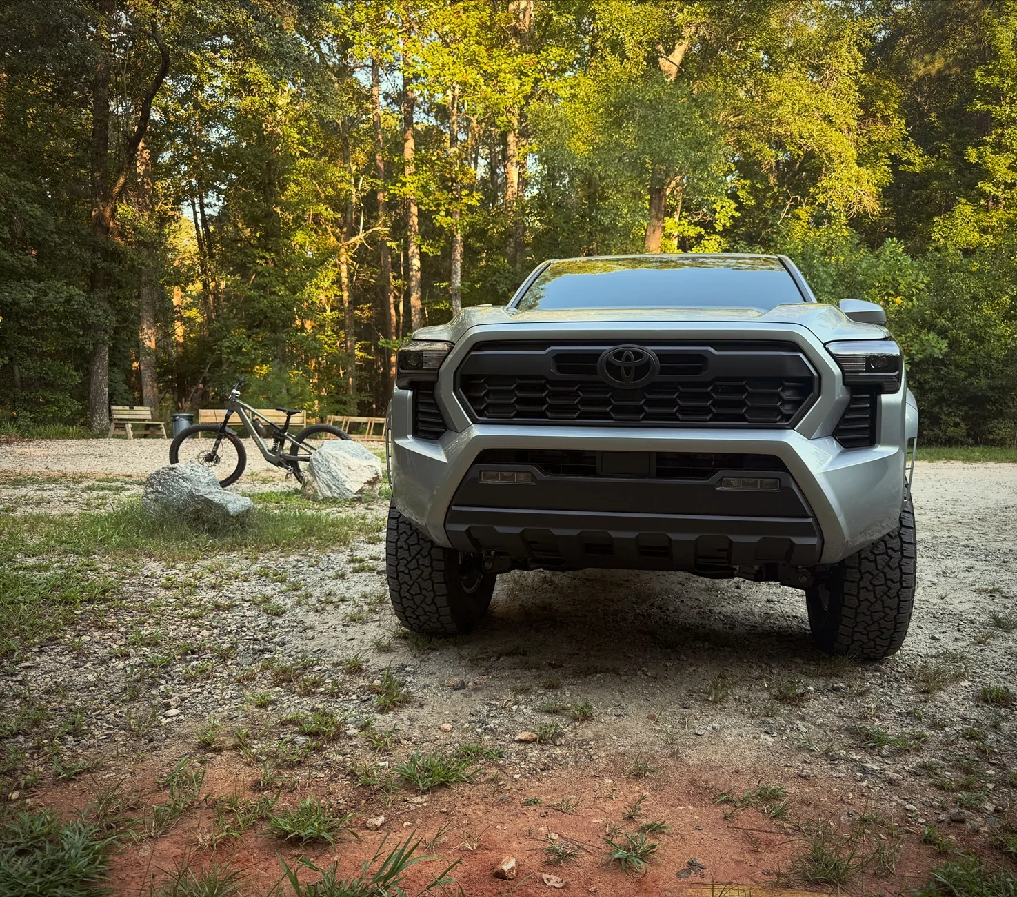

You don’t need anything to fit 285/70s
Also lifts don’t really accommodate bigger tires because the wheel will still articulate while driving.
Stock with 285/70r17
