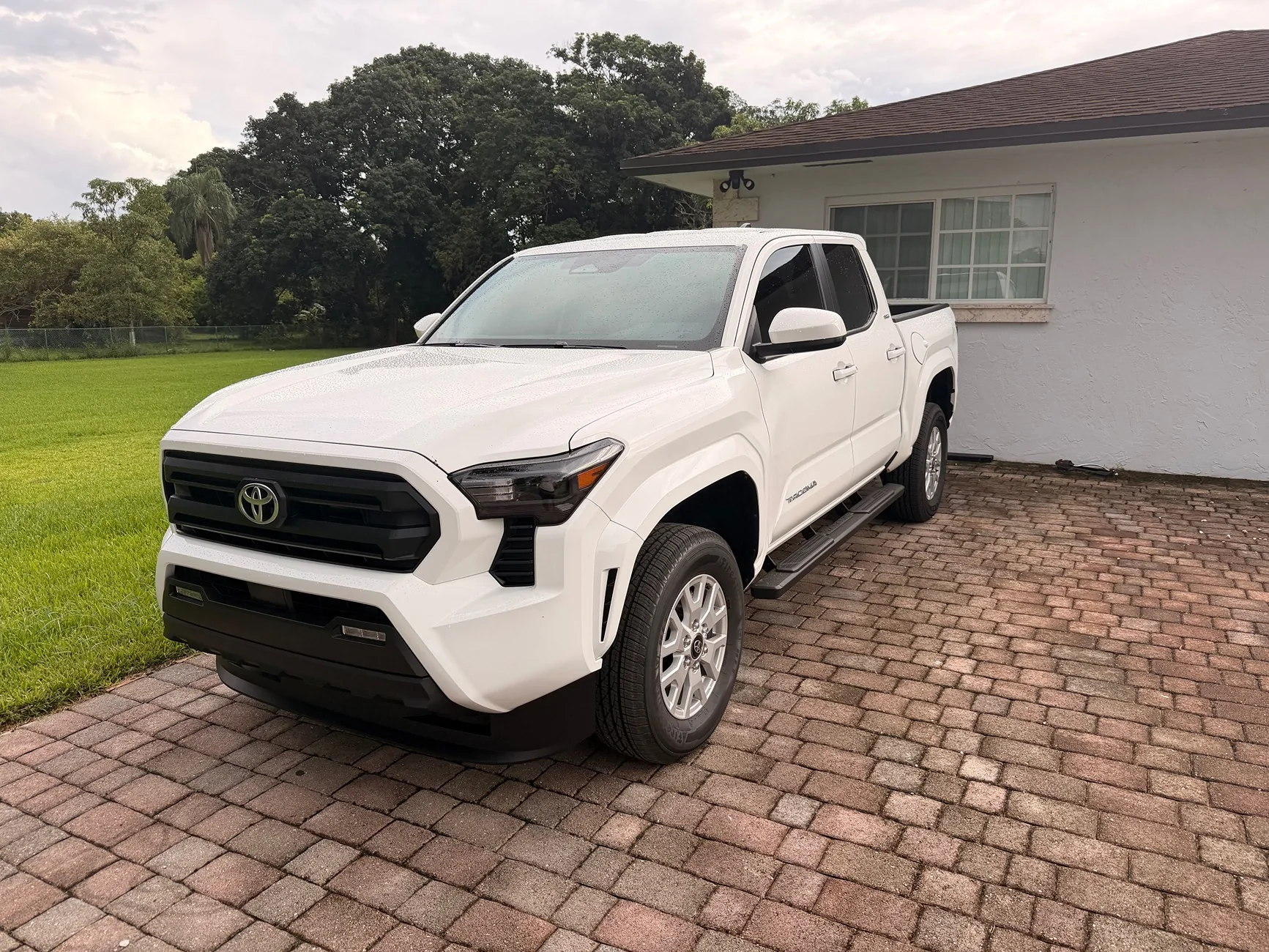

Hello All! This is my first Tacoma. I’m coming from a top of the line Gladiator and wife has a 2025 Sequoia Platinum so I will need some help for upgrades to make this truck look and feel dope!
Things i’m looking to do so far:
1- New Tires and Wheels. Kind of bummed I didn’t go for the next trim up. I didn’t realize the trd had a bit of a lift compared the SR5. I thought it was only the TRD Pro and Trailhunter that had some lift. I read many warnings on reddit against lifting the truck and it’s also thousands of dollars so I probably won’t lift it for now. I’d like recommendations for best wheels and tires that will give the truck a more off road look and will also give it a bit more height off the ground without a full lift. Also don’t want my MPG to take a big dive so I think I have to watch the weight of the wheels and tire combo?
2- Tonneau Cover- was looking at this one on amazon: https://a.co/d/05cfq89T . Don’t want to spend $1,500 on a cover and I prefer a hard one.
3- The TRD Pro grill is a must for me. I was looking at the kit on rave off road with light bar options. These light bars come in different shapes sizes and most importantly, prices! Lol Anyone have any experience replacing the grill, anyone used rave off road kit?
4- Seat covers- haven’t looked into it too much but i’ve had leather/leatherette seats for the past 10 years so i’d like to get that feel in this truck.
5- Roof Light bar and rack- damn this is pricey!
6- Need wiring help. I will likely add/change lighting all around the truck, fogs, fangs, raptor, etc. I saw some videos explaining how to wire to aux switches on the dash. Unfortunately, SR5’s, at least mine, does not have any aux switches on the dash. It just has a bunch of blank unused buttons. Any pointers here would help as I could not find any videos on how to turn those blank switches into light switches.
7- Any other recs for must haves please feel free to share. I’m treating this like an adult Lego set and can’t wait to tinker with mods for the next few years! Thanks in advance!

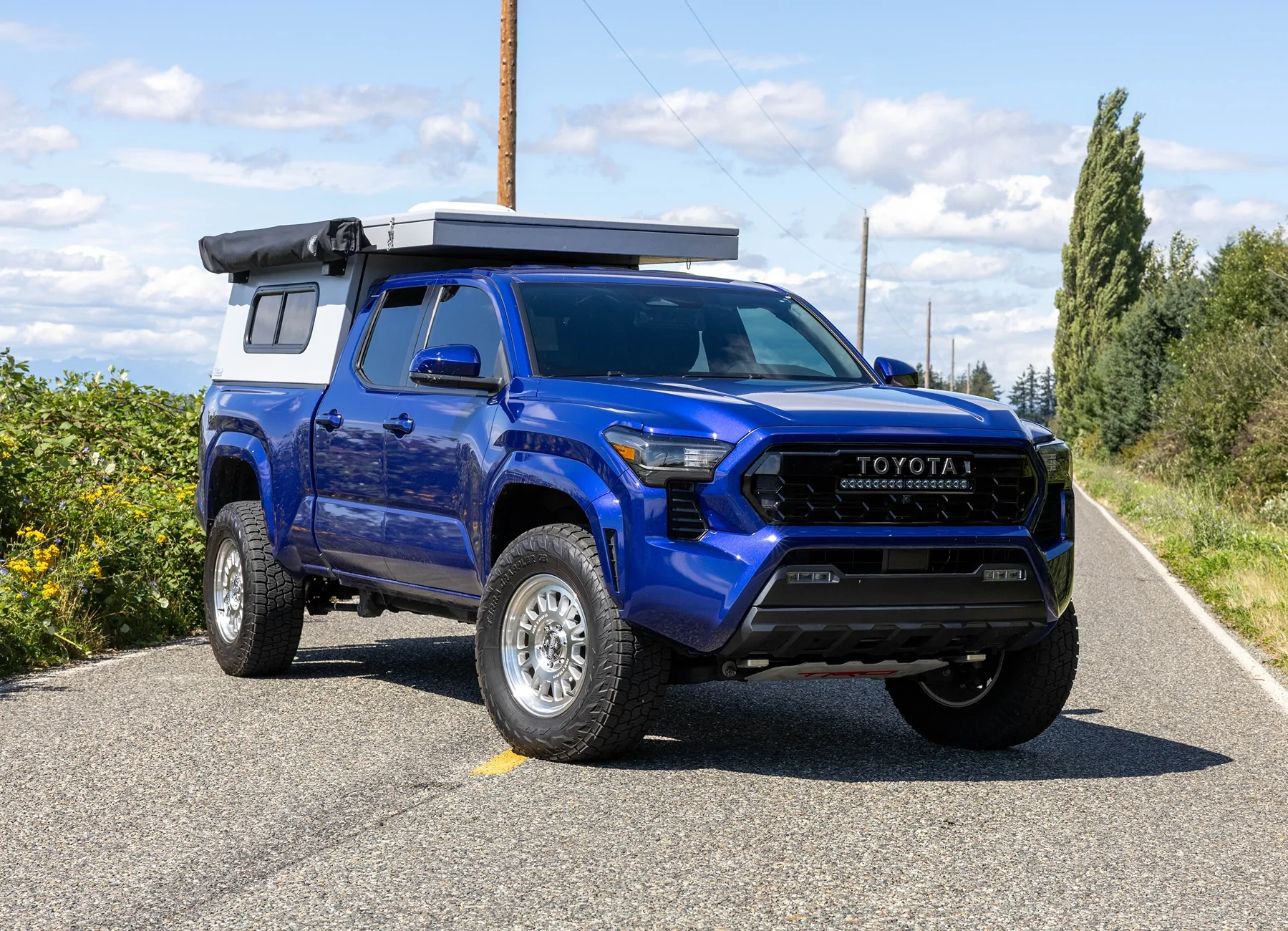

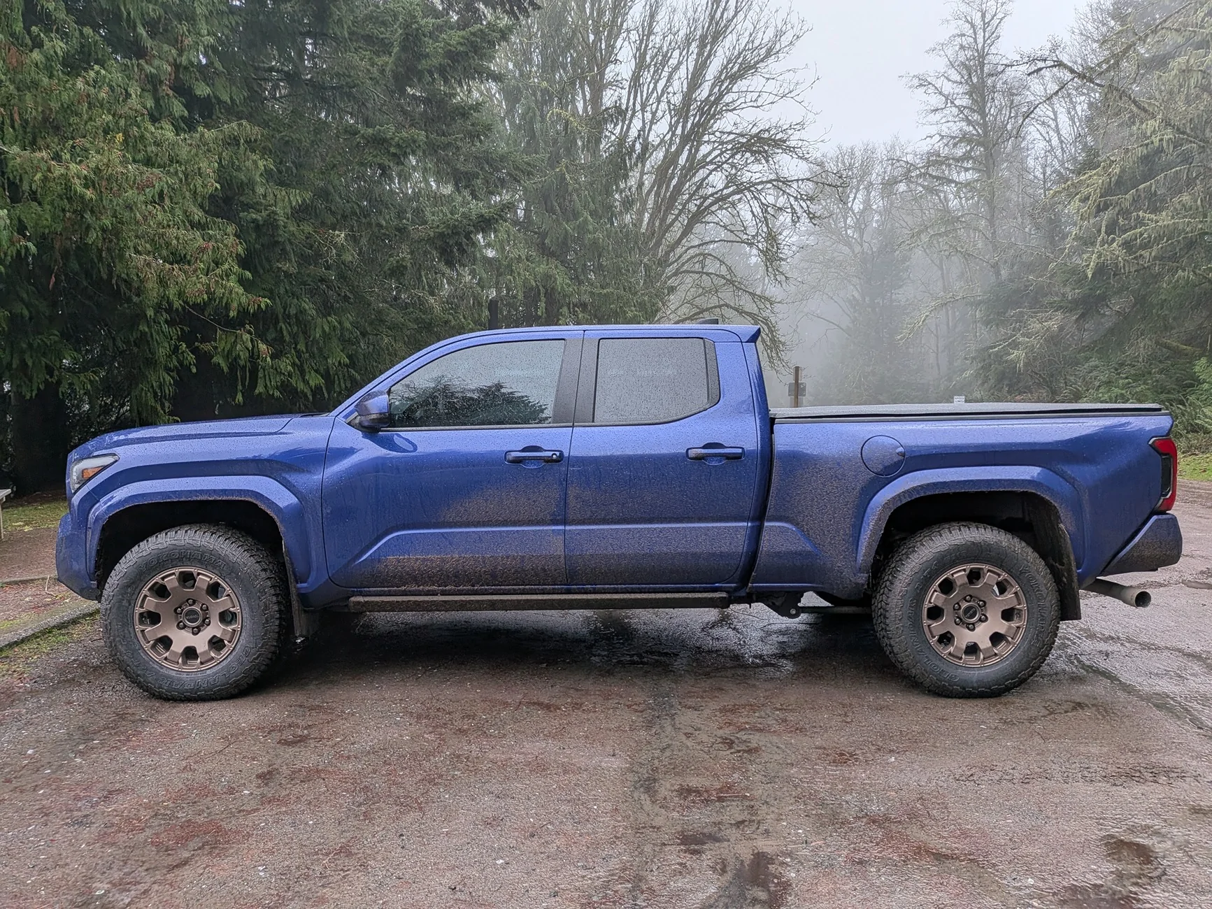

Yea and a member here actually sent me the link. Wheels and tires. No tpms or lugs. You just have to be patient, but in my area there are a set of 17" TRD wheels (no tires) for $120 right now. Check marketplace, the marketplace here on the forum (usually overpriced) and offer up. And then sell your stock wheel set for a few hundred and get some 285/70/17 tires. You'll be stoked and it will sit higher than ORs off the lot.
I have an SR5. 1ish inch lift with Bilstein 5100s and 275/70r18 (camper photo). Makes my co workers stock OR look wimpy when I park next to it lol but even before the bilsteins on stock suspension 285/70r17 or 275/70r18 looks good (photo with the bronze wheels).
If you want trailhunter or pro wheels with a more aggressive offset they can be had with center caps for $800 during a big sale

It looks a bit higher with in the 1st pic, is it tires or did you lift?

First pic is 1" in the front and 1.5" in the rear, sits at 1" in the front 1" in the rear now.
Second pic was stock Hitachi suspension with 275/70r18

Crazy how 1” makes a difference. Which kit did you put in?

Bilstein 5100s on the first setting up front and peak suspension 1" spacer in the rear, but I would just do the cornfed rear spacer. Cheaper and does the same thing. Love the 5100s though!

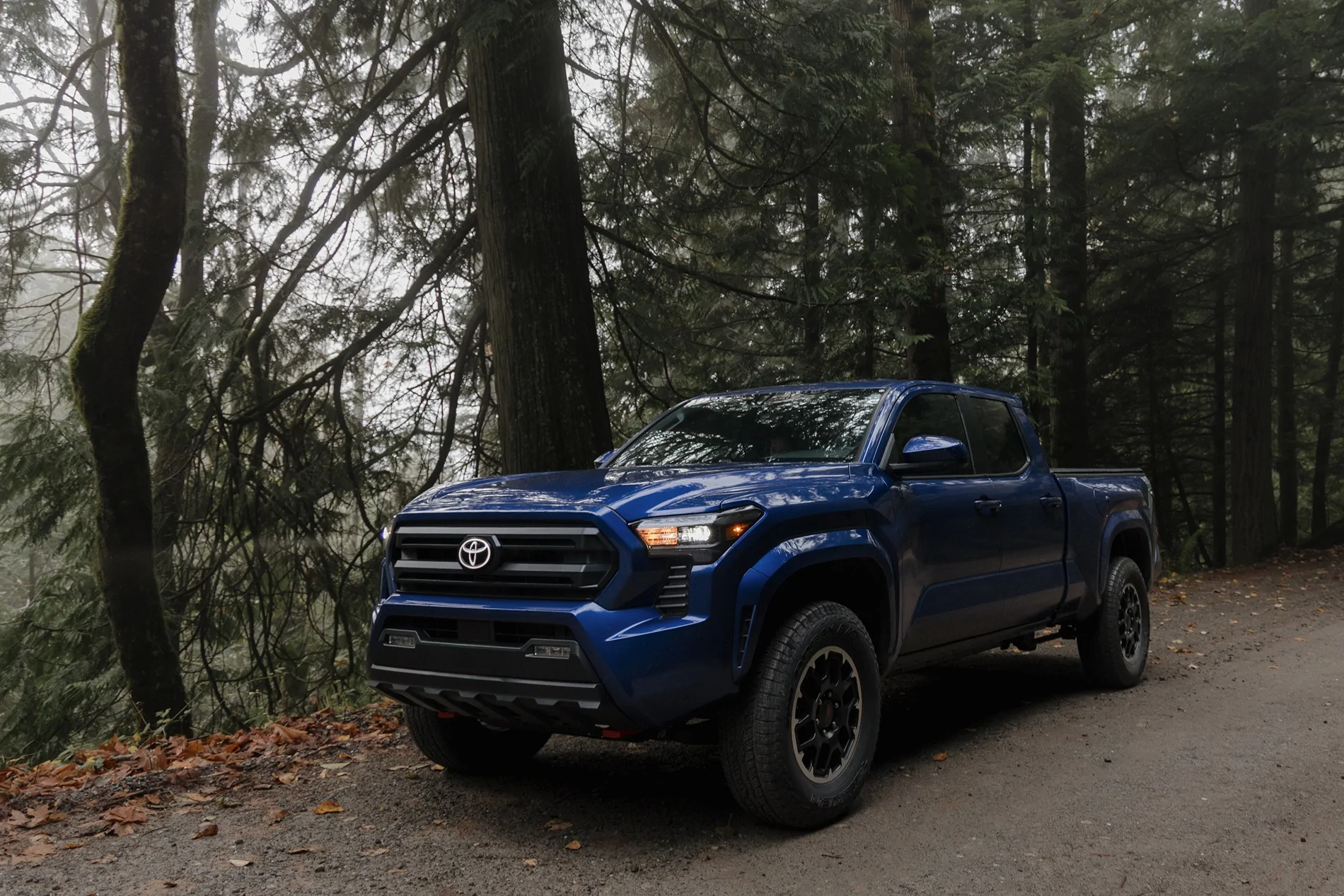

Will makes a good point, I made a little cash buying/selling, but spent a lot of time messing with wheels. I've had 5 sets of wheels on the truck in less than a year. Buy once cry once !
For me, in this area, OR take offs were just a quick short term solution until I had the cash for a nice wheel/tire combo. I picked mine up on Craigslist on the way home from the dealer, but yea, changed em shortly thereafter so could've skipped em.
Still, they change the look of an SR5 for someone on a budget:
