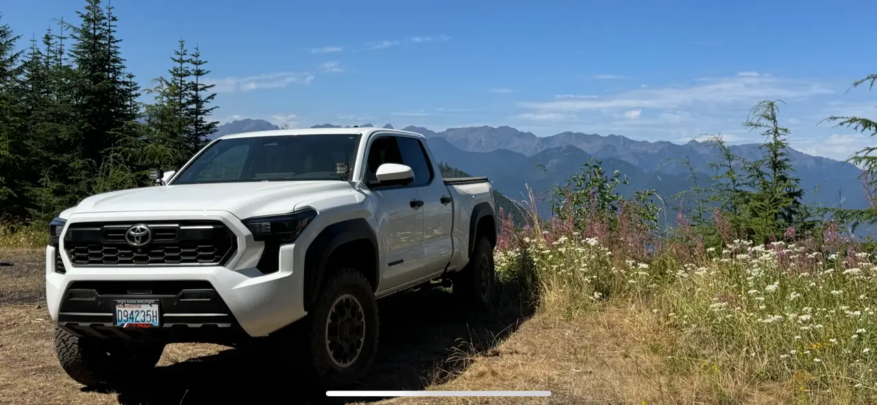

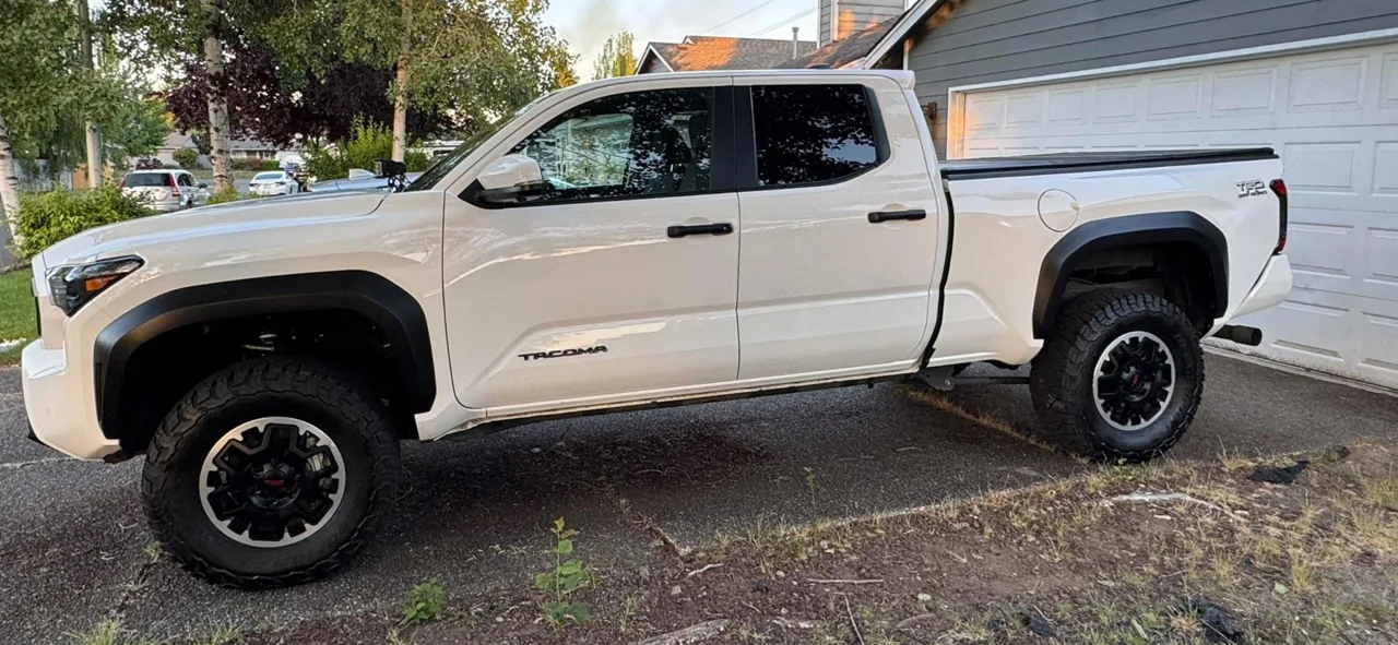

You will be fine. These 4th Gen Tacoma's were engineered to support 285/70/17's and some ship with them.
I have the same tires you are interested in and there in no power issues of any kind.
Go for it!
Go for it!
thanks so much for the input i think thats what im going to go for! is your truck lifted?

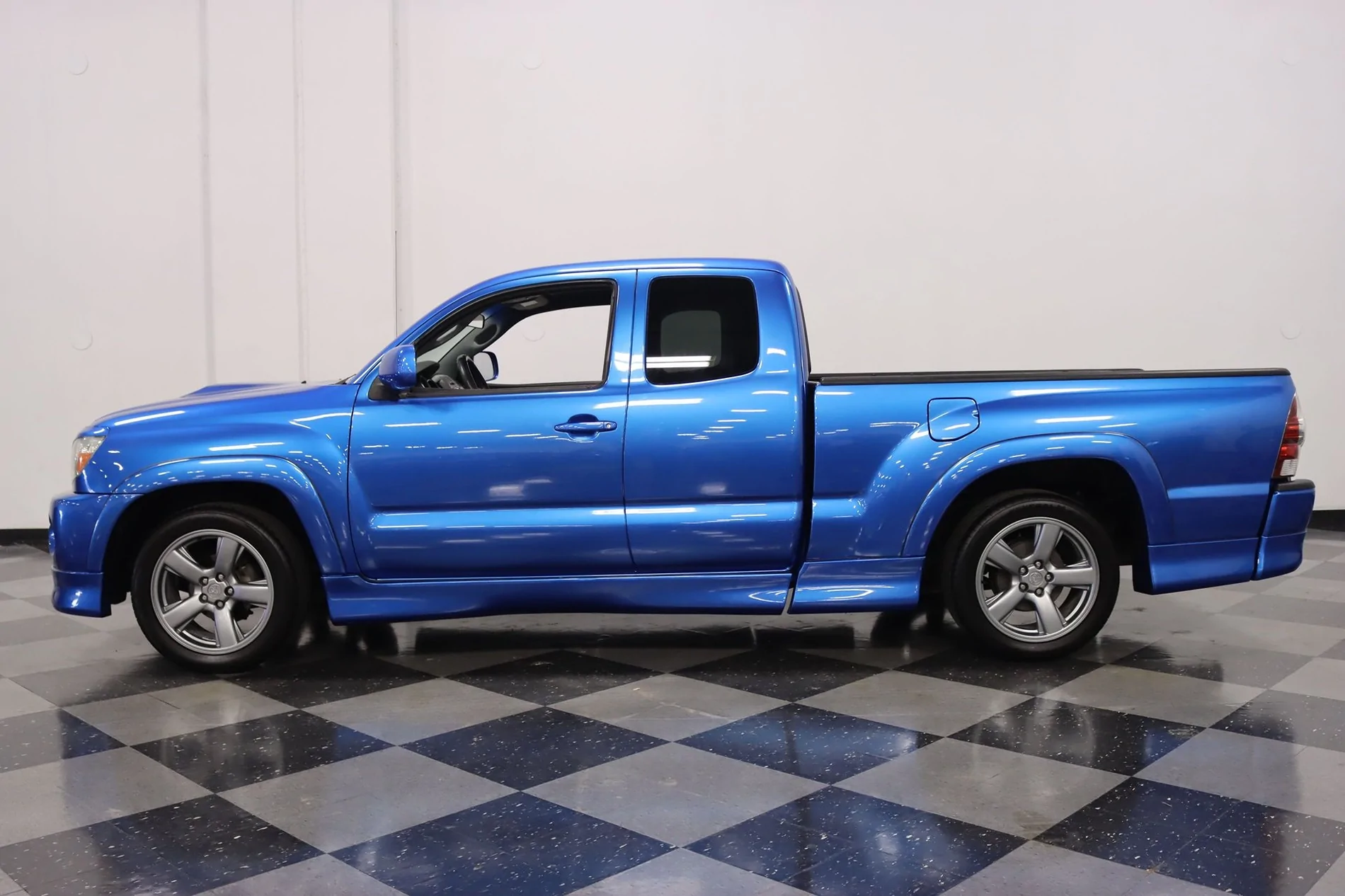

Do note my 2005 X-Runner, I dropped down to a 285/30 R18 from factory 255/50 series.

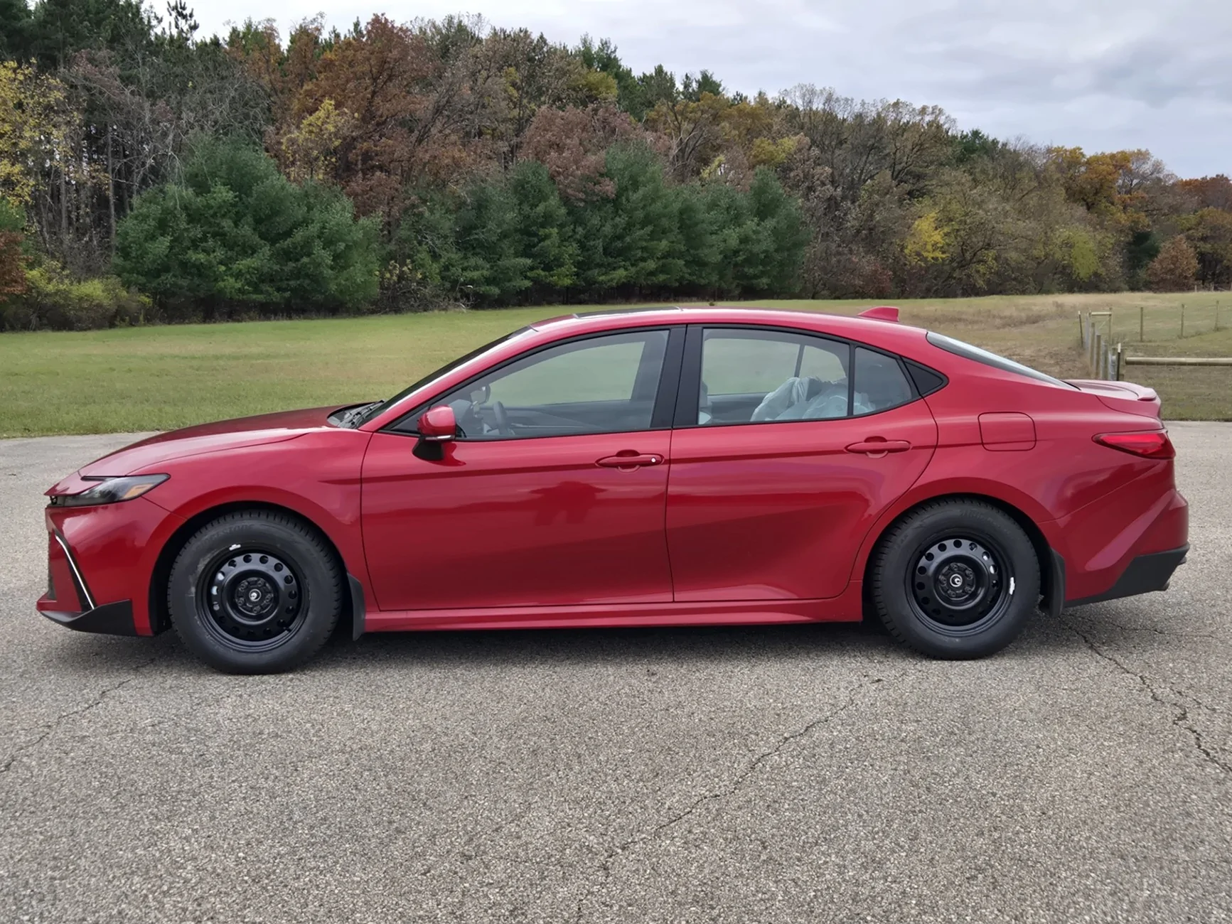

From this first image to second image. I also change my tire size and rims on my daily Camry awd from 18's to winter 16's, no issues.
Changing rim size and tires never an issue.

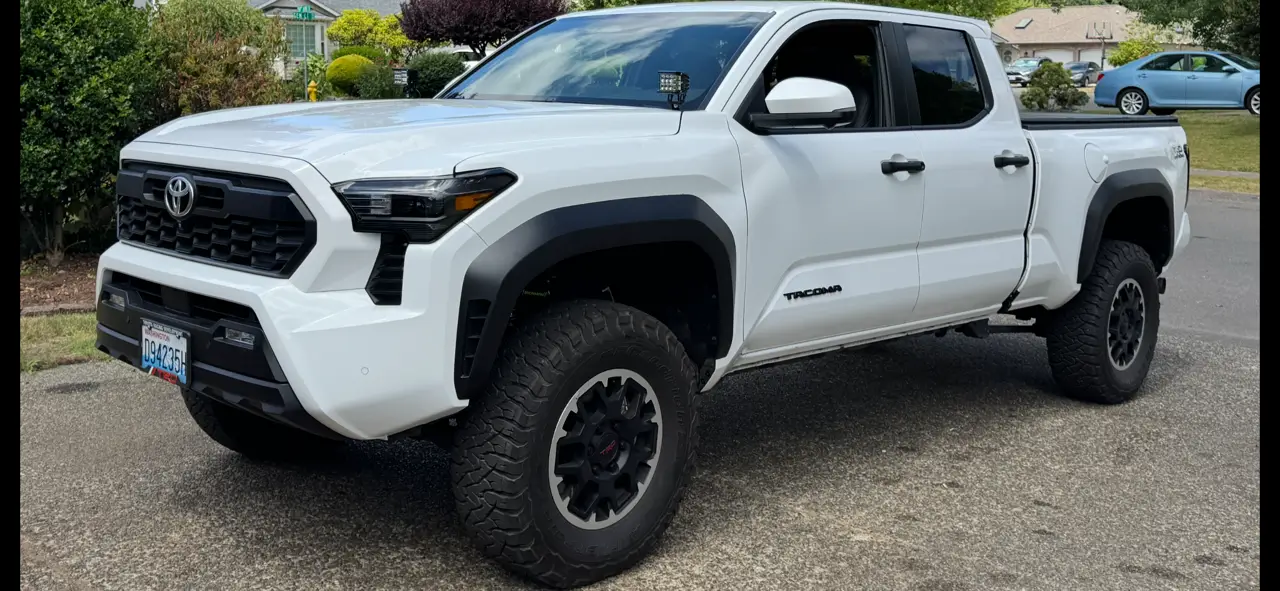

YES, I had the tires put on before the suspension lift, they are C load also. My suspension is an
3" Ironman 4x4 stage 2 With Upper Control Arms.
2024 Tacoma Any Downsides to Running slightly bigger tires??? drivers sid
2024 TRD OFF ROAD PREMIUM LONGBED SWAY BAR disconnect,
3" Ironman 4x4 Stage 2 suspension lift. 285/70/17 BFG K03's
