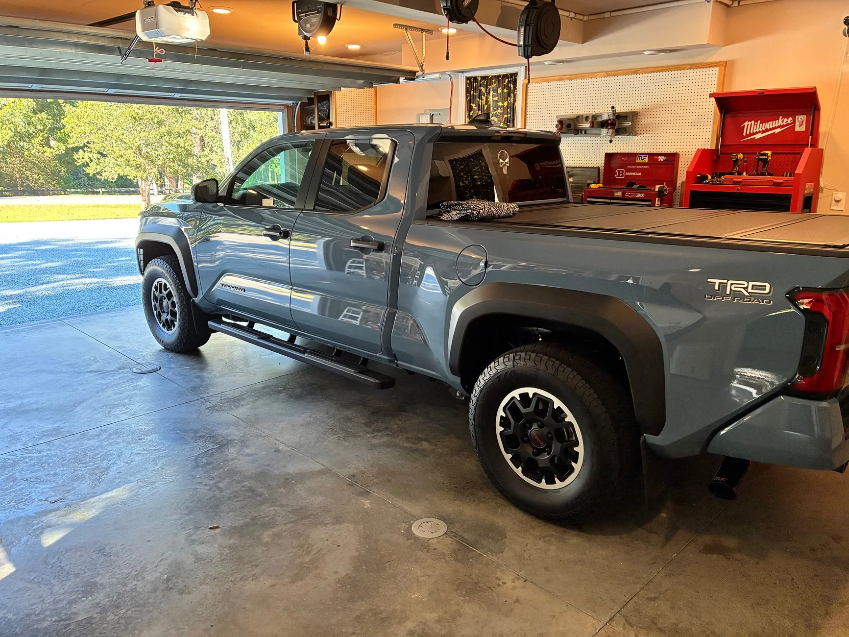

I have BFG’s 285/70/17 on 26 TRD OR they fit with no issues at all no spacers no lift the GEN four stock will fit that tire perfectly. I did lose about 2 miles a gallon, but I can live with that.
2024 Tacoma Any Downsides to Running slightly bigger tires??? IMG_1213
2024 Tacoma Any Downsides to Running slightly bigger tires??? IMG_1211

Thank you for the reply! Love the color btw. tires looks great!

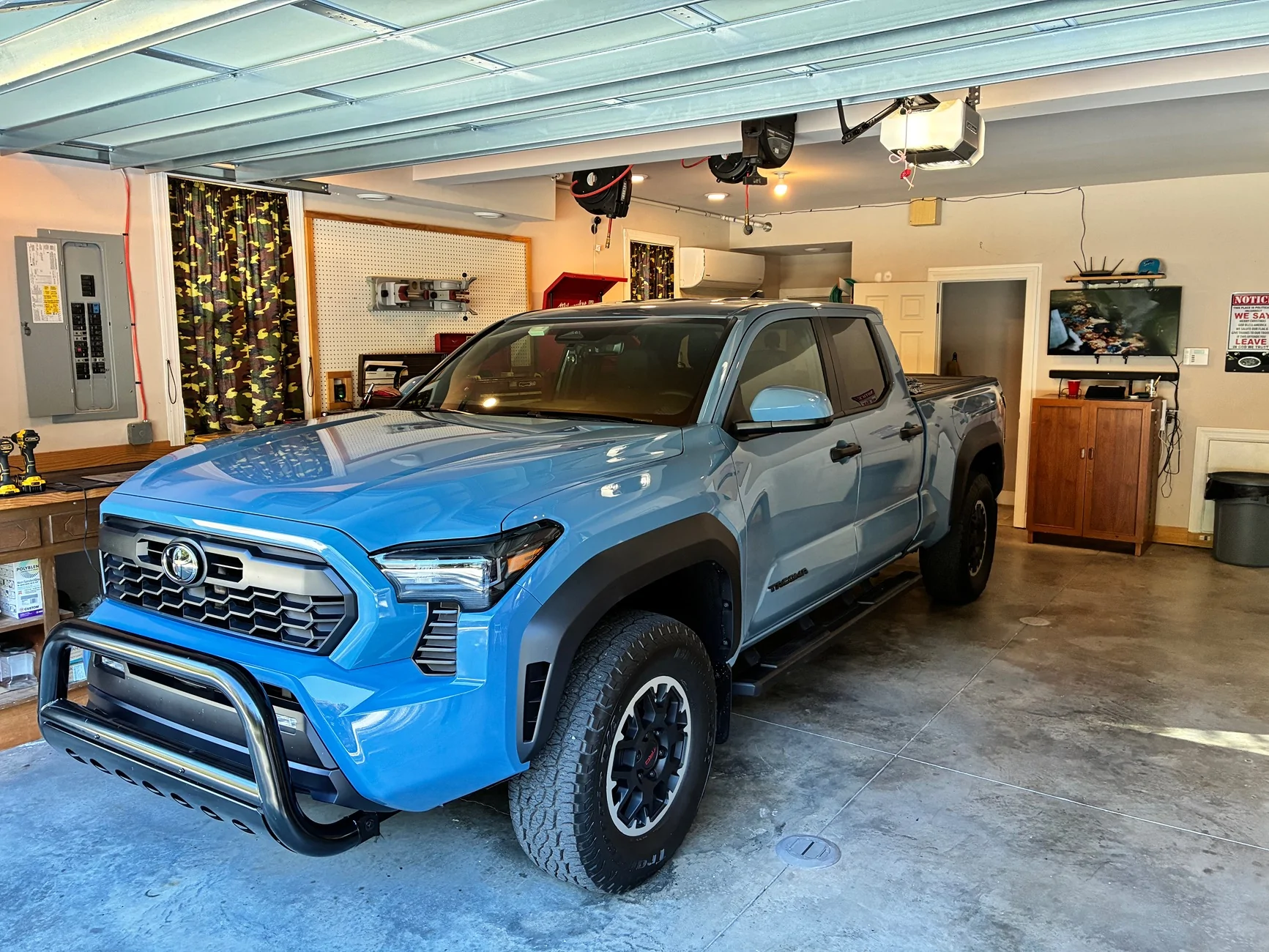

1-2 lower mpg, slight power loss (8 speed auto), more expensive $$.
Little to no change to drivability, unlike previous gen tacomas.
But you gain ground clearance, far better off road capability, looks.
Worth it for some, not for others.
EDIT: upside with 285’s the Speedo is dead on.
2024 Tacoma Any Downsides to Running slightly bigger tires??? IMG_6718
