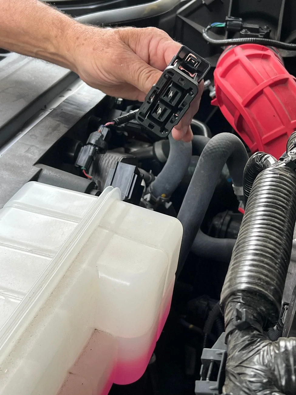

I understand mistakes happen but I've seen this here, TW, and on reddit.
I want to be positive for anyone here's sake but with aluminum blocks and heads you usually get 1 good overheat and then its kinda cooked.
Seems like plugging stuff back in that you unplugged is a routine part of servicing a vehicle usually... lol
This is an L mistake on the techs end. Maybe we need a sticky for people that get this done to pop the hood after and look for this plug:
2024 Tacoma Anyone else’s A/C absolute garbage at anything under 25mph? 1754422272647-a0

Exact scenario as listed above: https://www.tacomaworld.com/threads/bsm-tsb-make-sure-dealer-re-connects-all-plugs.862541/
@john877the plug is pictured in that link.
My A/C started acting up after the update, but I didn't put the two things together until your posts. Sure as can be, I too had a plug hanging around, disconnected. Although I am not technical enough to name the connector, I could tell that it lead to the cooling fan. It was however a different connector than mthorpton's pics which I find puzzling. After taking pics (see attached) to show the dealer who did it I plugged it in and viola', A/C worked like a charm.
<a href="https://www.tacomaworld.com/threads...r-re-connects-all-plugs.862541/#post-30865908">BSM TSB - make sure dealer re-connects all plugs</a>
I raised hell with the dealer, but I'm sure it doesn't make a whole lot of difference. It's really frustrating that this is happening so much.
