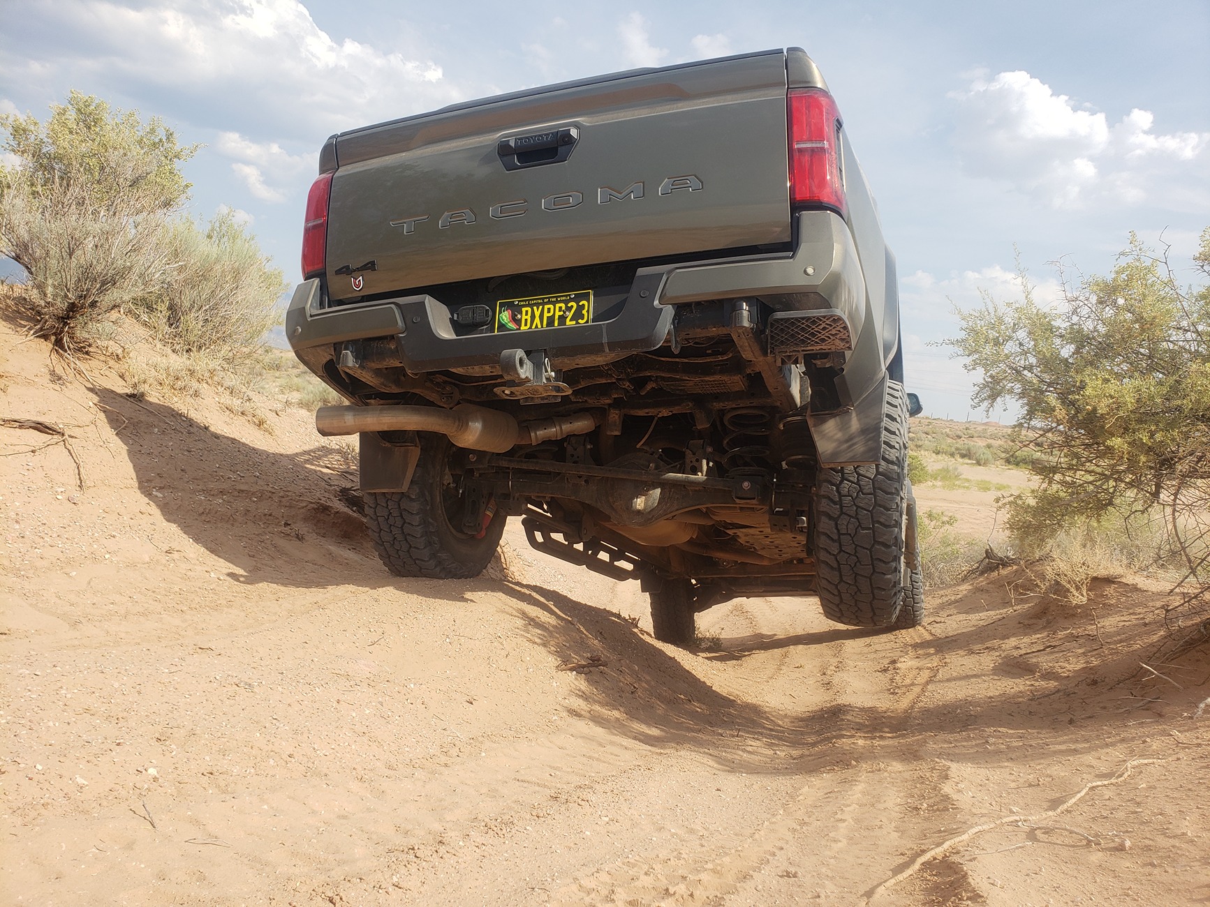

I installed them. I like them a lot. My situation is similar to yours, except I don't tow, my load is on the truck. Rack, tent, coolers, overlanding stuff. But, I'm unloaded most of the time, like you. I took a trip to the white rim trail prior to putting in the airlift. I used Timbren springs and still had a lot of sag. So, I was able to return those and I got the Airlift. Bring able to control it is exactly what I wanted. Air up when needed, return to stock suspension when I don't. (Yes, I keep 5 lbs of pressure in it as the manufacturer recommended). I did install the cradles for off roading, they work perfect. I'm super satisfied with the air lift and recommend it.

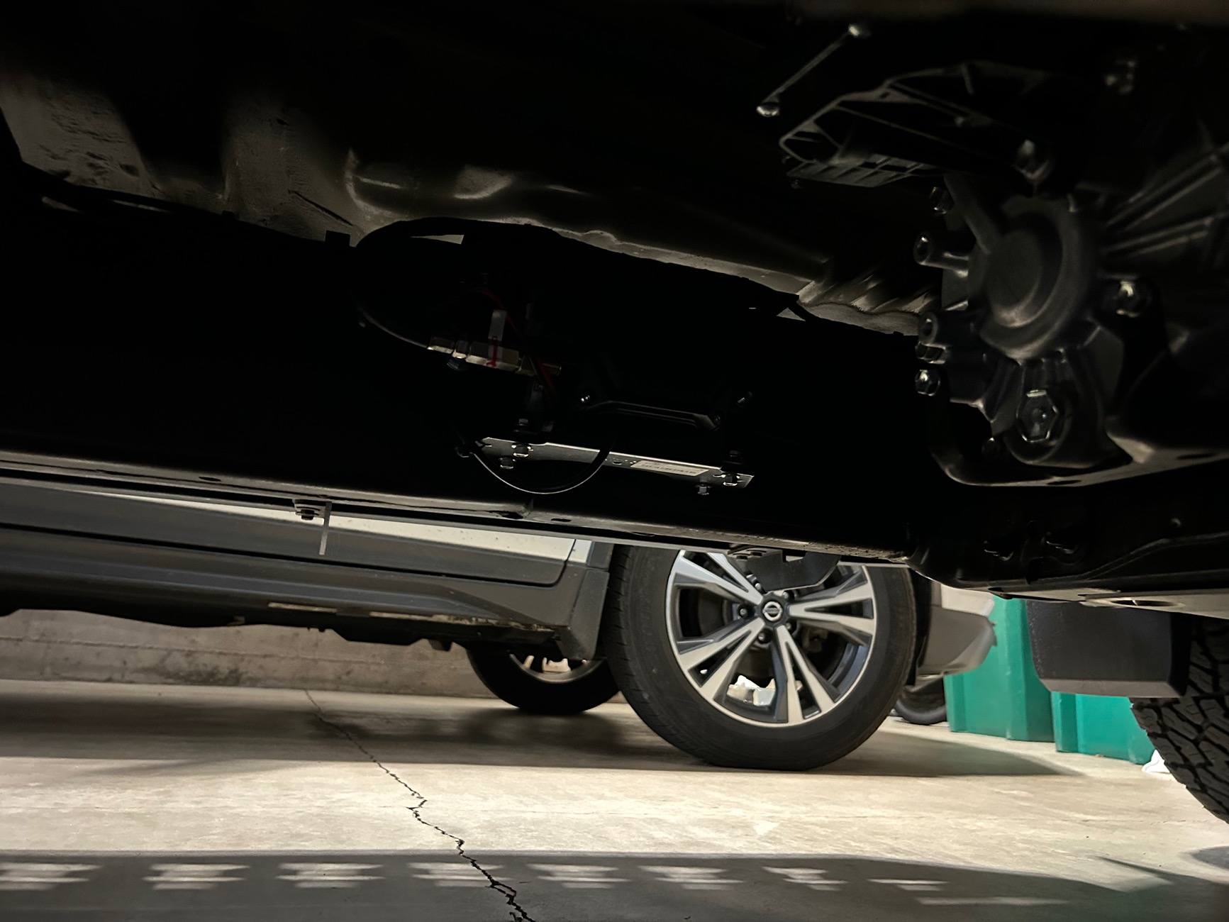

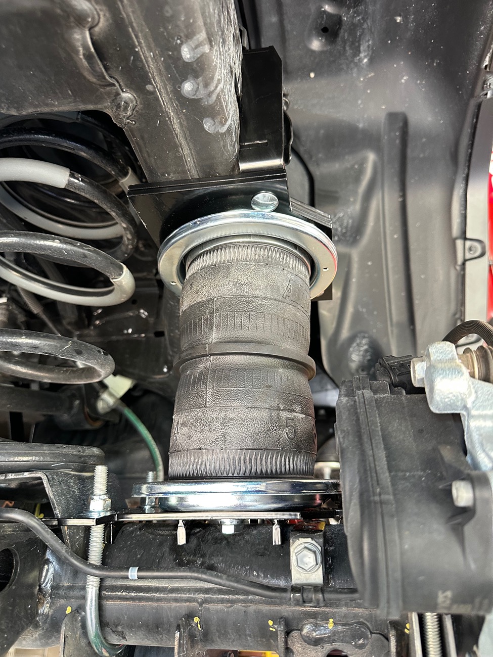

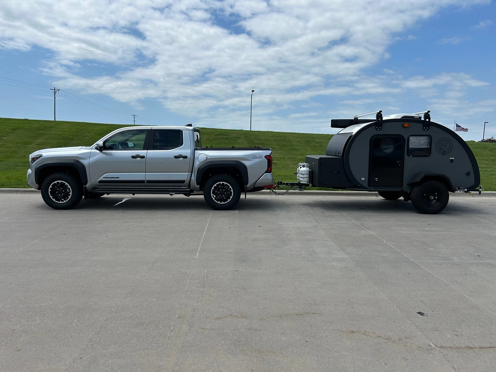

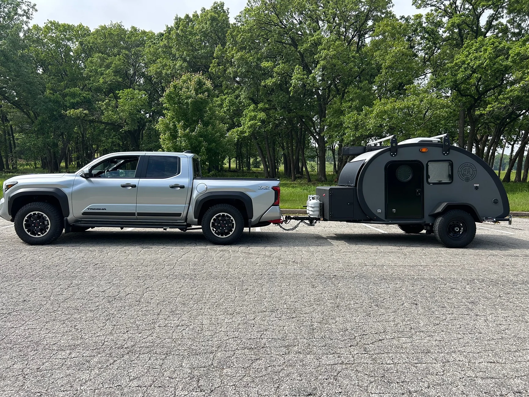

I had the Wireless One with EZ mount installed on my Tacoma OF to eliminate sag while towing. No other modifications needed. Works perfectly. Better ride quality. The best part is I just push a button to inflate and deflate. Here is a before and after pic.
I've also been looking at that. Is it the 25980EZ model number? Where was it mounted? Would love some pictures if you can.

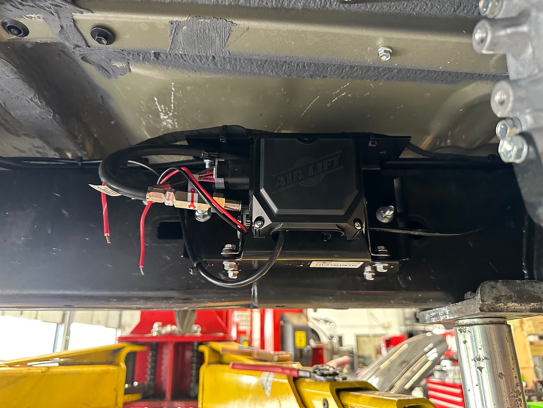

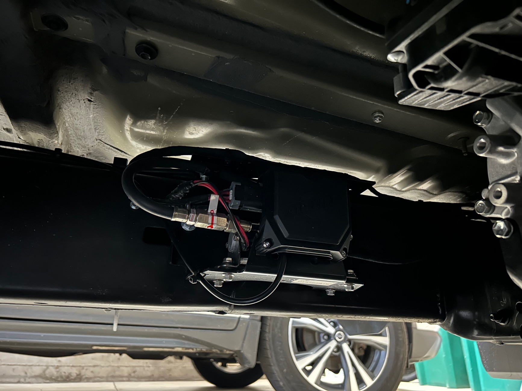

The air bags are being delivered today so the plan is to remove the Alldogs springs and install those today, then possibly install the wireless compressor system after the fact.

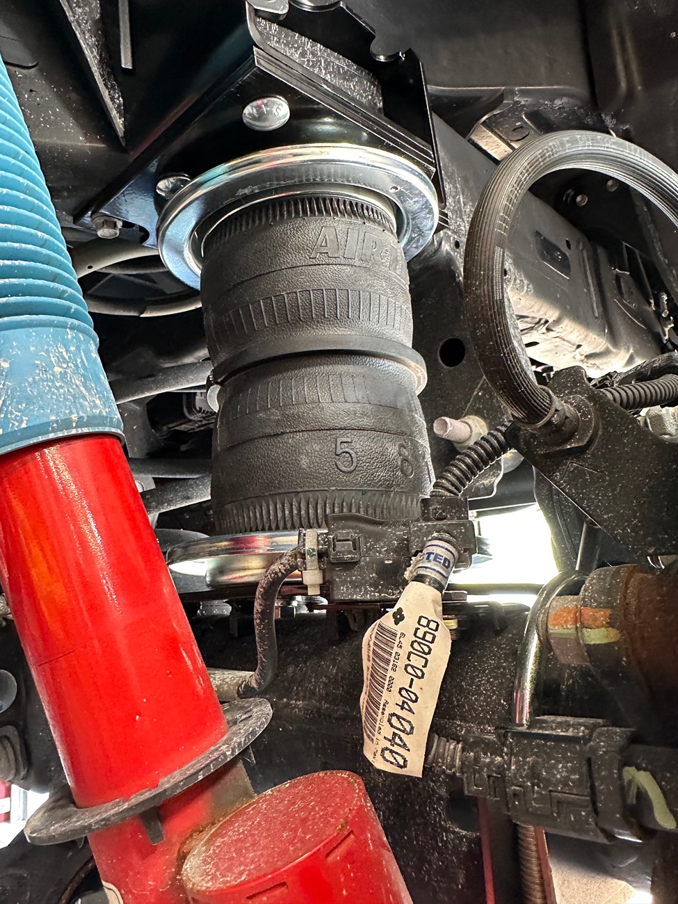

Yes, that’s the model number. The compressor is mounted on driver side on the inside of the frame. Here are some pics:

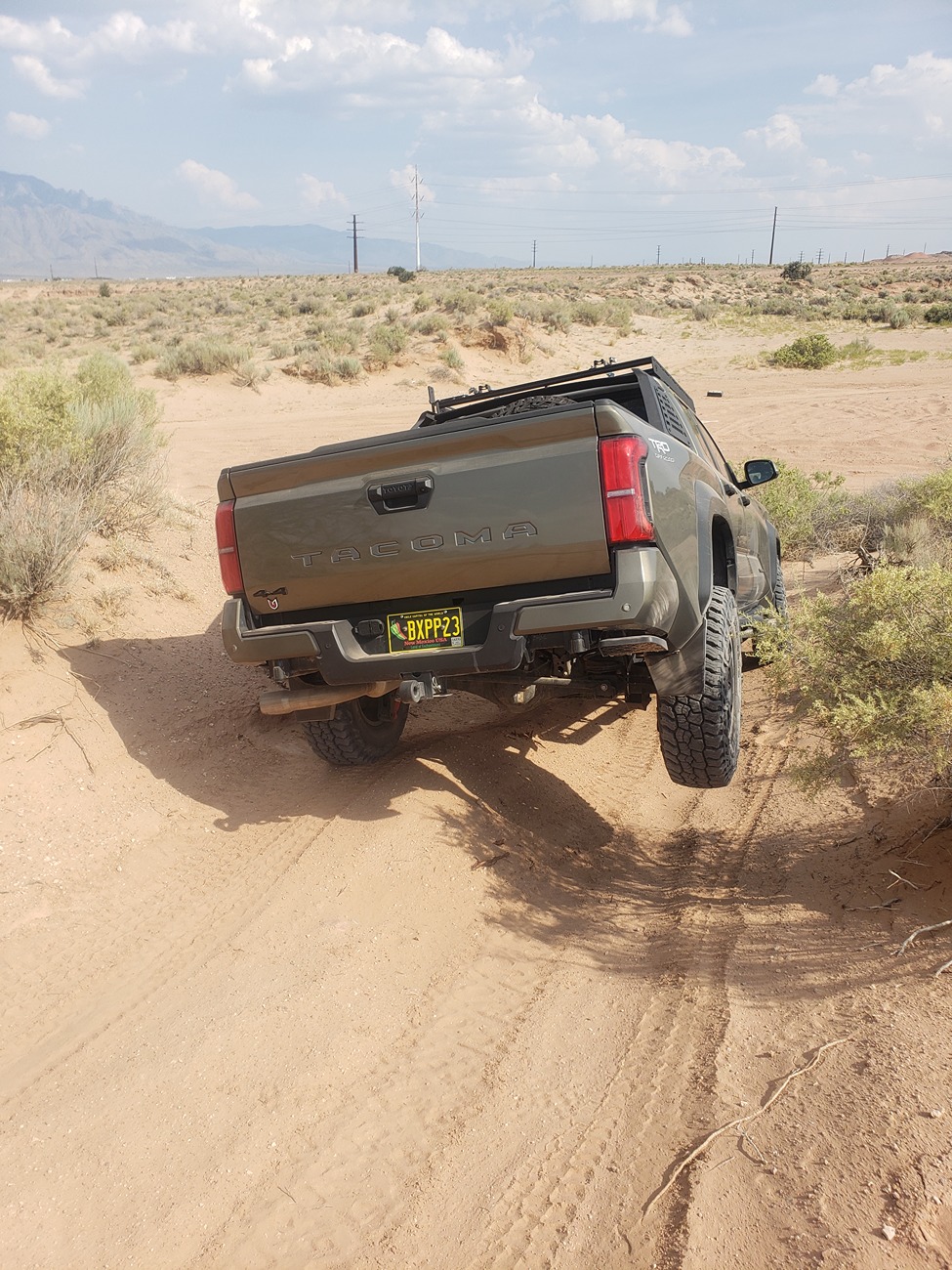

Did you use any spacers with the cradle to raise it up closer to the air bags, or no?
I did not use spacers. The cradles are needed if you are going to get suspension dangling onsn off camber situation. If the bag is fixed on both ends it would get pulled apart
