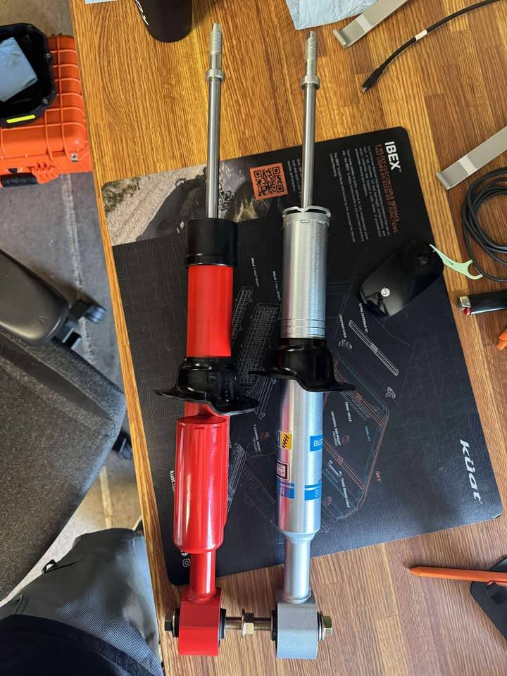

I reached out to Alldogs about these when they made a teaser post about having the 4G 5100s in stock. the perch sits higher on the 5100 so there should be a small amount of lift even at the bottom setting. length wise, the email states that there is less than a 1/4" difference in length between the 2 both front and rear.
Here's some photos i was sent.
Overall, these don't necessarily look like an upgrade over the factory red Bils unless you want to lift with your OE spring.
I believe these OR Bilsteins are similar to what certain trims of the Bronco come with. Seems very similar, if not the same shock.
