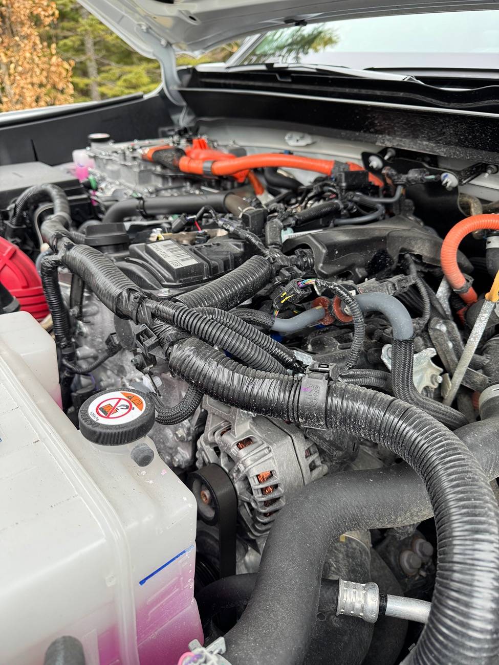

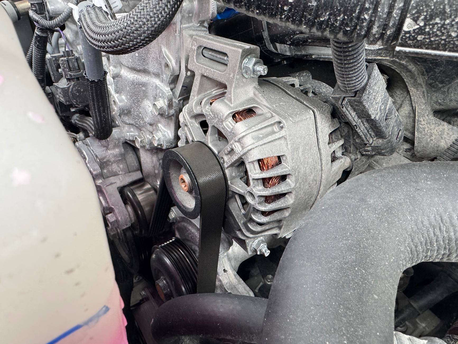

2025 TRD Pro
No alternator on the hybrids.
There is an alternator or at least something that looks like one, I use my truck everyday so I don’t have the same problems, but I thought the truck started from the hybrid battery?
