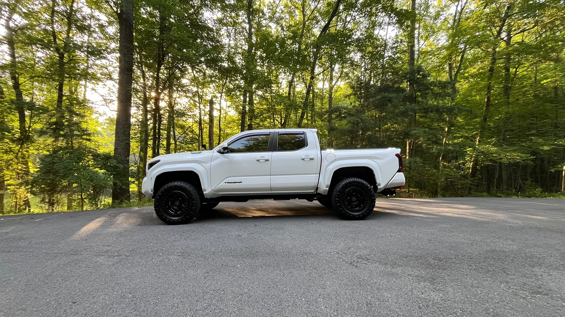

Iā€˜m parked on a slight decline but there is a small rake stance with the OEM Trd set up. Now I just need some 34ā€ tires lol
