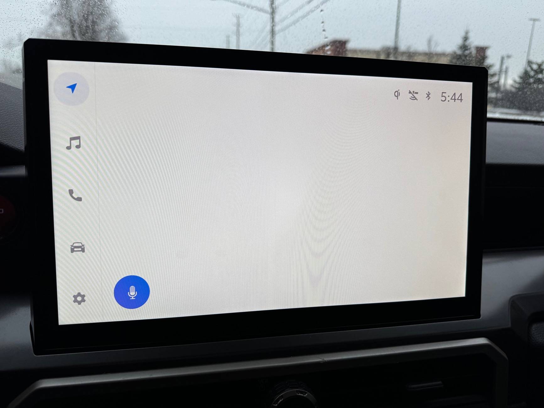

I had issues with head unit, used to reboot randomly. Dealer ordered a new head unit, waited 5 months for it. Was installed two weeks ago, get into the truck, and tech never checked, but the new head unit was worse than the old one. Dealer tells me that Toyota uses reman head units for warranty repair. Super angry‼ Been waiting to hear about a replacement, sure hope it doesn’t take 5 months - Toyota is going to be getting a phone call soon.
2024 Tacoma CarPlay keeps failing IMG_1741
