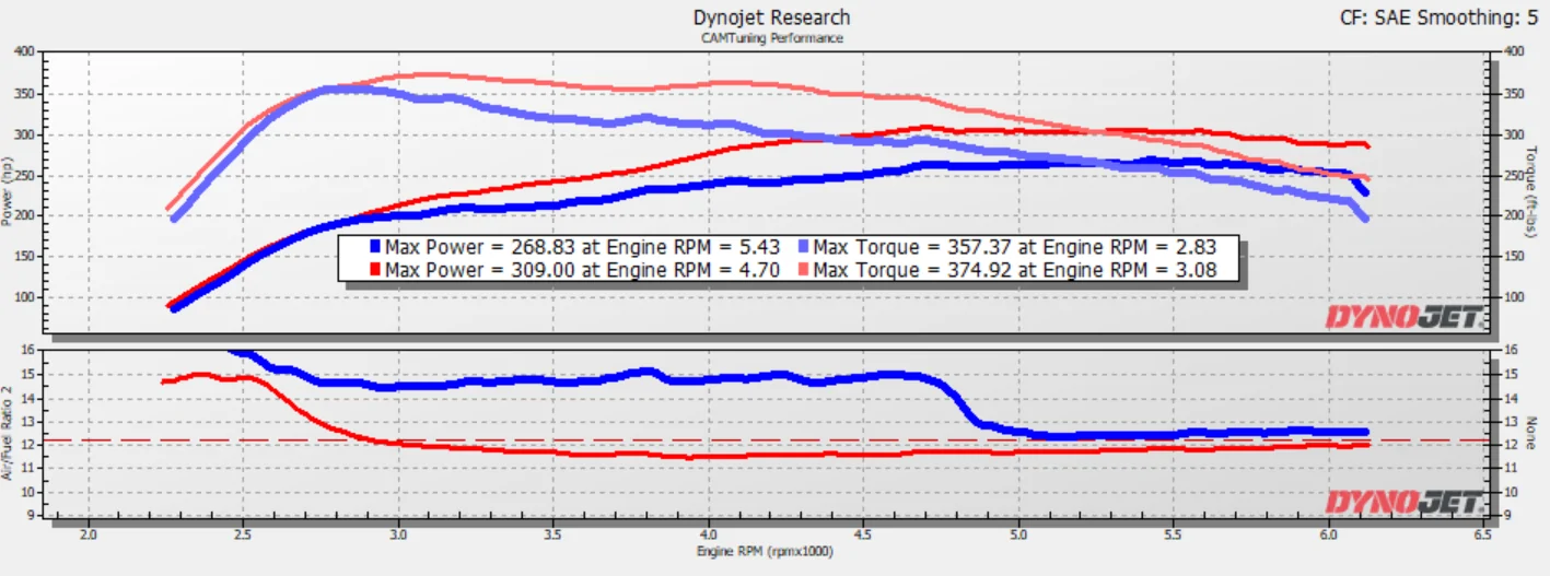

I am excited to announce the official release of CAMTuning's in-house developed Tacoma and 4Runner performance maps. Our dedicated efforts, including extensive dyno testing and real-world road tuning on our development Tacoma have yielded significant enhancements in both power output and overall drivability compared to stock and other off the shelf calibrations. Power delivery, throttle response, and transmission control have all been optimized. Stock vs tuned map.

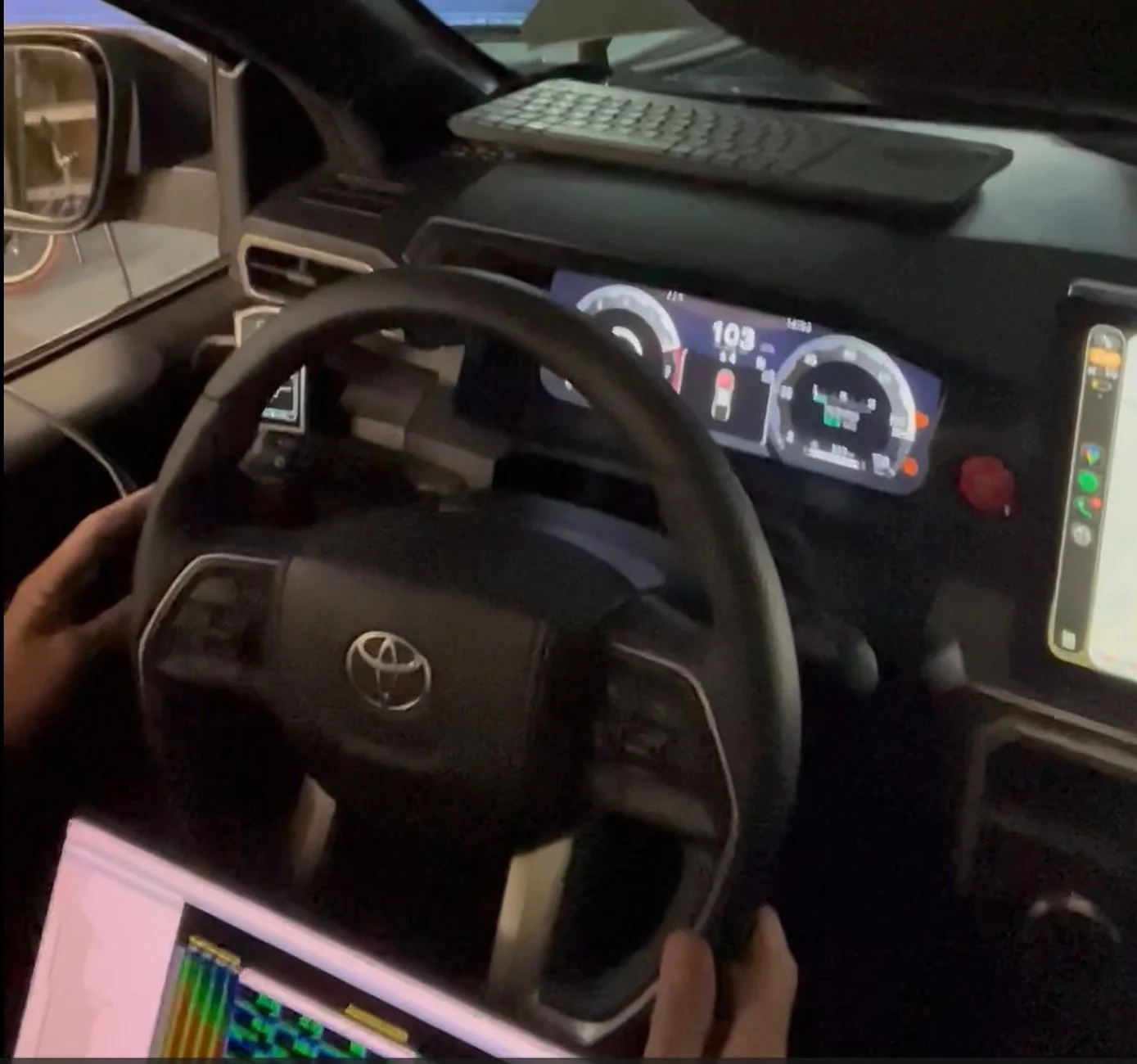

For a limited period, we are offering our CAMTuning Stage 1 map for the Toyota Tacoma for FREE when purchased in conjunction with an Accessport from https://www.camtuningperformance.co...2024-2025-tacoma-stage-1-map-91-93-accessport using code "tacoma4g" at checkout. This map is specifically engineered for vehicles with stock configurations, utilizing either OEM or "OEM-like" intake systems such as those from SXTH, K&N, and Stillen. If your vehicle is equipped with an alternative intake system that necessitates custom tuning, please do not hesitate to contact us, as we are fully equipped to provide such services.
