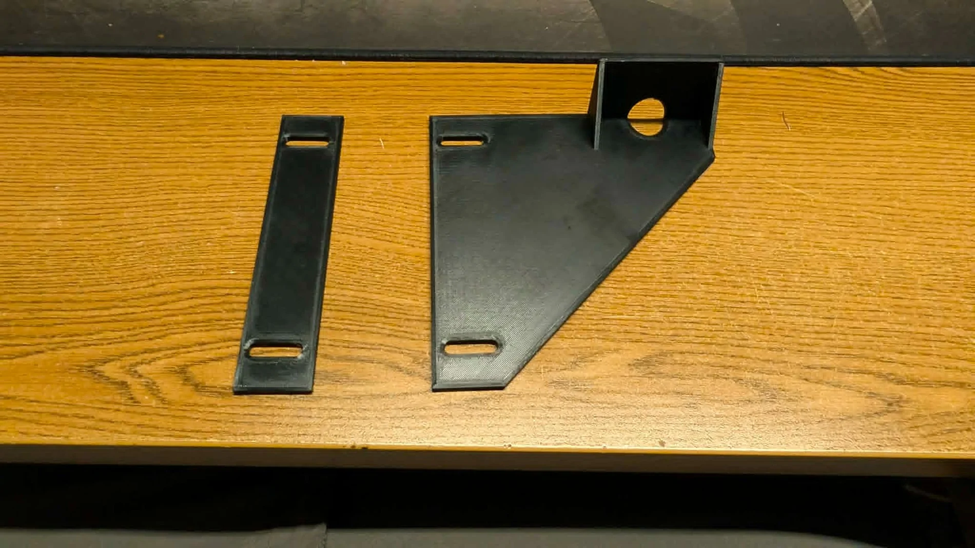

Mounting Bracket
2024 Tacoma COMPLETE: DIY Rear Mounted Camera License Plate Bracket a001141d-127b-47cd-8684-6630375b0abf
> Revision 1 required about 3mm to be removed from the bottom of the plating in order to fit the Tacoma's pre-existing mounting location and bode with the traction bumps that exist.

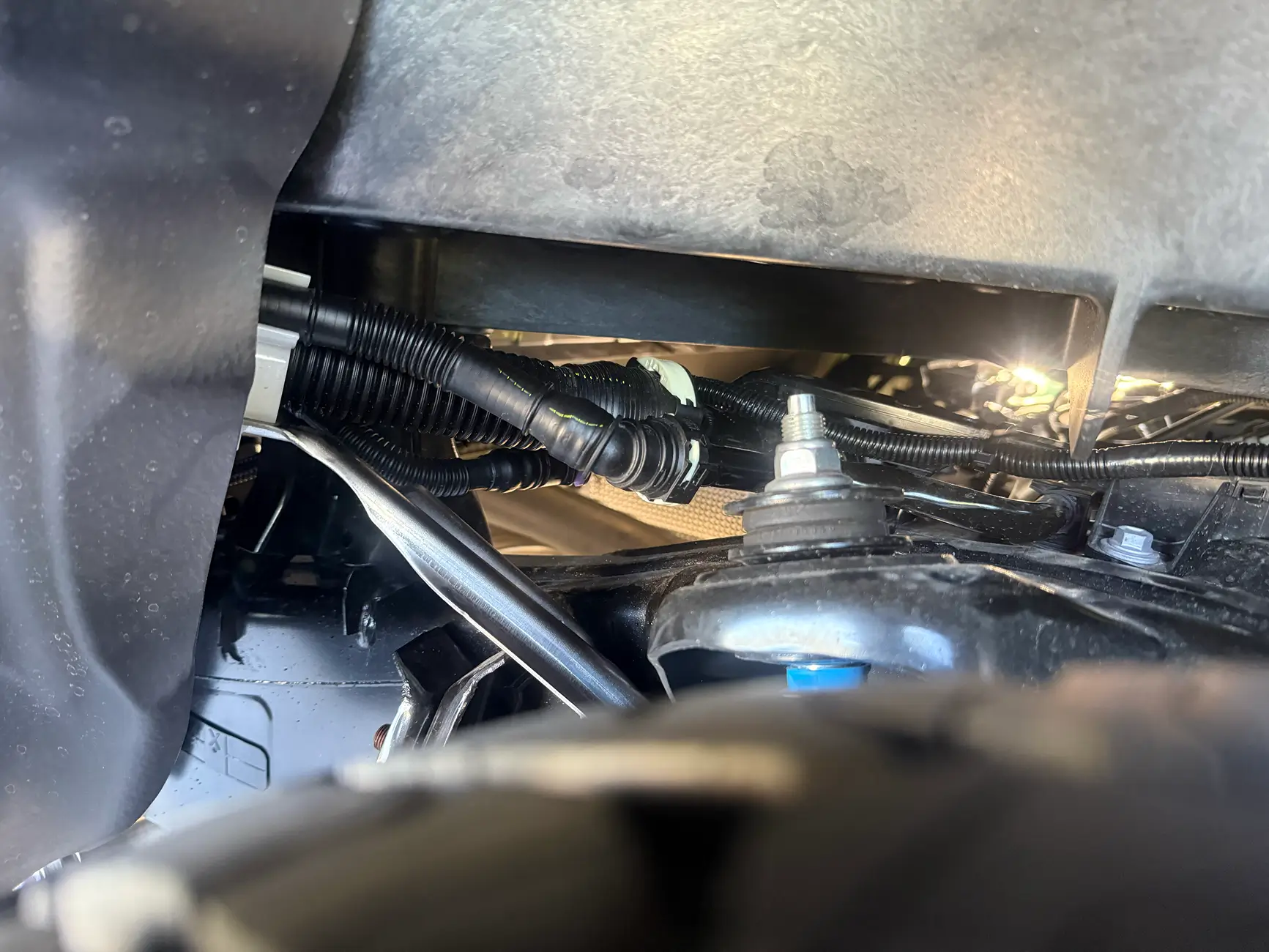

  2. Plan: Review underneath the truck to identify which grommet has a pre-existing loom of wires leaving it from the rear (easiest spot to perform this job). Confirm your route from the bottom of the cab to the bed along rail system.

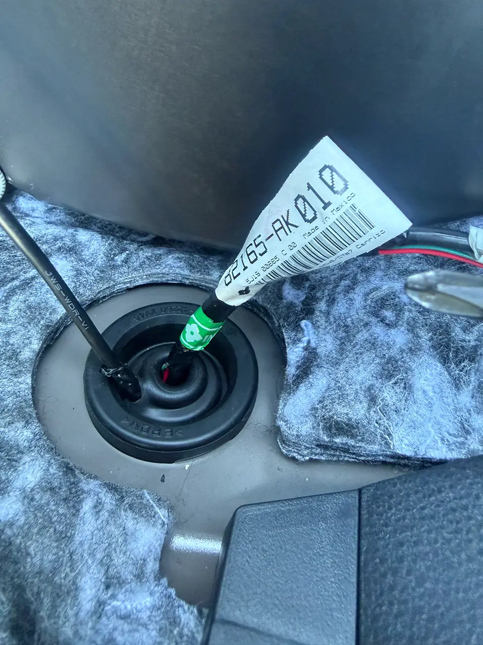

  5. Do: Remove the panel on the floor (use pry tool to pop clips), push in the pins and take them out with the pry tool (easy to remove) and remove the side of the tub to access the grommet.
  6. Do: Feed rear camera wire through pre-existing loom of wires. This appears tricky and tight, might require cutting though try to avoid then you could avoid the silicon step later on.
    NOTE!!! The rear camera input is a right-angled jack that does not feed through the pre-existing grommet nipple, I goofed and went in the reverse which required cutting.

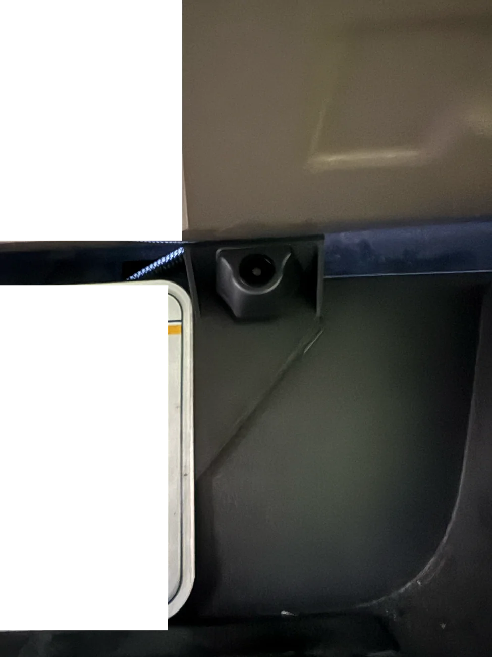

2024 Tacoma COMPLETE: DIY Rear Mounted Camera License Plate Bracket mounted_bracket_no_plat
> Plate mounted with camera inside, cable carries itself over into the backing area where pre-existing looms connect / pass through tailgate.

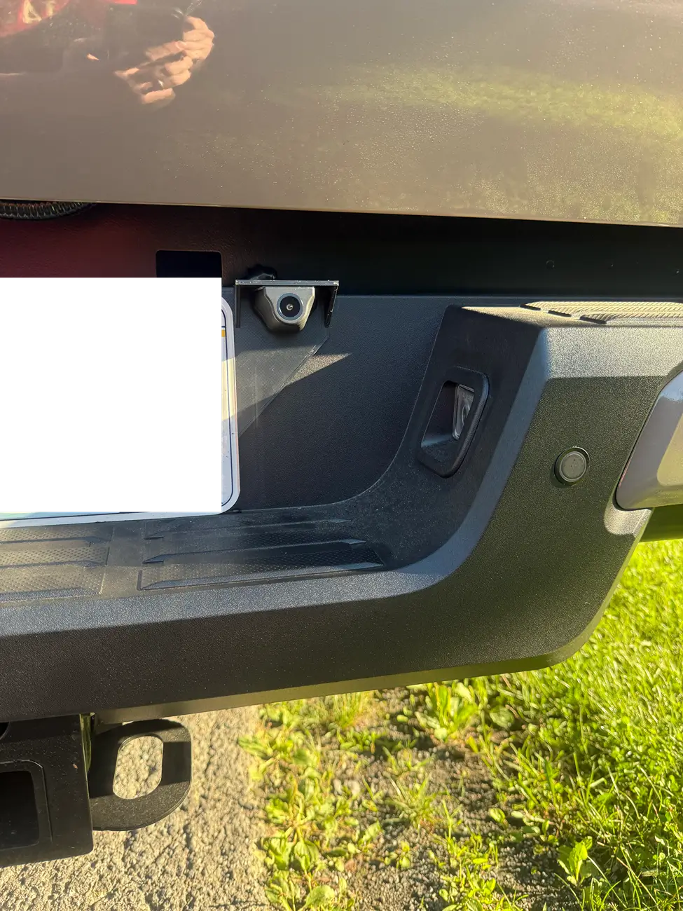

2024 Tacoma COMPLETE: DIY Rear Mounted Camera License Plate Bracket tailgate_hat
> Clearance when tailgate is dropped. Suggested drop of camera housing might be ideal though doesn't impact it.

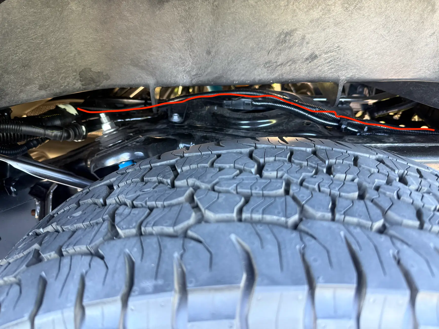

2024 Tacoma COMPLETE: DIY Rear Mounted Camera License Plate Bracket rear_wheel_well
> Red line shows the pathing that was taken, clamps every so often. Clamps are oriented where the zip tie connects the closing ends, allowing both looms to sit inside comfortably.
2024 Tacoma COMPLETE: DIY Rear Mounted Camera License Plate Bracket rear_wheel_well_toward_ca
> Without the red line, you should notice the pathing that it takes onto the rail.

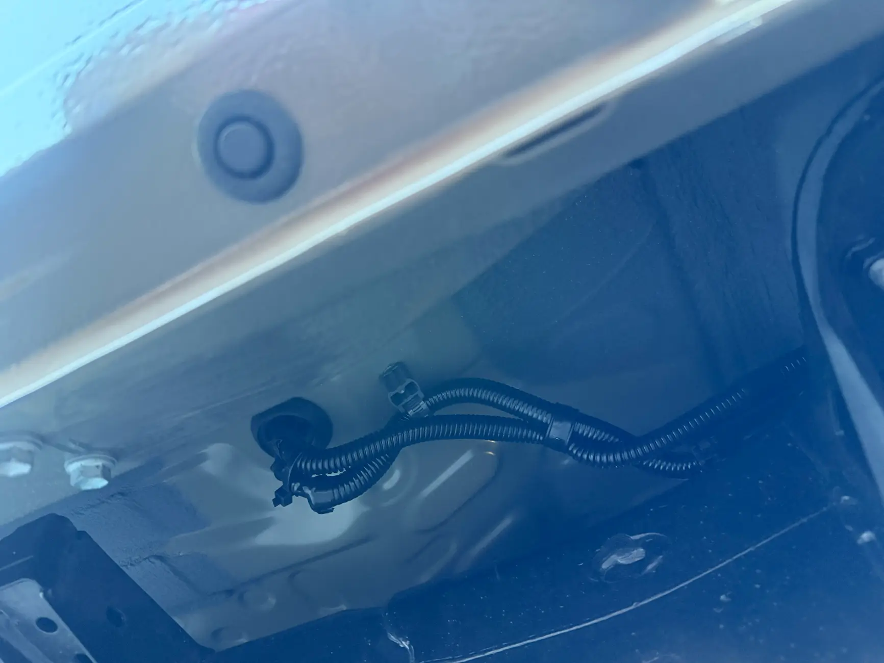

2024 Tacoma COMPLETE: DIY Rear Mounted Camera License Plate Bracket IMG_8107
> Loom meeting with pre-existing loom.
DO NOT START FROM THE REAR 😂

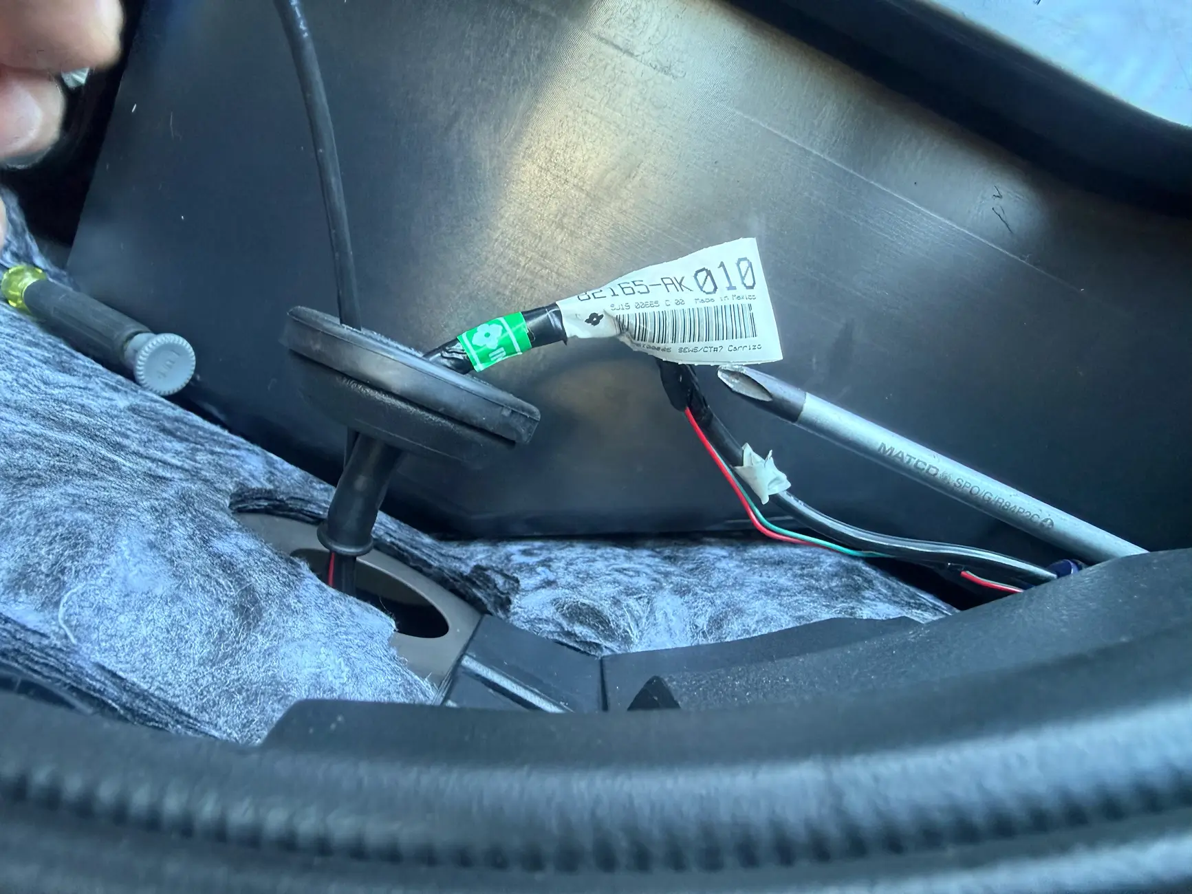

2024 Tacoma COMPLETE: DIY Rear Mounted Camera License Plate Bracket grommet_nippl
> Grommet cut to feed the jack through. TL;DR has this going the other way to avoid cutting at all costs, reusing the factory grommet + nipple (No premium === no nipple on the driver side at least)
2024 Tacoma COMPLETE: DIY Rear Mounted Camera License Plate Bracket grommet_wire_fed_mounted
> Grommet once mounted back into housing. Use Silicon if you wish, I had because of being a dummy and doing this in reverse.

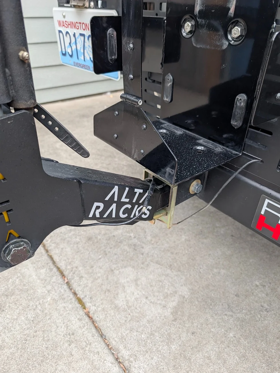

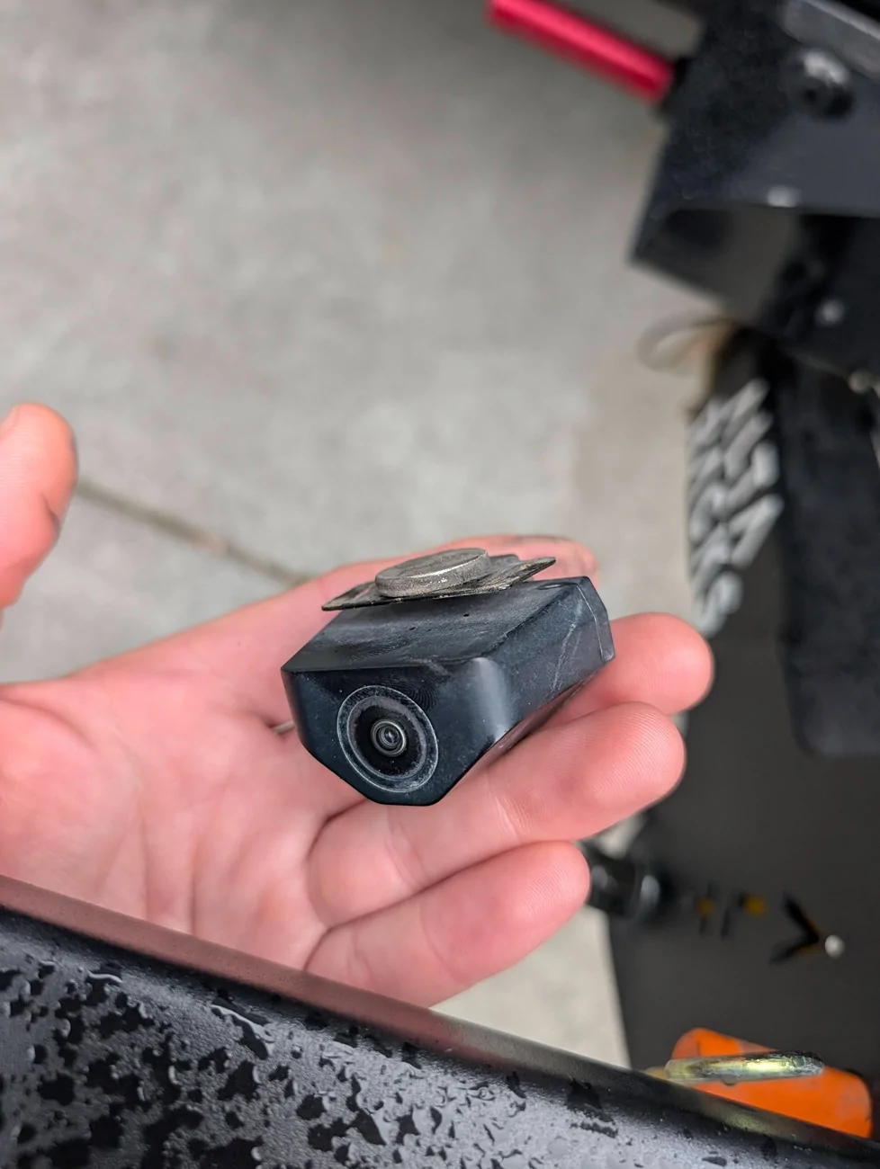

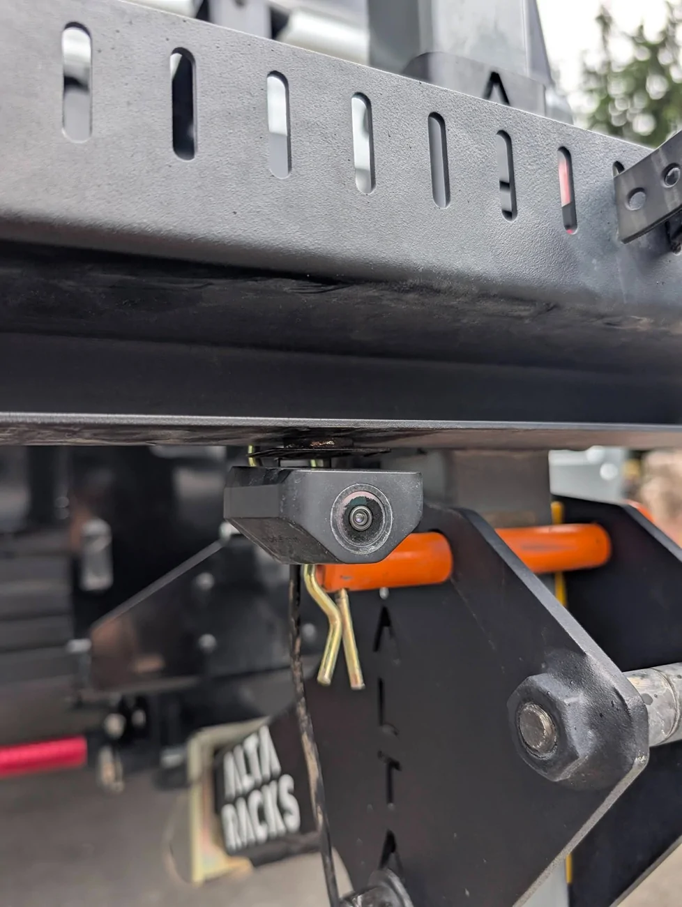

This might seem overly simplistic and not very elegant but it works great for me and my needs. I slapped a magnet on my camera and move it around to meet whatever configuration I'm running. For example, right now my bike rack is on the truck so I've moved the camera to the rack. If I don't have either the bike rack or swingout on the truck then I stick the camera inside the hitch receiver and it's completely protected from the elements.
Nice. Did you just glue it on ? Or double sided adhesive ?

I'm using the little metal bracket that (I think) came with the camera so the magnet is all I need. You could certainly use double sided tape and stick a magnet to the camera. That would probably work better actually since the camera moves a bit sometimes but it works well enough for me as is...
Thanks dude !
Going to give it a try.
