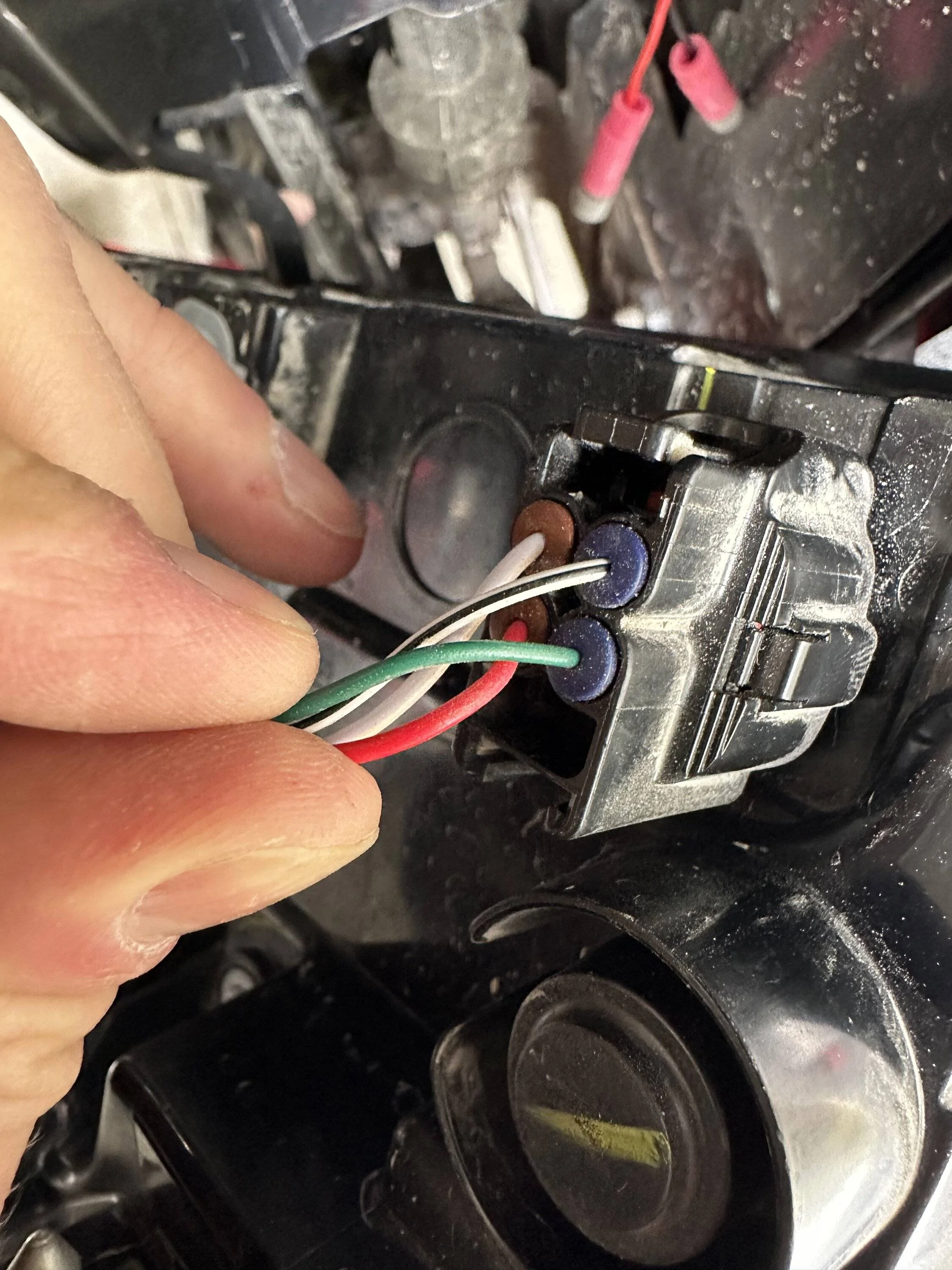

Does any know the correct wiring for the tailgate lights? I’m trying to determine what wire is for the break light and what is the ground/neutral . I attached a photo

Just grab a friend and an ohm meter. Six bits the green is the ground but it's easy to test with a meter. Once you find that, have your bud step on the brake and you're meter will show you the hot wire.

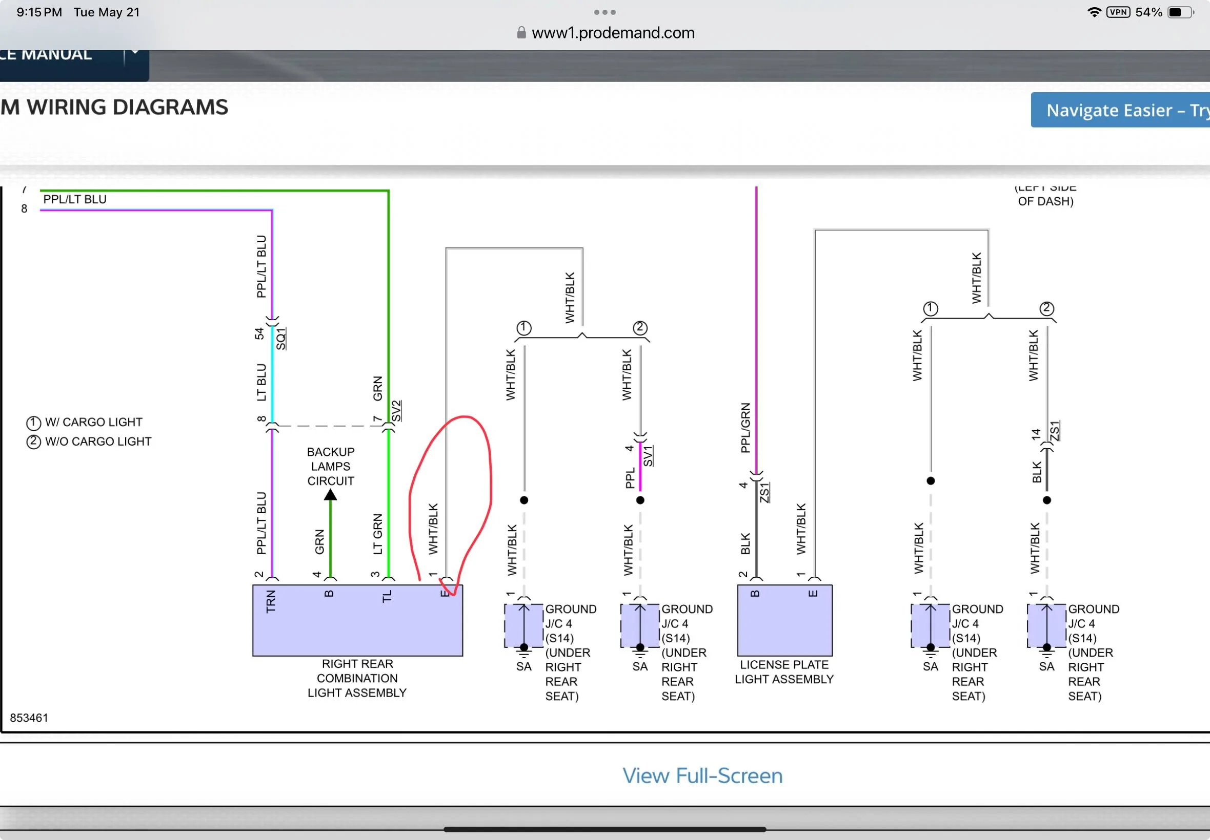

White wire with black tracer is the ground, light green is the power wire. Just realized I attached the wiring diagram for the RHS twilight, but looking at the wiring colours in your photo, that’s the LHS connector …. Either way, white/blk is ground, green is power. A power probe or a test light would give you answers too.

On my 2025 Trailhunter - the WHITE wire is power & the White (black strip) is ground.
