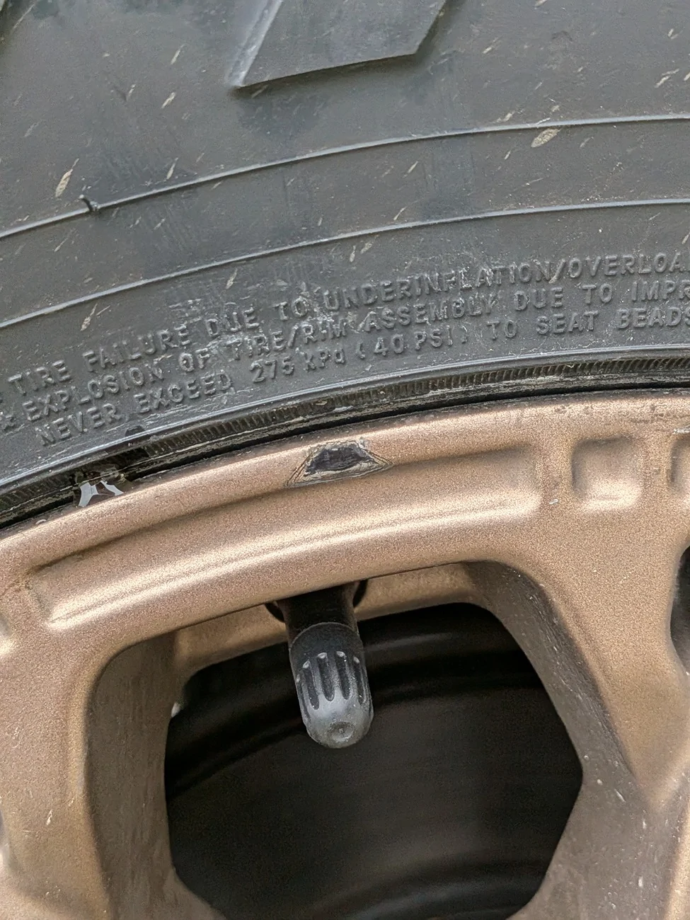

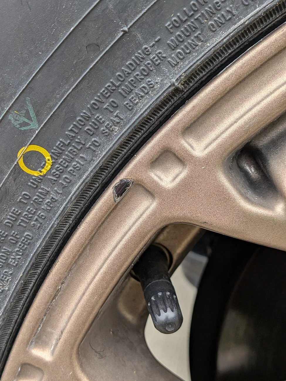

Luckily (as you guys know) I take a shit load of photos of my truck. I can at least narrow it down to the chips were not there prior to the new tires and are seen there pretty are soon as I got 2 miles home from install.

I’ll tell you exactly how that happened. When they installed new valves, they likely pried against the side of the rim pulling installing the new valves. Assuming new valves were installed.

They were. And both the chips are right at the valves. So irritating man. I just don't know where any pride in workmanship is lately.

That’s your answer How it happened. No doubt about it.

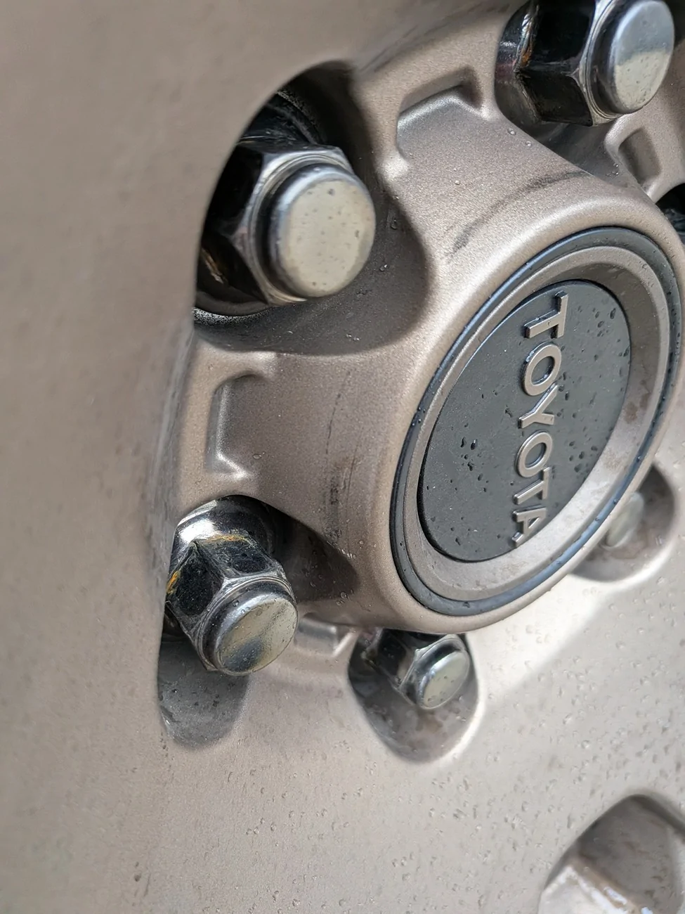

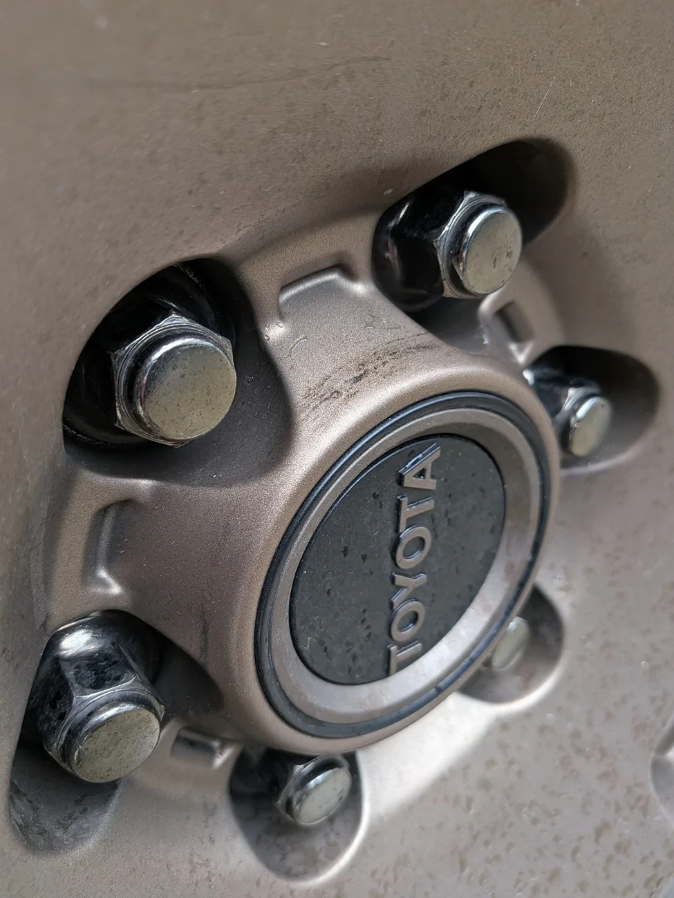

I recently bought a couple sets of tires and went through a couple tire changes at Discount Tire. I didn't think to closely inspect everything after the last set of tires were installed which was about a week ago. I was getting my PSI dialed in today and noticed 2 chips on 2 different wheels (LF,LR) along the edges of the wheels and scuffs on all of the center caps. I did a quick Google search and the chip depths and locations seem to align with some other folks' experiences of damage after tires changes.
I don't want to go in there and cause a bunch of trouble, but I also haven't been off road and haven't even parked next to a curb since the install (no rash on the tires either). Haven't even been on the freeway for more than 10 minutes at a time.
Have any of you had this happen ? What do you guys think ?
It's 100% this. Call or visit them ASAP to report the damage @PNWkip .

Thanks man. I reached out to the store, corp. customer service, and the BBB to cover my bases.
I wanted to let it go, but I can definitively say it was them after reviewing some side profile photos I happened to take before and after the install. I asked them to either purchase two new wheels directly from the dealership or to offer a store credit to offset the cost of a new set. We'll see what happens.

Those chips look like they were caused by the tool that they use to install valve stems. Location is correct too.

I'm 95% sure they will offer something to fix this. It might be refinishing, which is questionable depending on the vendor.
This is the tool they used. The tech levered it against the edge of the wheel to pull the valve into place. Whenever I use this tool, I put a piece of plastic against the wheel to prevent damage (I'm a DIYer working on my own wheels so I care more than average).
