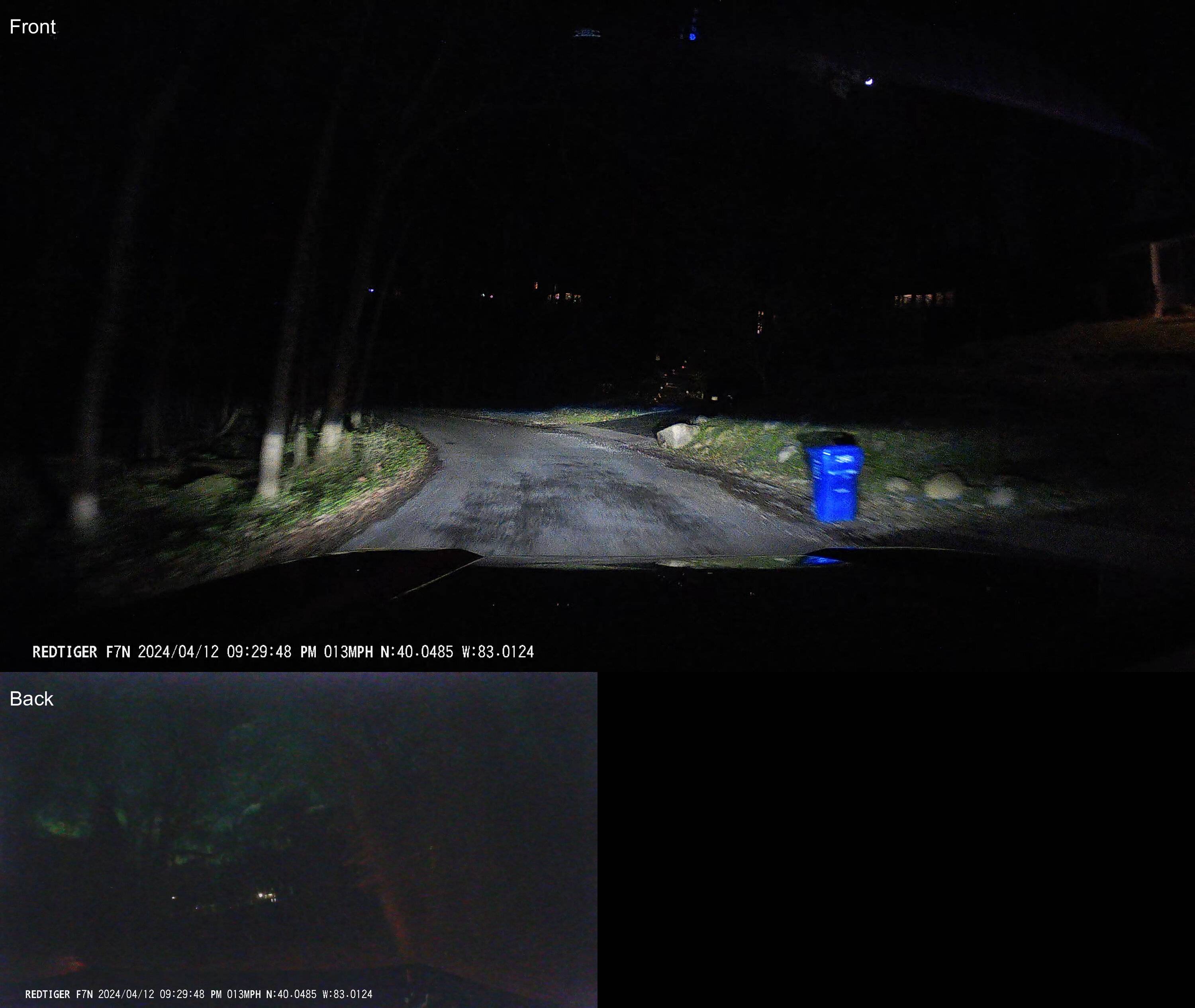

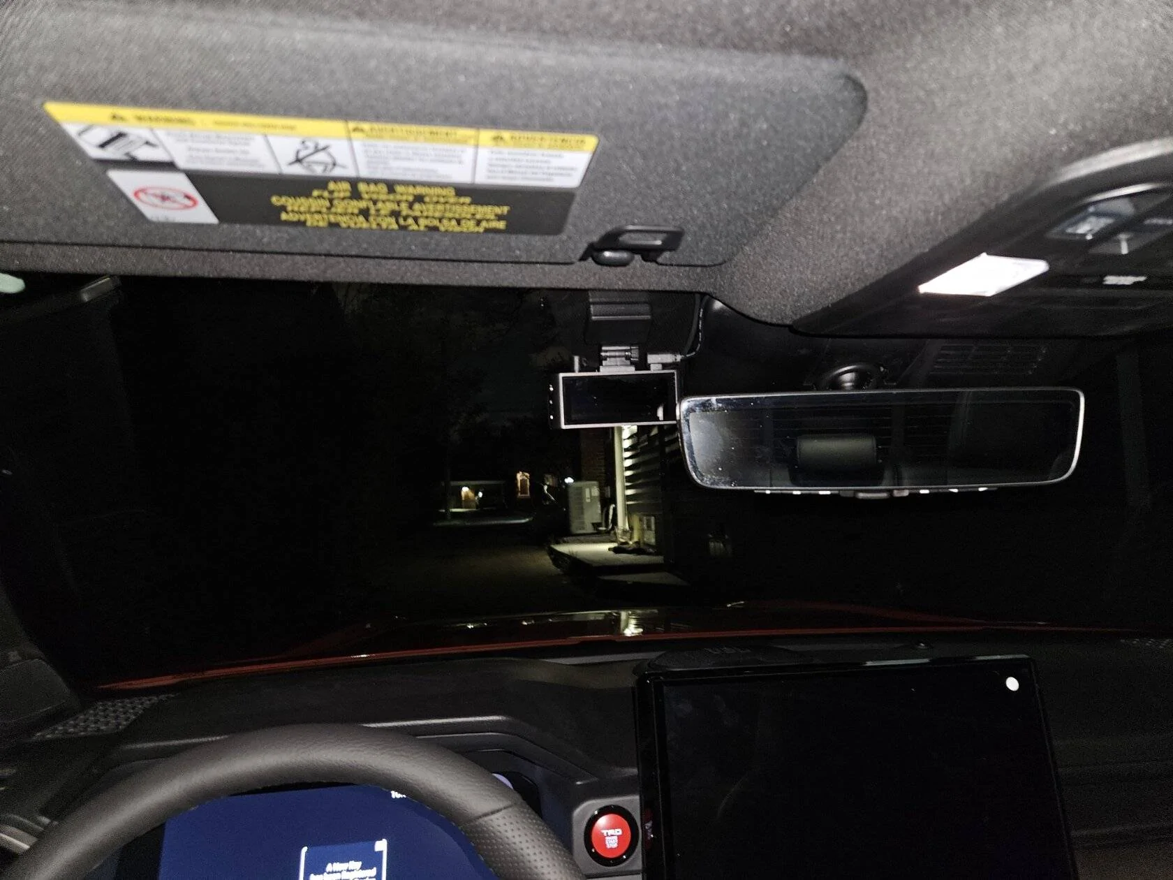

Installed the Redtiger F7N with interior rear camera in mine tonight and I'm very happy with it so far. good image even on the rear with minimal lighting. Also very small and tucked up nicely by the rearview mirror so it's not intrusive at all.
It's not direct wired yet but I will get it wired eventually so it can also do the parking monitor.
2024 Tacoma Dash Cam Solutions for 2024 Tacoma 1712976479303

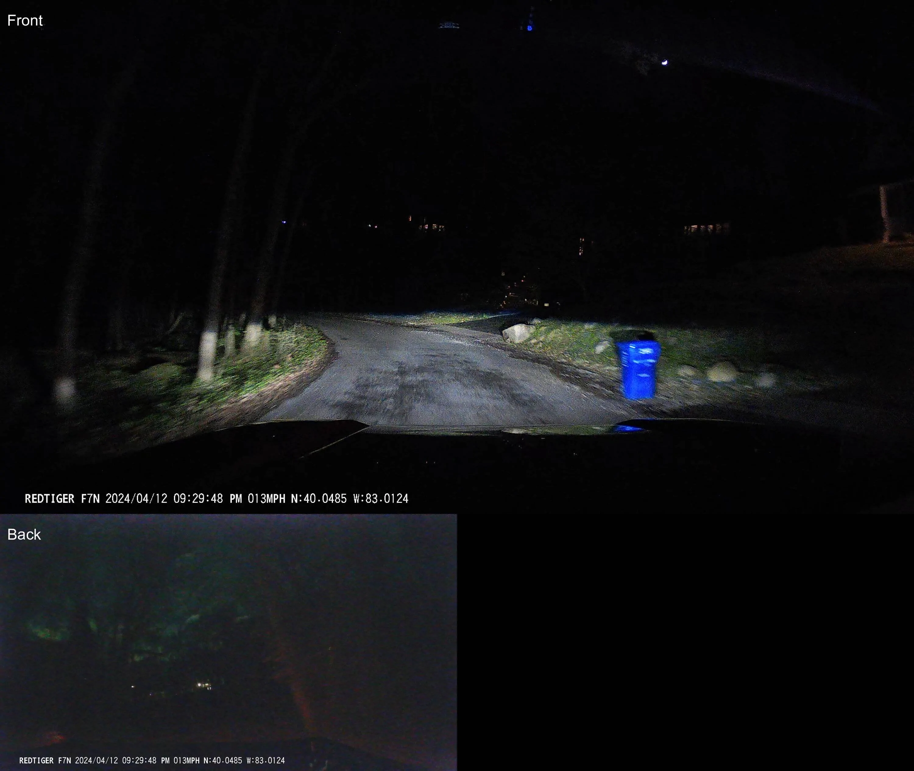

In an area with no lighting at all, it adjusted and still managed to get a vague image behind me.
2024 Tacoma Dash Cam Solutions for 2024 Tacoma 1712976462359
2024 Tacoma Dash Cam Solutions for 2024 Tacoma 20240412_225205

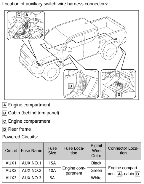

As someone that seems to be very electronics savvy, do you have any info regarding the pre wired accessory switches? I have a V1 that I'm going to try to stealth install somewhere and will want to have it on a switch to easily turn on/off.
So the switches are Ignition-On only, not surprisingly. This means they aren't useful for a camera with parking monitor mode. They do appear to have low-voltage/charge auto disconnect so you can't run your battery too low to start the truck in case of using it with ignition on but engine off.
Aux1 = 15A on the black wire of all pigtails.
Aux2 = 10A on green wire
Aux3 = 5A on white wire
There is 1 connector in the engine compartment and 1 in the cabin above the driver footwell.
So you just connect to the appropriate wire on the pigtail for which switch/fuse you want to use.
These are A and B below. C and D are non-switched on their own fuse under the rear seat.
I wonder what the point of having D always on would be? Seems like a logical place for bed lighting/camp lighting accessories that would work well on a switch. Maybe the intention is adding a switch at the rear to use it while back there?

The manual actually calls that one "non-powered" so maybe it's just wiring and a fuse but not actually connected anywhere? That would mean they just put the harness in so you can use it for whatever you need to get between the front and the rear.
Not sure. Would need to get a multimeter on it to figure out for sure and at this point, I have no use for it so can't be bothered to go to the effort.

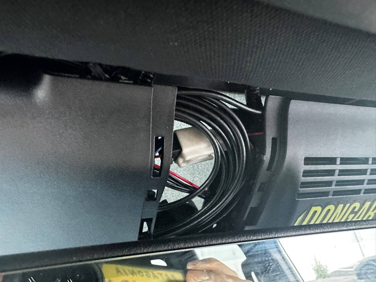

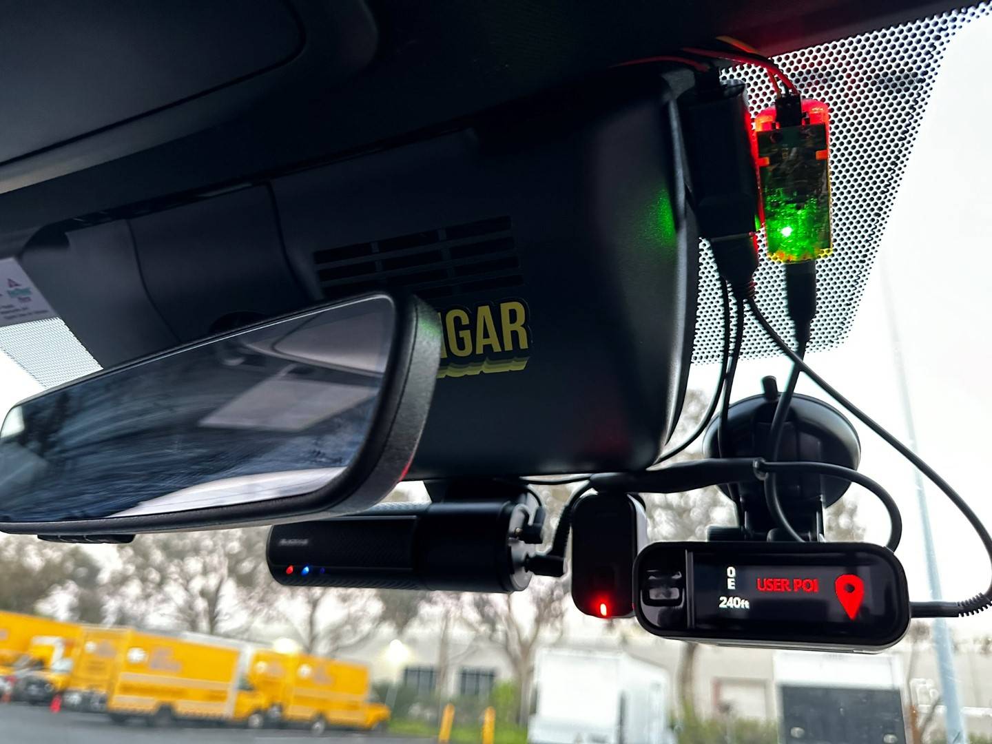

Installed the rear camera on the BlacVue DR970X-2CH, then added a USB-A to USB-C+MicroUSB splitter to power my Radenso DS1 and Garmin Mini 2!
2024 Tacoma Dash Cam Solutions for 2024 Tacoma 1713418237530
The coaxial rearcam cable included with the BlackVue is super neat to tuck into the headliner, and right under the A & B pillars! The cable has a good 3'+ of excess length but there's plenty of room underneath the mirror shroud to hide it:

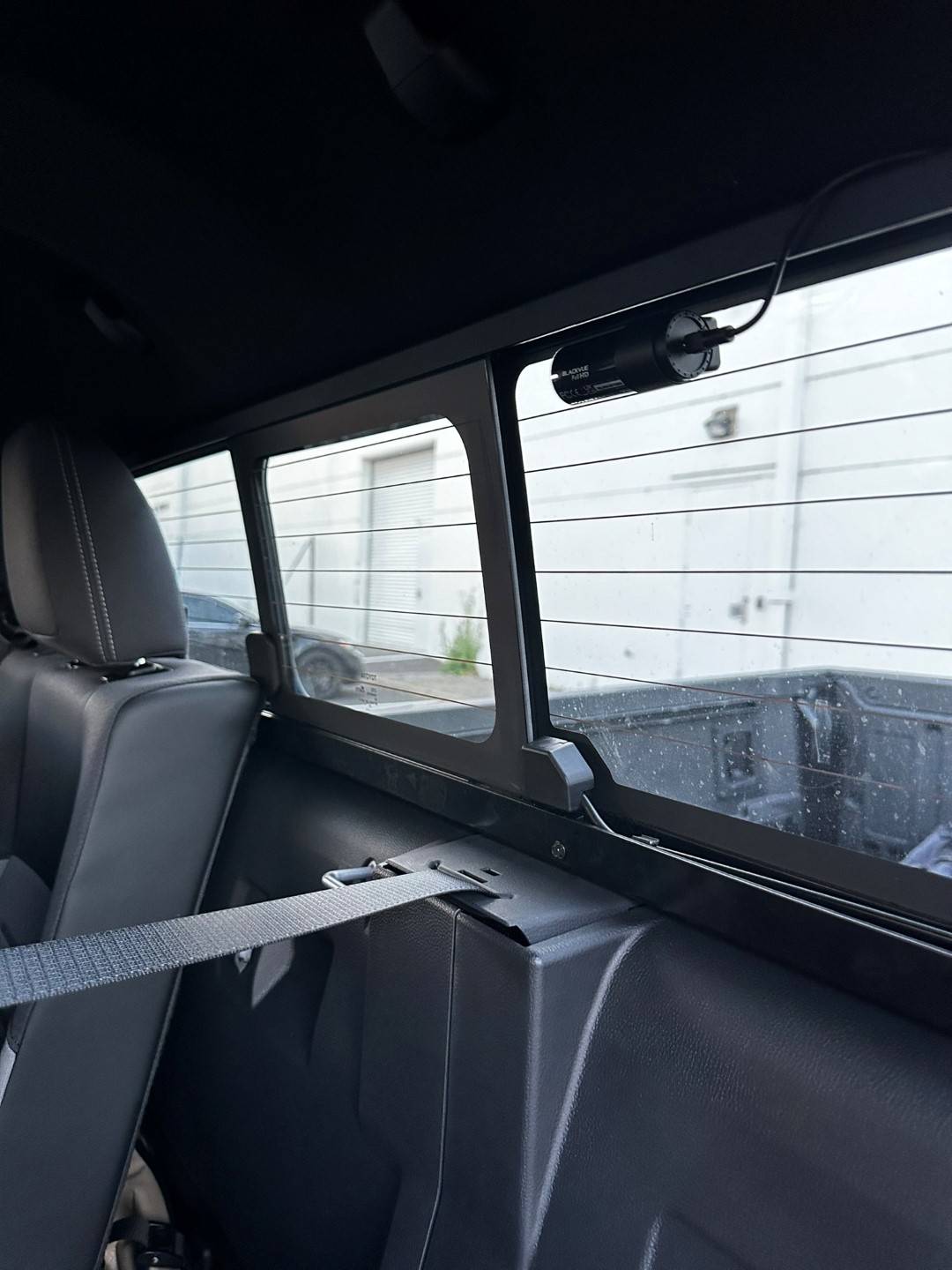

BlackVue placed on driver's side because of sliding rear window:

So current setup is:
