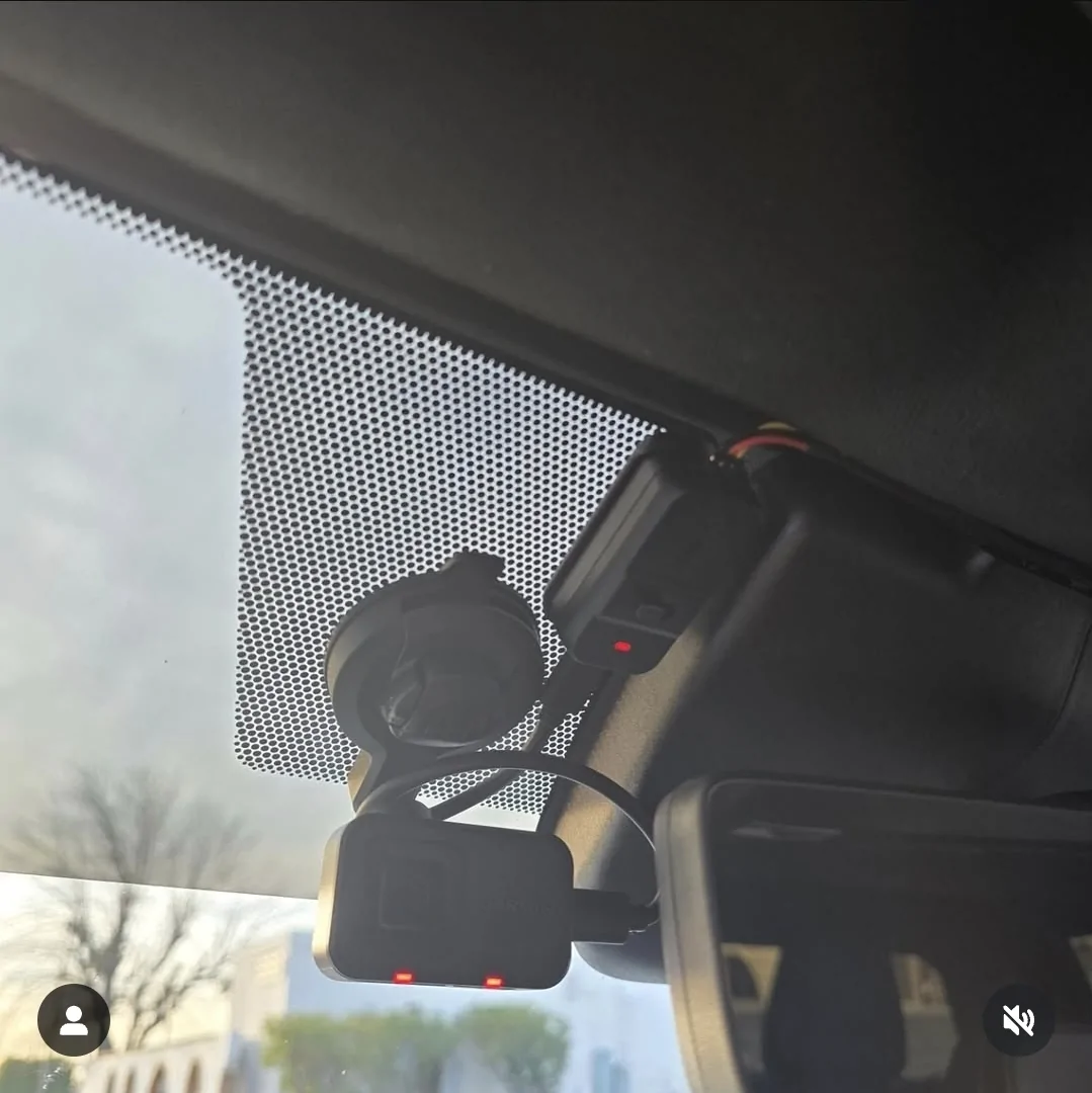

I am currently out of town. Sorry that I can't get pics of it until next week but this is how I installed it:
  • I used power from the OEM dashcam power port above the roof console that houses the dome lights.
  • I then ran that cable to the right of the rear view mirror base cover and mounted the Dongar Pro adapter (2-sided tape).
  • I then used a USB C to C cable to power the camera.
  • I mounted the camera to the windshield directly behind the mirror. Using my sightline looking at the mirror, I positioned the mount so that the LED indicators on the bottom of the camera were barely visible under the mirror.
The Dongar website has an excellent installation video.
I hope this helps!

Thanks, that is where I was thinking it might go, but I always appreciate pictures of success stories.
