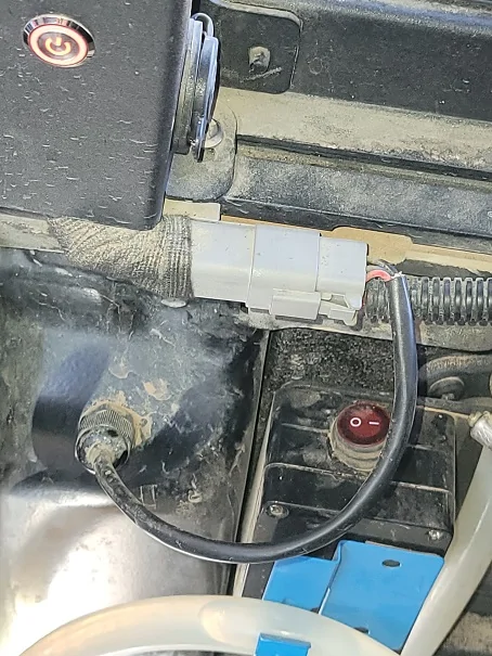

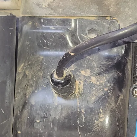

My first reaction is to get the trailer adapter from Dirtbox. Unfortunately, with my Victory4x4 bumper I couldn't use it.
If I had to do it all over again I would try something else. My suggestion is to pop out the taillight and look for a passage into the bedside. I wish I had tried to install a gland through the plastic.
Instead, I drilled into the metal next to the taillight, installed a gland, then ran a wire tap to the brake light wire. If I remember correctly, I did relay it, even though it was probably not necessary. The metal there is double wall and a pain to get through.
If I remember correctly, the wires for the running lights are also ran through that hole.
