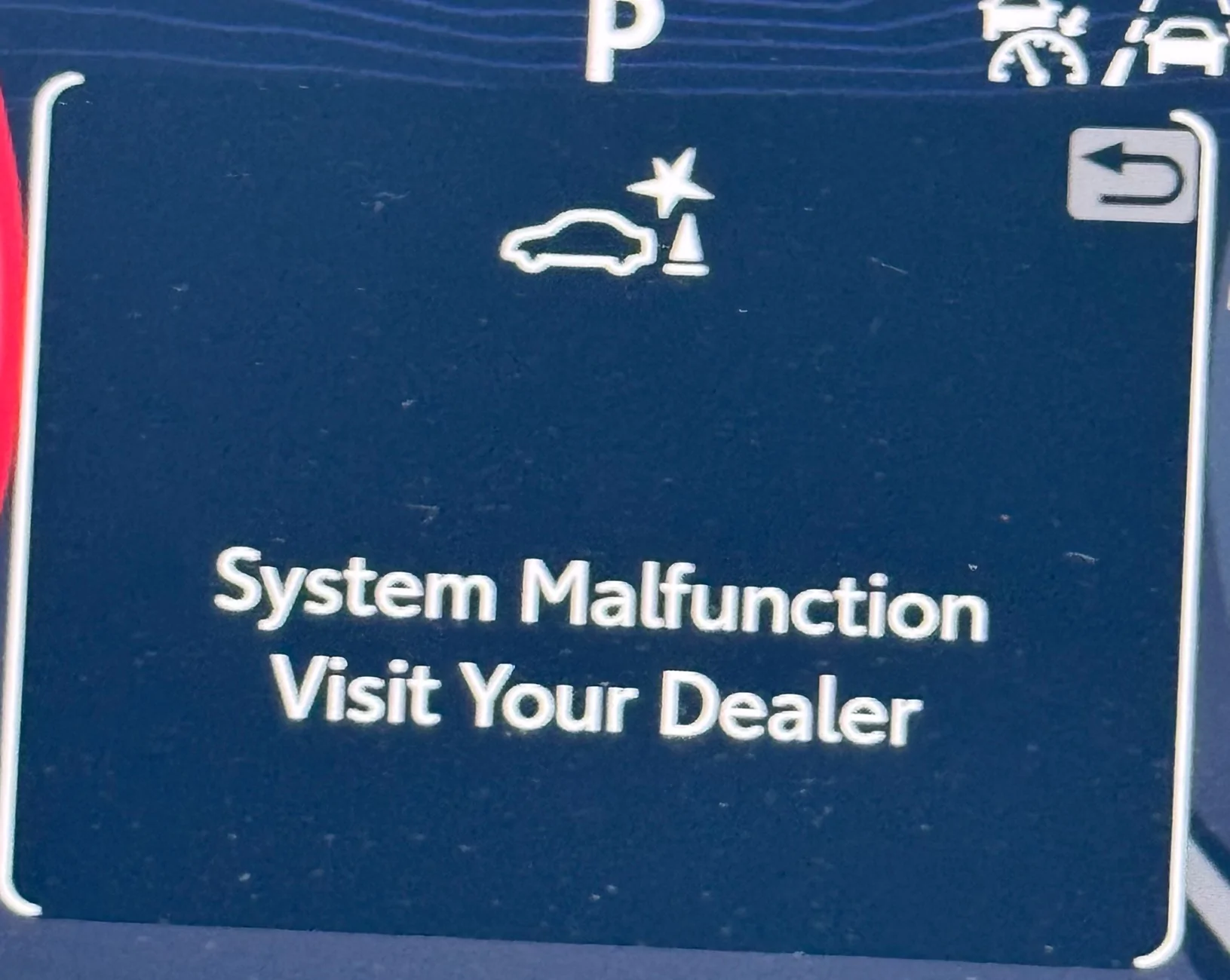

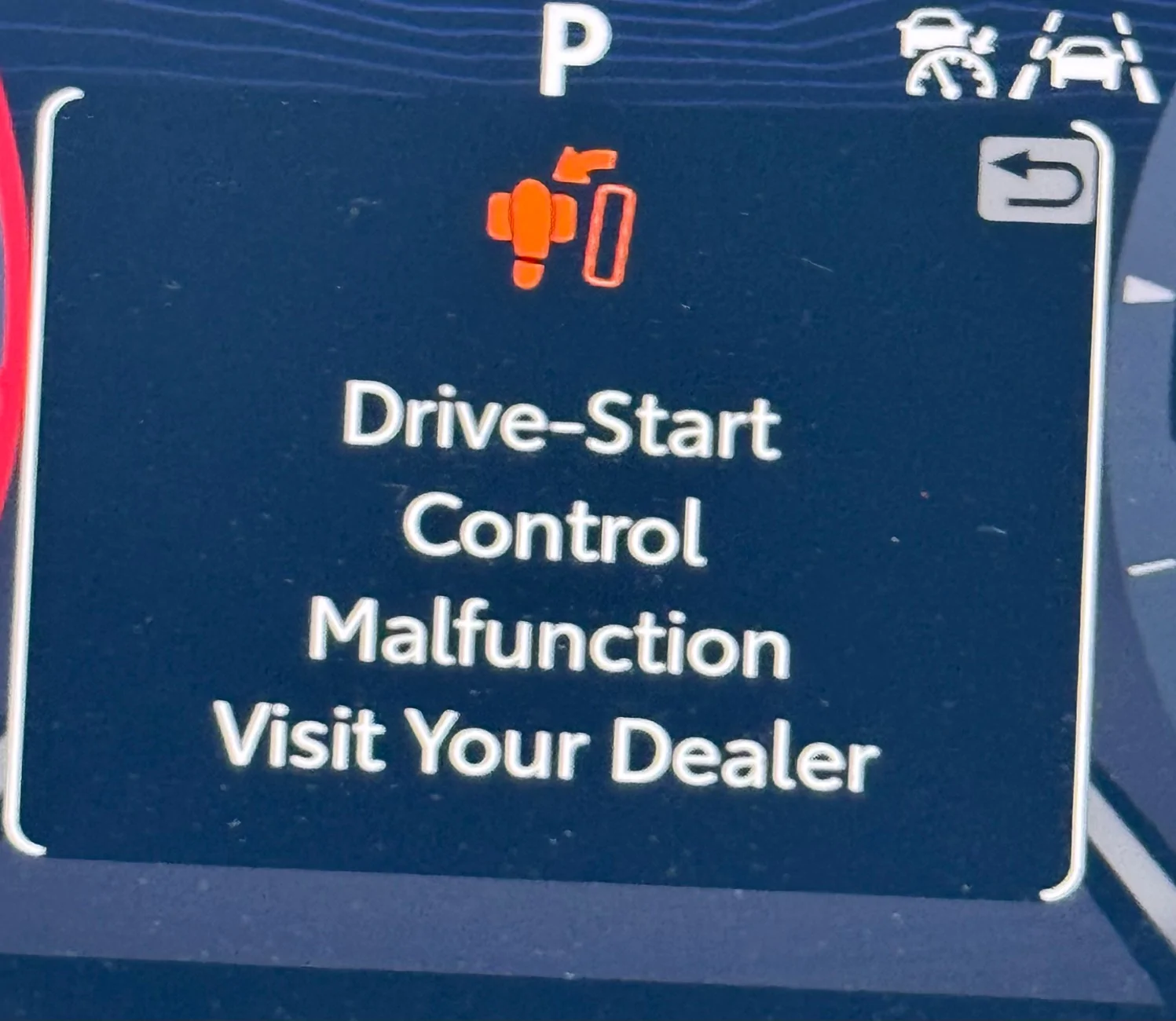

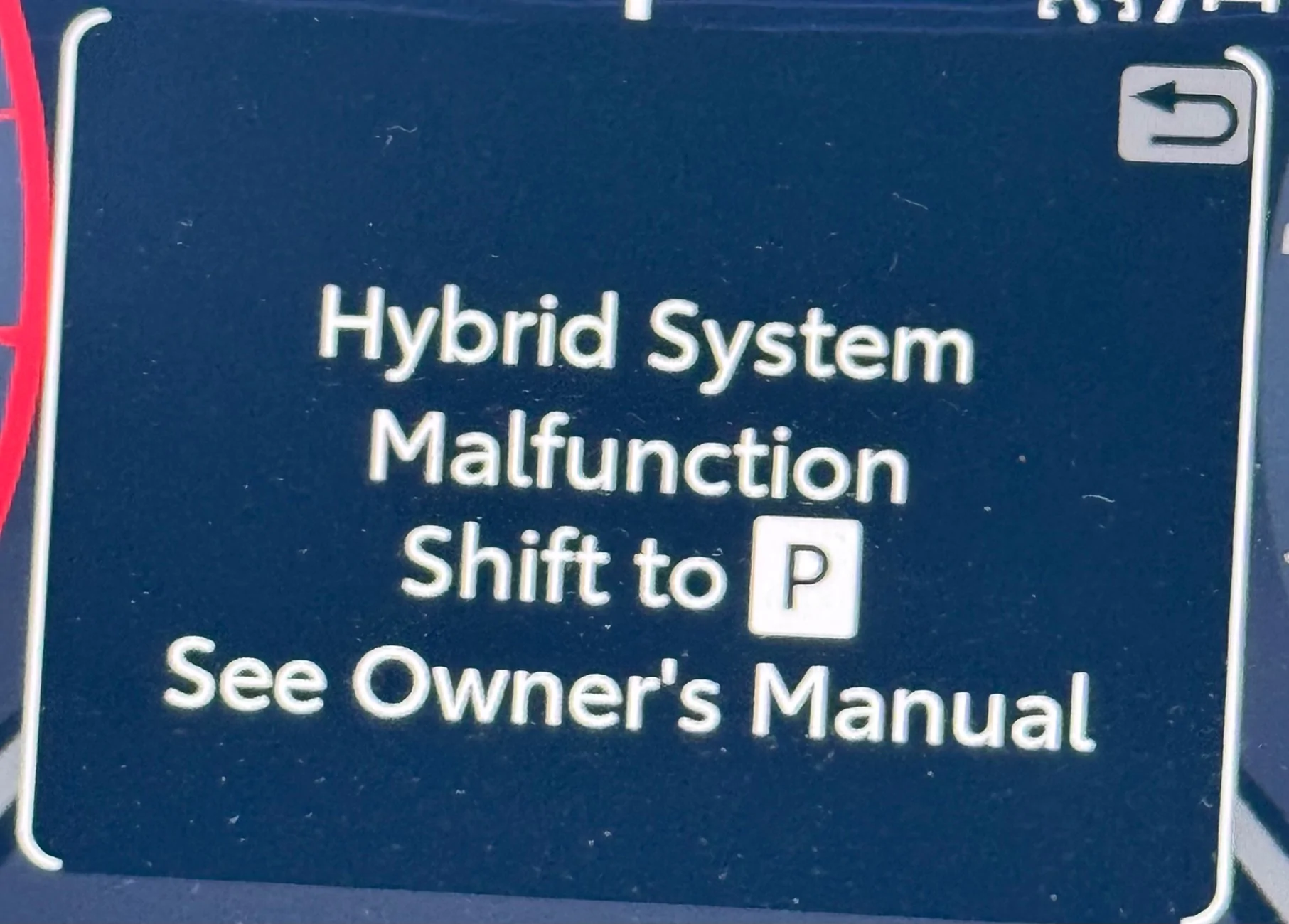

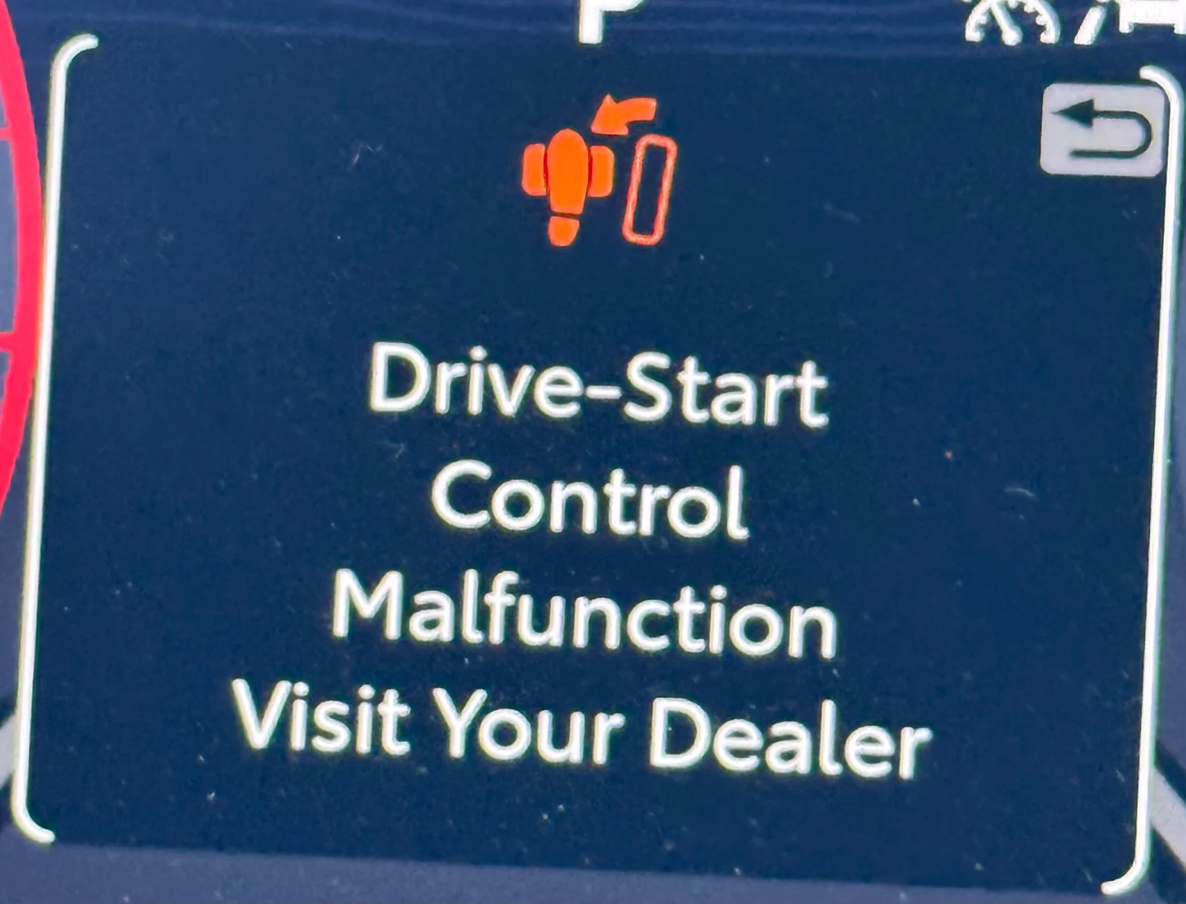

Well this didn’t go well. Following recommendations of disconnecting the 12V battery before wiring lights, and after reconnecting everything the dash threw a fit. 👎 Towed to the stealership for a system reboot.

ToyotaCare covered the tow (unlimited miles), 💵 Diagnostic, 💵 new 12V battery = waiting for the bill and for the truck….

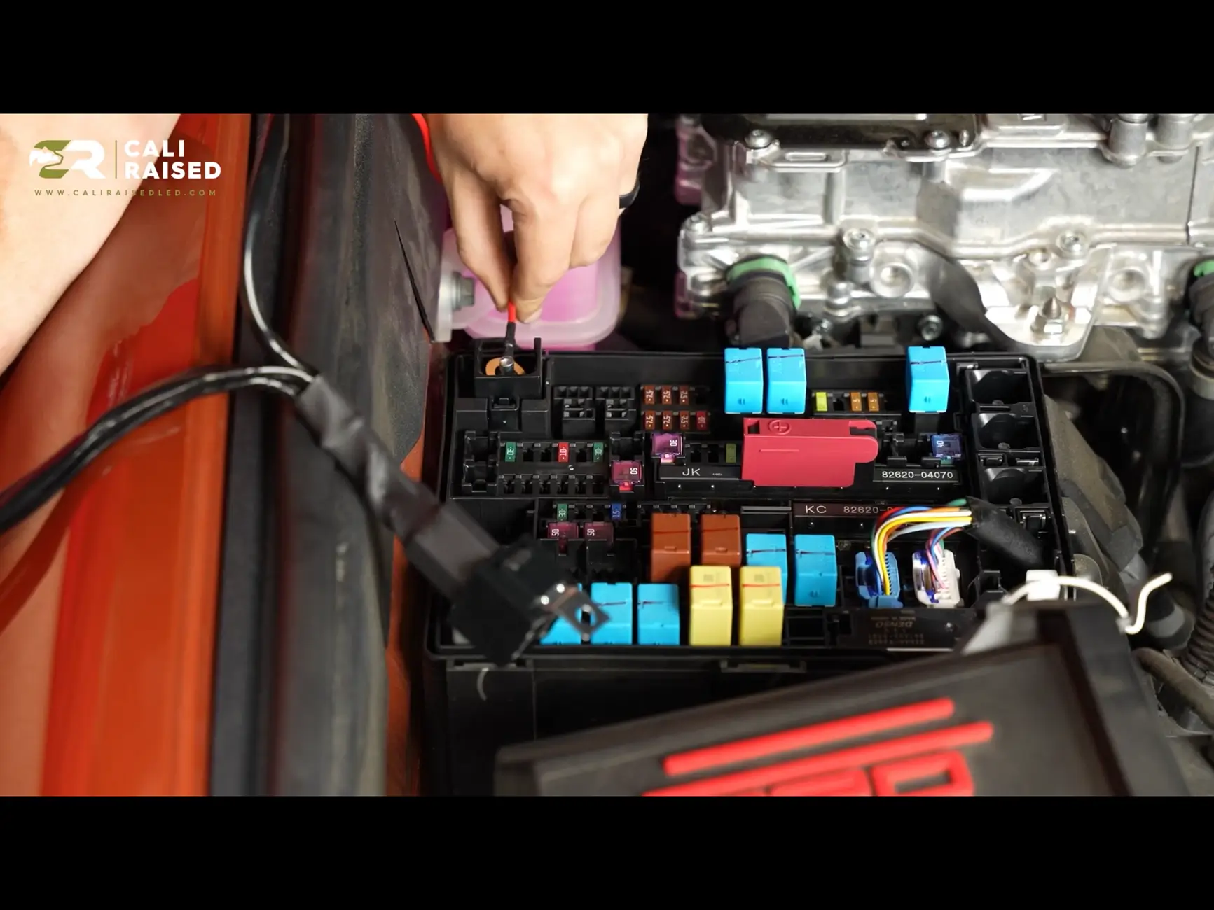

UPDATE: New battery installed and fault codes cleared by Toyota Techs. My Service Advisor made sure it was covered by ToyotaCare and provided a loaner. Did have to pay for a diagnostic.💵🤷‍♂️
The Toyota Technician said DEFINITELY DON’T DO THIS… (CaliRaised YouTube Video on wiring.)
2024 Tacoma Disconnecting 12V Battery on iForceMAX = Fault Codes IMG_0419
He said the electrical systems on the new hybrid Tacomas are very sensitive to any power interruptions .

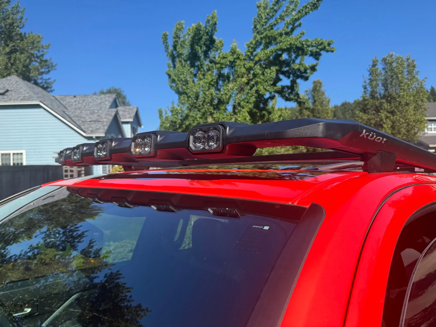

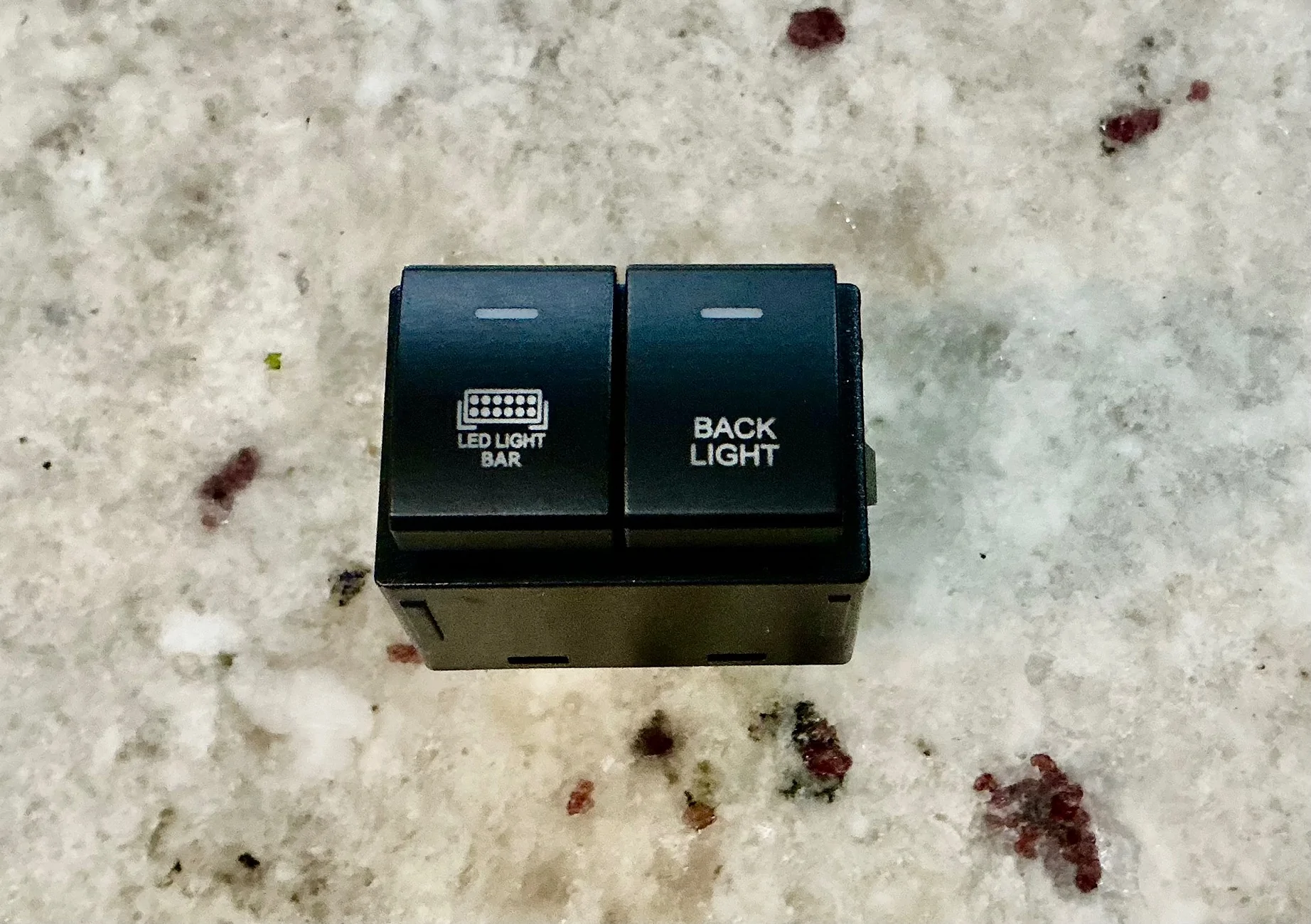

In my set-up I plan on using a rectangular two button switch to operate my Küat DEK.
2024 Tacoma Disconnecting 12V Battery on iForceMAX = Fault Codes IMG_0420
2024 Tacoma Disconnecting 12V Battery on iForceMAX = Fault Codes IMG_4878
I am not using the pre-wired AUX switches because I am reserving them for future lighting options, and I didn’t want to use two AUX switches for the DEK lights (main & back lighting).
So I in the end I don’t know. 🤷‍♂️ It seems like people have successfully installed their own lights on the Hybrids, but after having my Taco in the shop for 5 days I’m hesitant to muck around the electrical system again. All the research I did made everything look plug-n-play. The videos all glossed over actual wiring - and no one mentioned potential issues with the hybrid systems.
If y’all have some advice I am all ears - thanks in advance!🍻
