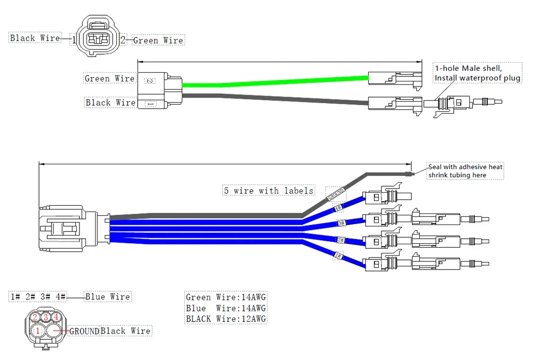

@tacorancher
@SmokyMtnTaco
I can send you guys the first 2 of these when they come in, if you want to take some photos and shoot another demo/install/review video?
I can add it to our Youtube playlist again as well.
This will just replace the "Patch Cable" under the hood with more modularity.

Cool - what does “more modularity” mean?

Correct. The connector that the wires are in is the same from 2024 and 2025 up. The only difference is, some of the newer trucks have 4 switches. The others have 3. If you have 3, the 4th wire is just a dead end. No power, no switch.
That said, I am guessing you can probably add a 4th switch at some point in the future?

Instead of having the wires from the front connector permanently connected to the patch connector to the rear. You can plug any of them to any switch in any order or any of our harnesses.

Ohhh cool - I would do that

Sure thing, I'm willing to try it out!
