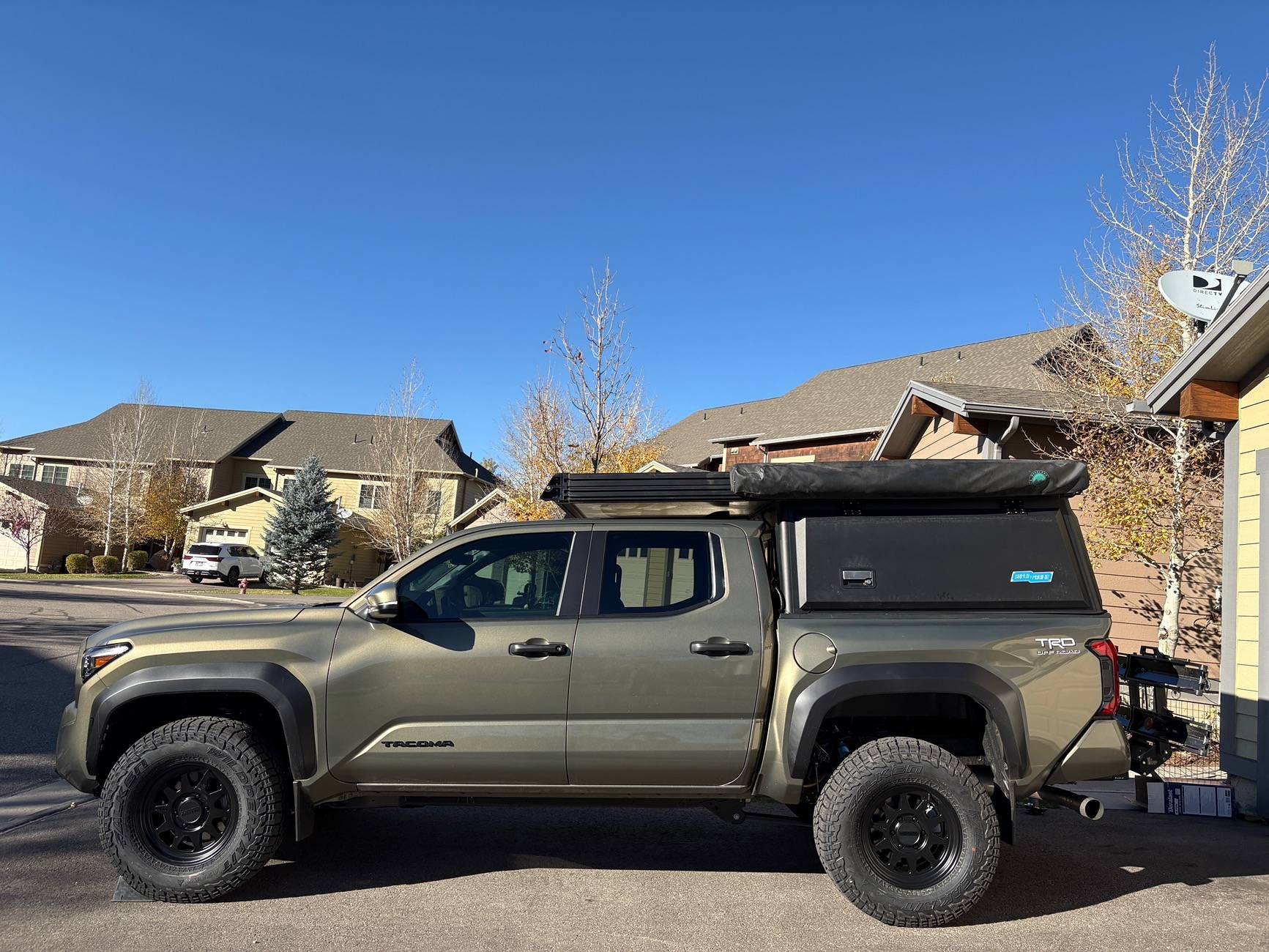

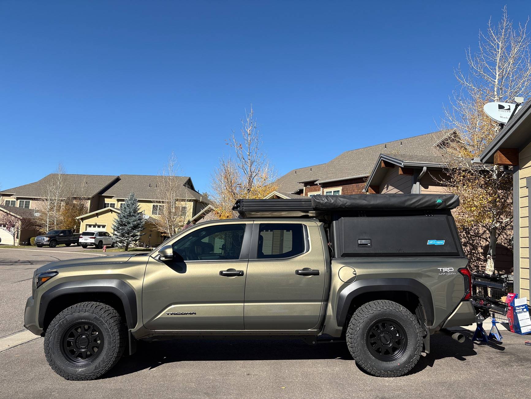

I took a before and after with the 819, hoping they settle a little also, I don’t have any of my camp stuff in the truck so, fingers crossed that will lower it at least an inch. otherwise I’ll have to buy the 817 the ride quality is great though!

How much weight are you carrying?
In that pic I just have the camper (370# ish, 50# of awning, 105# of bike rack). In this pic, I have 260# in the bed. With that and the larger tires, 1.1” taller, I am 1 1/4” above stock height. I was trying to stick w stock suspension in the front as it seems to fit my needs so I think I will need the 817 springs.
Yeah, that's probably right. If you don't want to raise the front then you'll want the shorter springs in back. I've got the Westcott spacers in the front and with ~1,200 lbs in the back end the 819's are perfect. Even with all that weight the backend would be too high if I didn't have the front lifted though.
