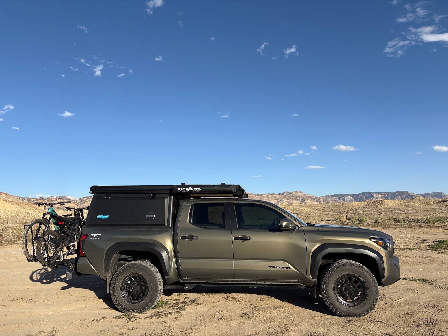

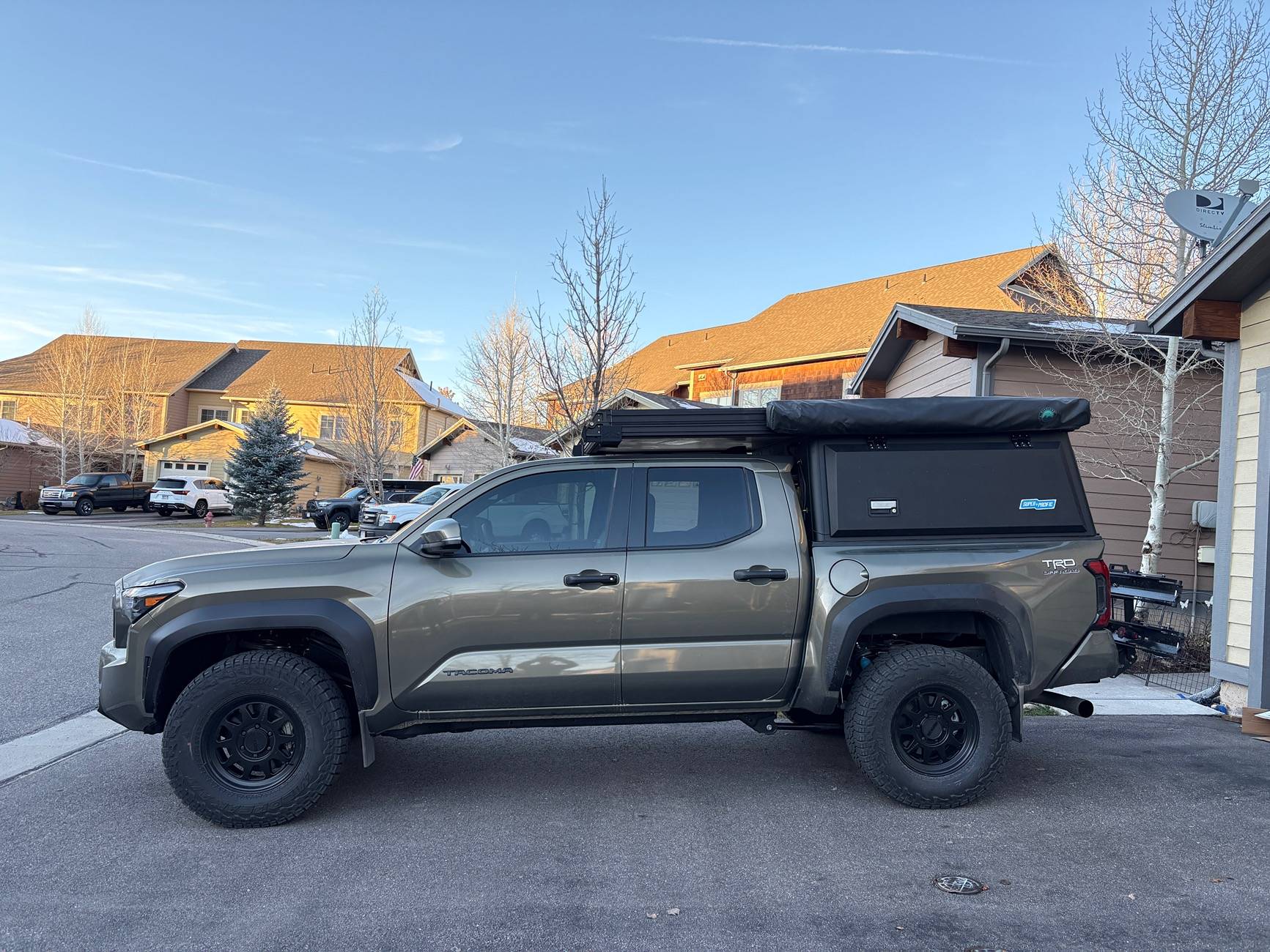

Driveway is with the bed relatively empty and desert shot is near my normal. The 817’s seemed to be the ticket for me.
Looks great!
That looks really good. Is super cool that you were able to get the 817s on it and you are happy with them.
It seems that the following in the pattern:
821s with about 400-600 give about 25 inches between the mid of the tire hub and the start of rear fender...
819 with about 600+ provide about 24 inches between the mid of the tire hub and the start of rear fender...
Could you measure the same? I am wondering how much space you have in there. Also, do you know around how much weight you are carrying....?
Does it handle well... have you bottomed out?

It looks to be at 23 3/4” with the camper, bike rack and a few other things totaling about 500-525lbs and that would be about the same as what is seen in the driveway pic. I will then add 9gal of water and another 50ish lbs of gear

Oh and as for feel, it is great, not too stiff or bouncy really and no bottoming out
Thank you so much for the update. 23 3/4 seems to be right around the sweet spot I think I will be around 600 pounds too.
Did you lift the front?
