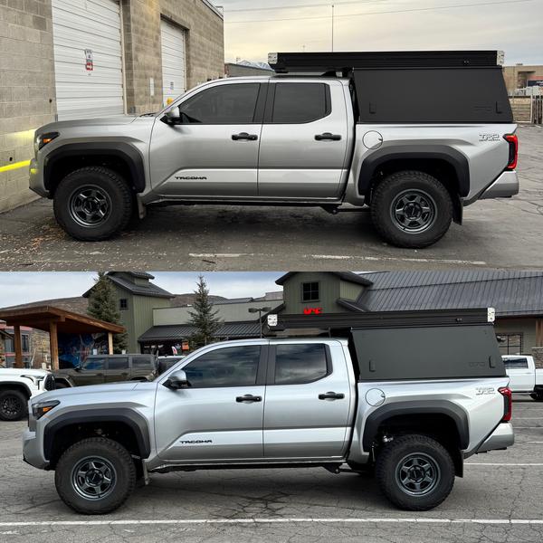

I installed the Falcon 3.2 kit and Dobinson 819v springs with my GFC. About 1.5" of lift front and 3"-ish rear so it maintains a bit of rake and should handle camping/bike rack load ups for the summer really well I think. The ride quality is a massive upgrade over stock, really loving this kit!

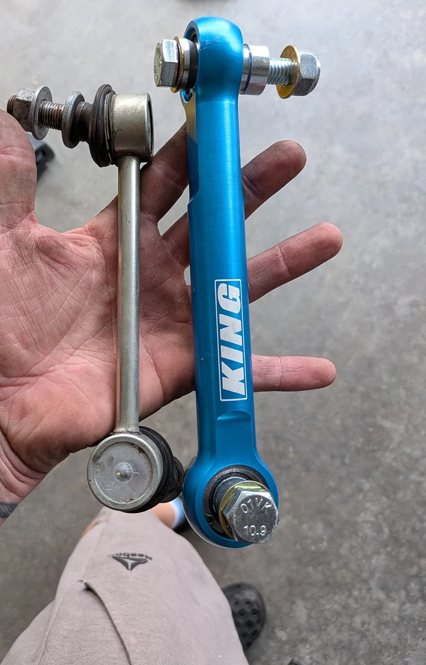

Also a heads up: I got a MUCH smoother ride with extended end links and Bolt On Track Bar Correction Kit. Somewhat inexpensive to get a smooth ride back if you're having any issues there 👌

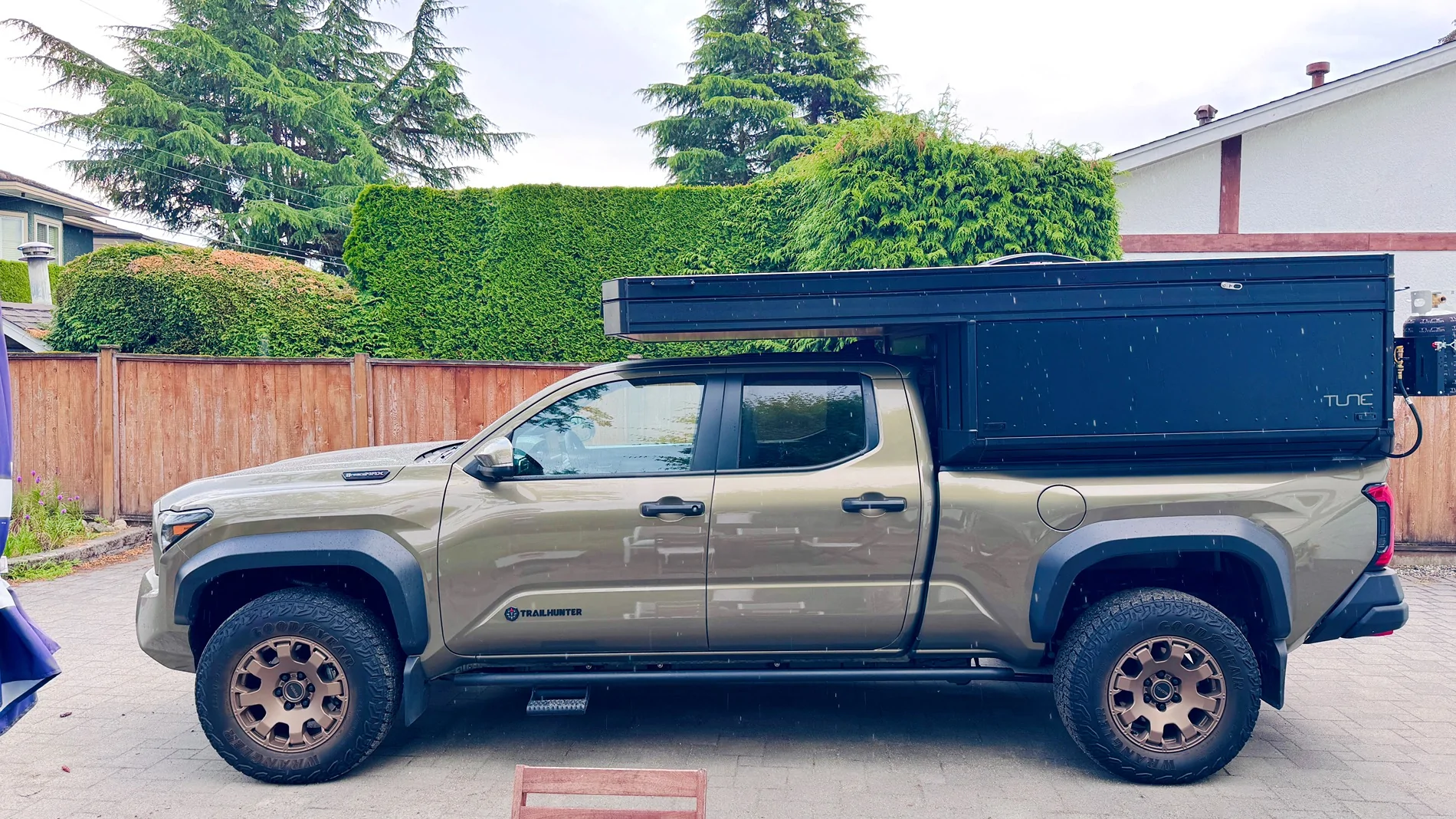

TH with 819v, tune m1 camper. Springs have settled here after a few trip.

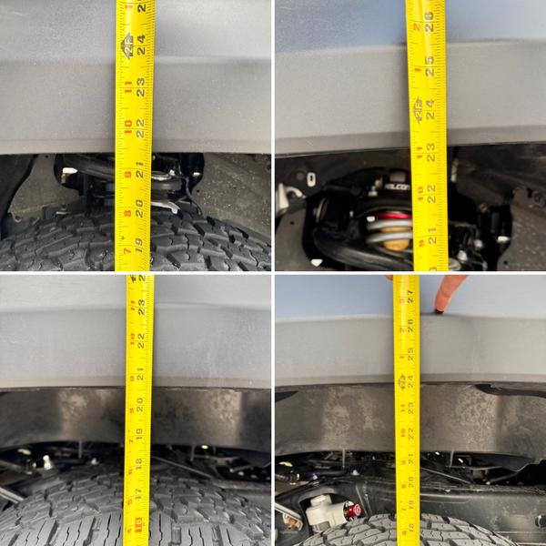

Thanks! Do you have an idea of approximate added weight to the truck? and could you measure center of wheel hub to the fender both front and rear? I have a TH and a Super Pacific build out going on it shortly. Was leaning towards the 819's and getting some real world TH measurements would be great!
Front 22”
Rear 24 7/8”
was gonna go with super pacific but the tune space we couldn’t be happier. Rip MPG
tune says our build is 575lbs, including hest mattress, truma heater and accessories

thanks for the measurements and details. That should be pretty close for me. Hoping for about an inch lower than you with the extra 150-200lbs. I sit at 23.5 in the rear stock.

In that pic I just have the camper (370# ish, 50# of awning, 105# of bike rack). In this pic, I have 260# in the bed. With that and the larger tires, 1.1” taller, I am 1 1/4” above stock height. I was trying to stick w stock suspension in the front as it seems to fit my needs so I think I will need the 817 springs.

FWIW, installed 819's in my trailhunter with a super pacific and some interior buildout. After accounting for removing the bed bar, net added weight is 600 lbs (will be 750 loaded when on the road), my front sits at 22, and rear is at 24.25. Just about perfect, and the ride is great!
