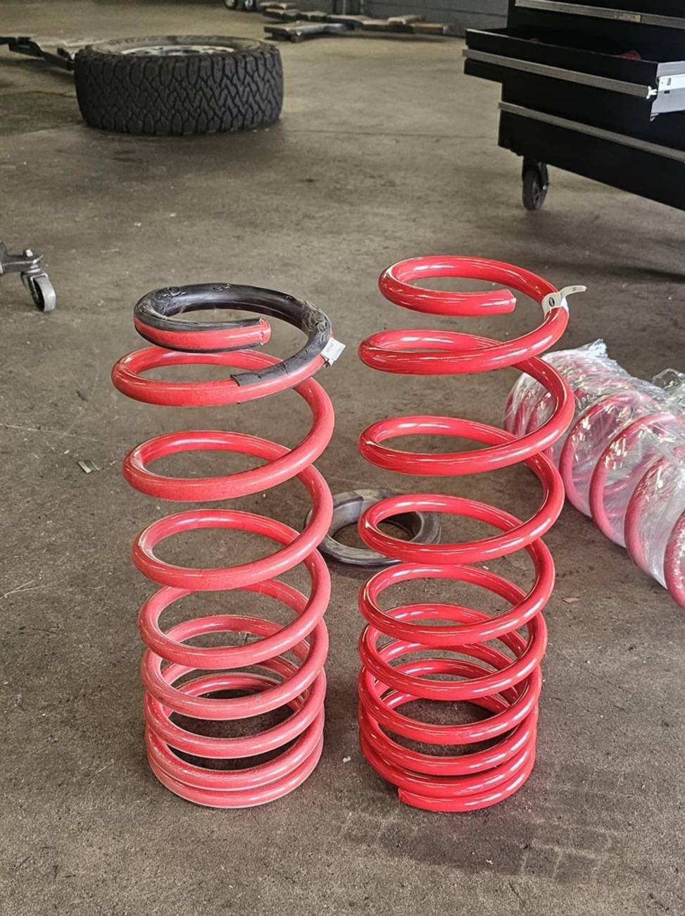

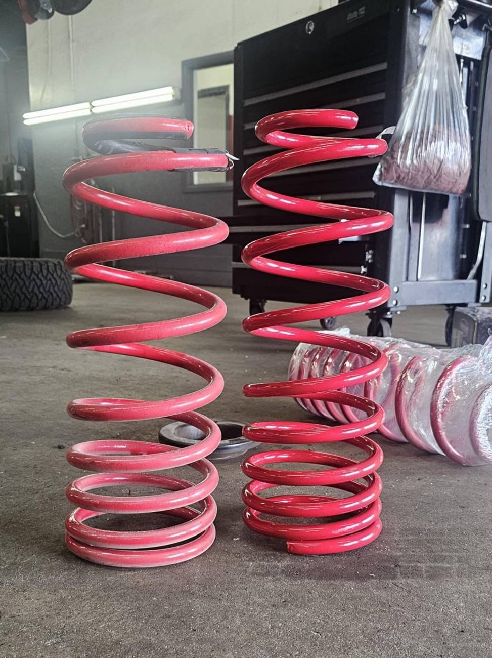

Interestingly, the 819 is 10mm longer free height than the 821.
Since you noticed, because I noticed that the 819 were longer than the 821s and I said ... "wait, is this right?" and I had to double check but it is right. The 819 are longer but the tube that the 821s are made from is thicker. I imagine that this is what helps carry the weight while retaining a similar height/weight ratio across their different SKUs.
