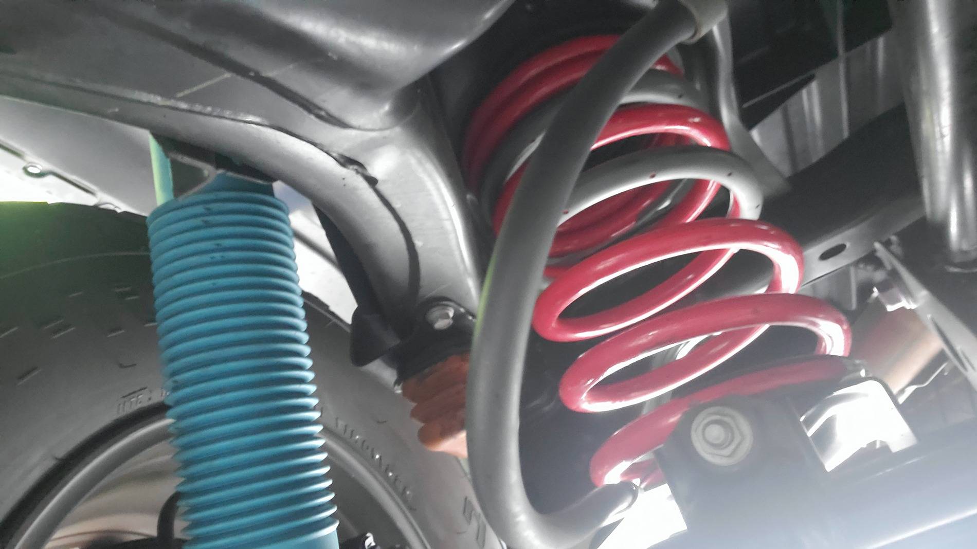

Would you be able to take a pic of the 819s with your 930 lb load to see how much compression travel there is between coils? This would be good data.
Here’s a photo of rear left 819 spring with probably 930-950 lbs (still had some water in the back).

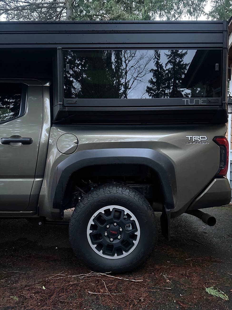

Those tempered glass side panels are pretty nice!
Looks like you still have a decent amount of spring compression. The top coils are for compressed, so your springs are effectively linear instead of progressive now, but looks fine.
I have glass panels all around too.đź‘Ť

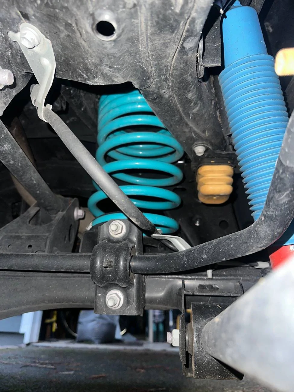

For those interested, here's what the 821s look like in terms of compression with a bit over 1000 lbs load.

Quick update: seems the 821s did settle a bit. I didn't measure with full load after my trip (sorry, was too tired and rushed to get ready for work the next day), but with mostly empty, albeit a bit more stuff than my original measurement of 24.5", I'm now at 24". So another data point. I'll measure again when we're loaded for next trip to compare to my 23.75" prior loaded measurement.
