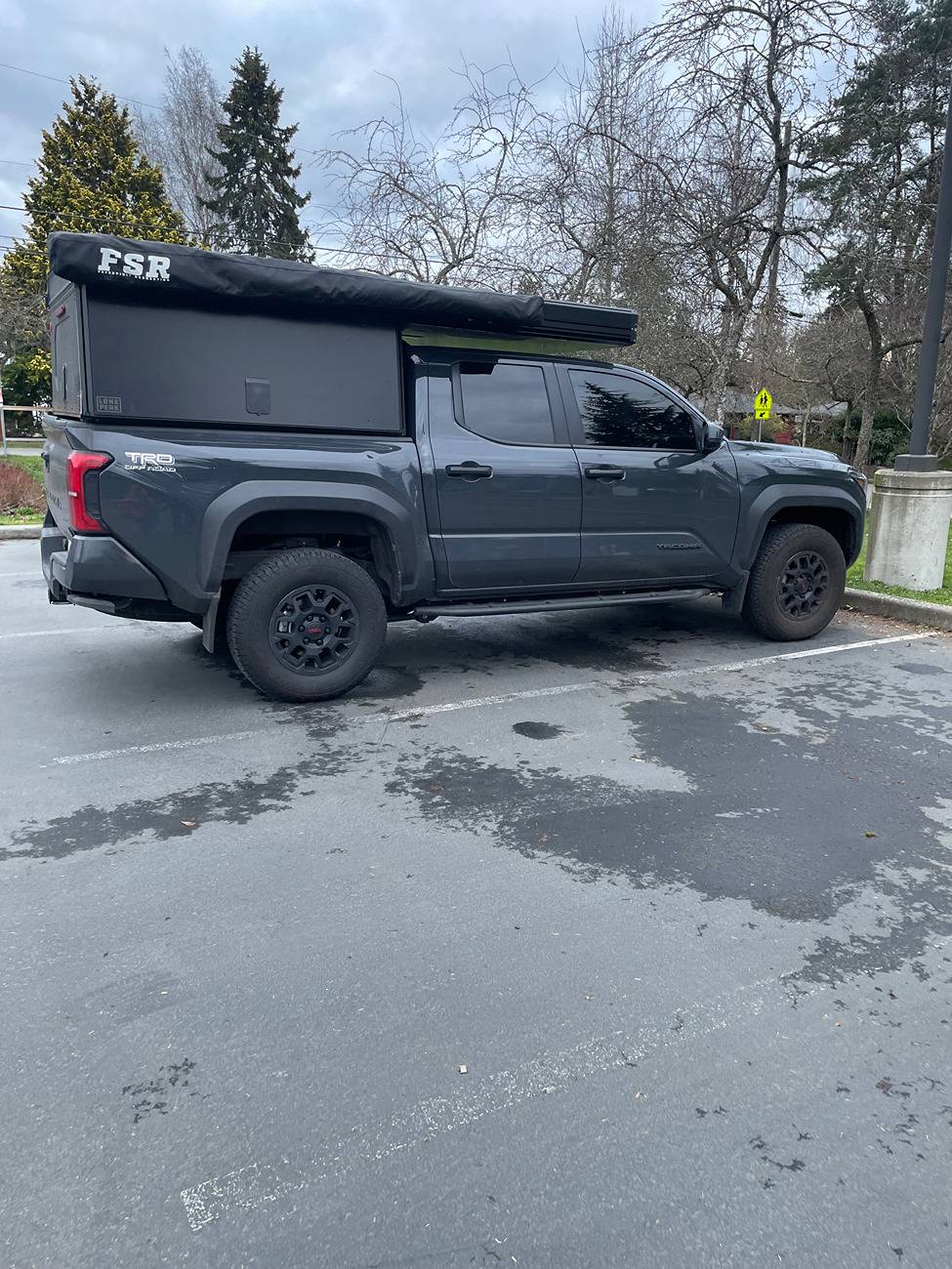

Finally installed my 817's and cannot believe the improvement! Brought it just a hair above stock height with the unloaded camper on and completely eliminated the bounce I was getting. I either forgot how comfortable the truck was before I got my camper or it's even better than before. Was happy with how easy install was too. I just followed the All Dogs Offroad lift install video on YT and all went smoothly.
Looking good. Love the Lone Peak!!!! It is funny how much further forward it sits over the roof with the five foot bed as opposed to where mine sits on the six foot bed.
